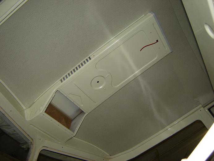

I made new cardboards for the bus front. This I carefully glued in the fabric in the exact place, from the measurements taken from the air vent in the roof. then I slid then in the slide pockets.
I wanted to have a full headliner, not sectioned in the edges of the cardboard. So in the back edge of the cardboard I left he fabric ungled, and screwed the cardboard in place with the panel screws ans washers. The fabric would cover those later on when the headliner would be brought and fitted in the back part of the roof.

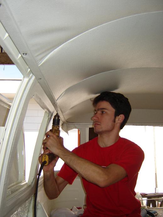

From the pictures John Moxon sent to me, I took the decision to install a wood shim covered in fabric in both sides and rear edge, to hold the headliner ends firmly locked in the bus.

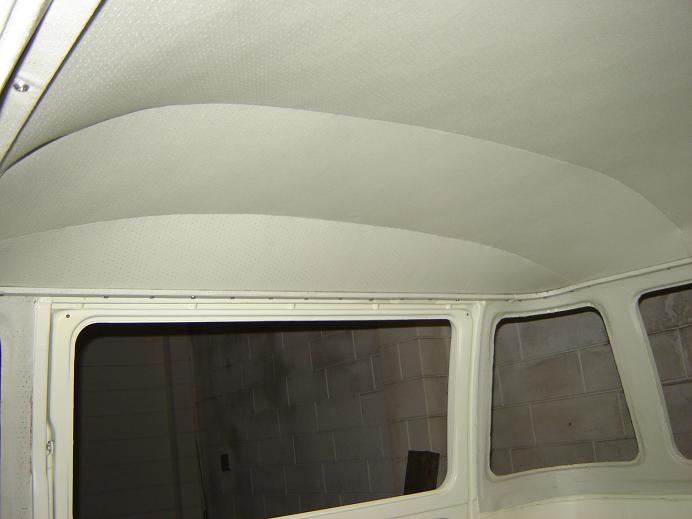

The back pockets sewn in the headliner are very important. They must have the same height as the traversal roof beams from the bus roof, so the headliner installed hides the roof beams and it`s not touching them either, and the headliner doesn`t get pulled up when installing later the courtesy roof lights.The pockets can be made in a lighter cotton/poly fabric, and are reliefed in the rod edges so the edge of the perforated fabric and be pulled down and locked.
When streching the fabric toward the back, It`s very important to make sure the ``pull`` is even in both sides, otherwise the fabric will get crumbled. I firstly locked it firm in the back, then I glued/installed the wood shim in both sides, one by one.

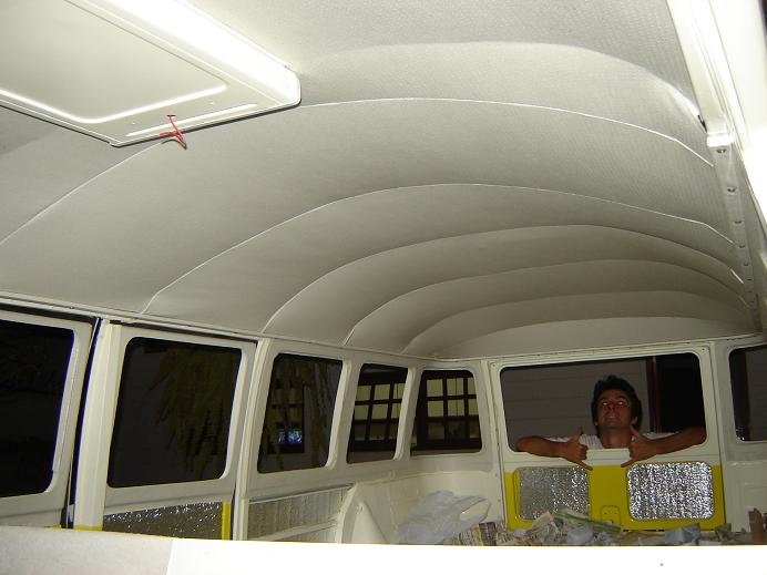

A heatgun is very usefull to remove the small wrinkles, and only the small one can be removed with this. If you got a big wrinkles, or the fabric is loose excessively, you need to stretch it more towards the back/sides.
In this picture is a good example a wrinkle size than can be removed with heating. Do take care to not overheat and burn/ruin the headliner.
That`s it. I`m very happy with the results. Headlining is very tricky, but if you have enough patience you can do it. Took us (me and my brother) about 12 hours to sew, measure, cut and install it. For newbies it wasn`t bad at all. A few other pictures in the Kombi galleries. Enjoy.

First, awesome job detailing the process in the Gallery. Thanks for doing that and creating this thread. It looks like it came out great.
Looking at this photo:
novetti wrote:
I hope you already installed the overhead vent control mechanism, otherwise you just covered up 2 of the screw mounting holes.

Thanks Everett.
The internal deflectors are already screwed in. I'm only missing the middle mechanism, as I also need to buy a new adjust level because the original one is in terrible shape.
