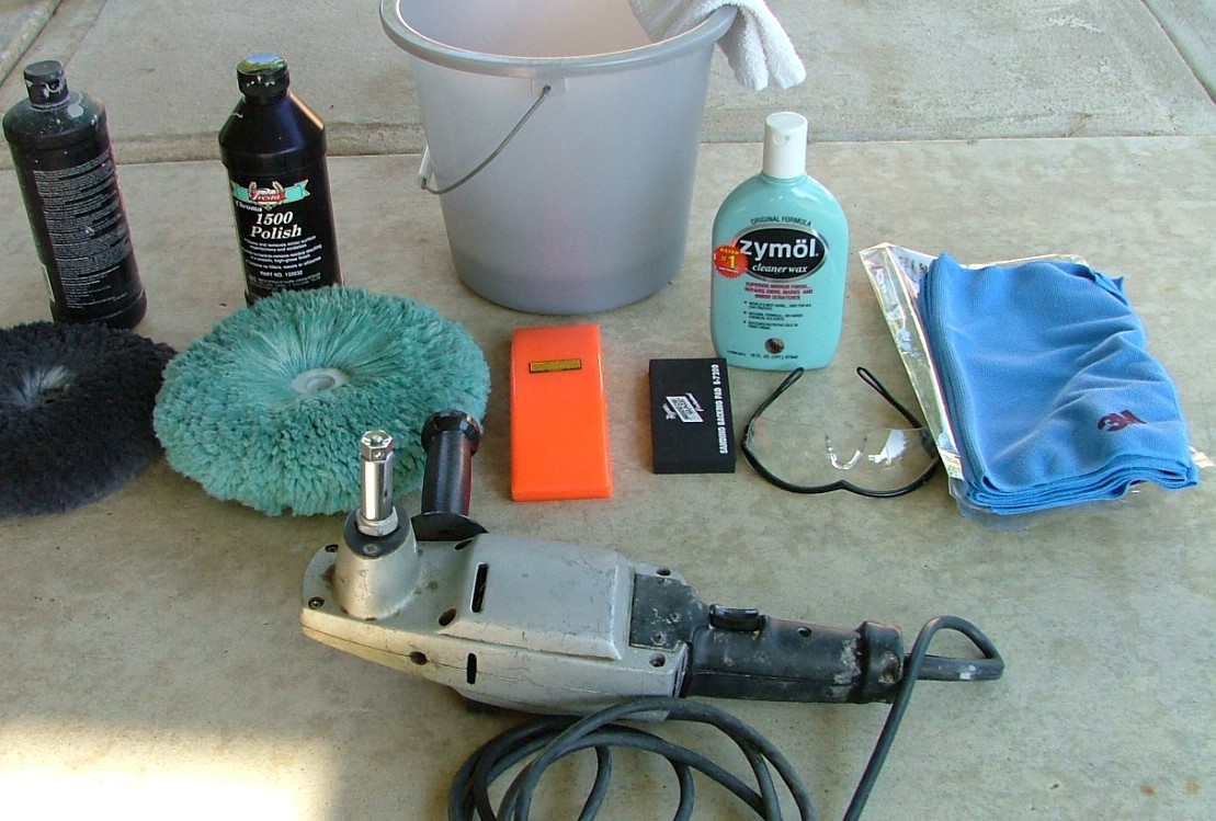

Okay, lets start with some of the tools you will need: From left to right:
Presta compound with black wool pad, Presta 1500 polish with blue pad, a bucket with some clean water in it and a touch of dish soap( the dish soap acts as a lubricant for the sandpaper), a couple of hand blocks one small flexible one for curves and small areas and a larger one for flat areas( note on blocks: make sure that the block face is flat and solid without any small holes because the holes will leave marks in the paint), Zymol polish, safety glasses, microfiber towels and a electric buffer( note on buffers: I use electric ones- preferably adjustable speed that do not run over 2500 rpm, now you can use air operated buffers its all a mater of preferance.

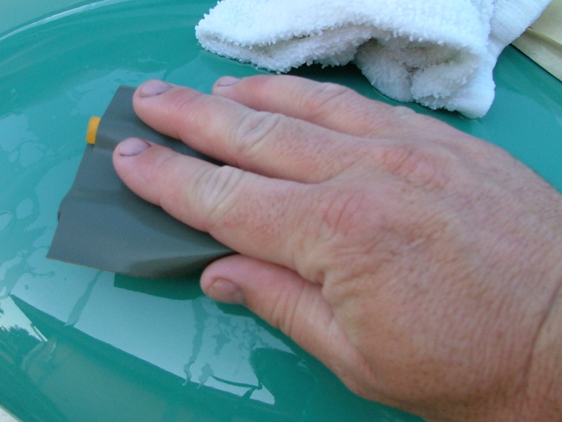

Wash the area first with clean water to avoid trapping dirt in between the sandpaper and the paint and give it a good rinse.
Okay now we are going to talk sandpaper, if the paint has alot of peel or i am flatting out graphics i sometimes start with 600 or 800 wet or dry paper then work my way to the finer grits. If it has small peel i start with 1000 then 1500 and finish in 2500 grit wet or dry grits. Sometimes it takes some work but you will get the hang of it.
Start by soaking the sandpaper in the bucket of soapy water and then wrap the paper around the block and begin sanding keeping in mind that you do not want to sand what you dont want to buff. I started this process with a steady supply of the soapy water as i sanded to keep the particles flowing away. I sanded with 1000 until the area was smooth while looking for the peel as i was drying it off, then continued with 2500 until all the peel is removed( note if you are unsure to how much clear is on your car, it is always better to have a little peel than a burn through, so unless you did it yourself or had a repitable shop do it ............be wary.
Sometimes you will not use the block and use the sandpaper in your hand to get the really curved areas, also using your hand on the final sand of it will will take out some of the little lines that the block put in.

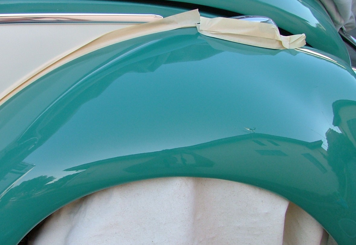

Now as you can see the area that was sanded is completely dull and flat, it is very smooth to the touch......rinse off the residue and dry before using the buffer.

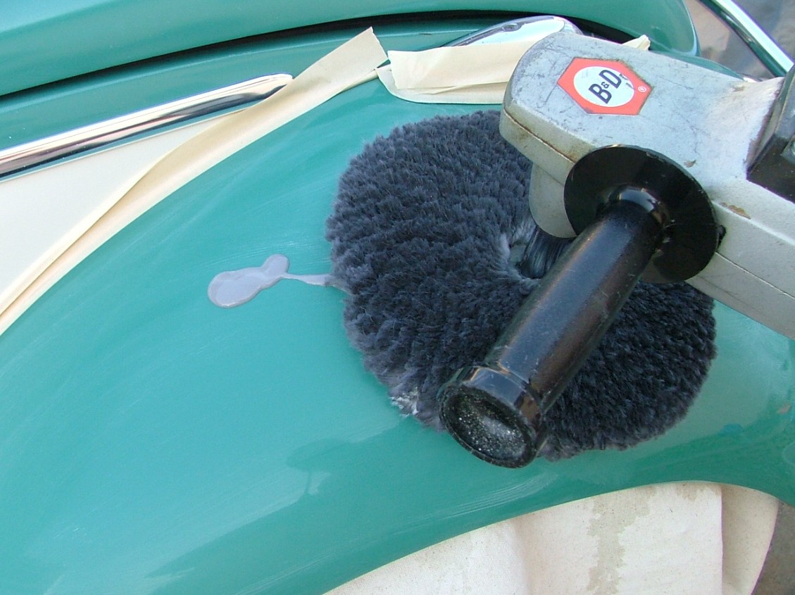

Now it is time to use the buffer. Put on your safety glasses and set your buffer speed to around 1200-1500 rpm and attach your pad (the reason i use the Presta products is because they work great and their compounds and polishes are color coded to the pad..IE black pad black compound, plus they have a quick release feature for their pads which is awesome but 3M and other brands work well too.)
Place a small amount of compound onto the surface and spread around with the pad before pulling the trigger. Start buffer and work small areas at a time using a side to side motion or up and down never stay too long in one spot or you will risk burning the paint. Add compound as needed and buff out until the panel is shiney again, the real trick is to let the compound shine the paint back up before you polish that way you have "less die" back or dull areas.

Finally wash and rinse the panel, look for areas that you may have missed with the polish pad, re-do the areas that need attention and wash again, when you are satisfied with the results polish by hand using a quality polish....NOTE: try not to use wax on fresh paints, they need to cure 90 days plus before any wax is applied, wax will seal the paint and not let it breathe. I am using Zymol wax because this paint is several years old and Zymol is great , i use it on the chrome too. I put the wax on with a clean, soft, damp towel and wipe away with soft microfiber towels that do not scratch............and viola' you done.
