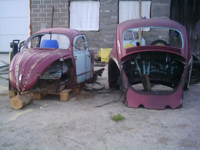

Ok. So, here it goes by request. After I posted some pictures of my latest project in the gallery, I have been getting some requests to give it an own thread... Laughing
The idea for this originally came when me and my son (4 years old) went on a local Soapbox derby in the late May this spring...
The first question my son asked me was:
Daddy, why doesn't I have a car like that?? Confused Embarassed
And to top it off a few of my work collegues who hade built their traditional soapbox carts challenged me that I would have a beetle there next year... As I'm easy on taking such a challenge and I happened to have a complete -74 standard body sitting behind the shed I thought that it would just suit as the donor for the complete project... Very Happy
I mean what else is a such a new body worth using for than scrapmetal?? Wink
Here is the donorcar before butchering:(My wife to the right and my kid on the trailer)
This picture was taken about the 1st of June this year...

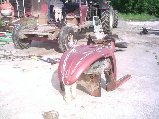

The first cuts on the fronthood:
Here it is back in one piece. Shortened 15" and narrowed 18"...

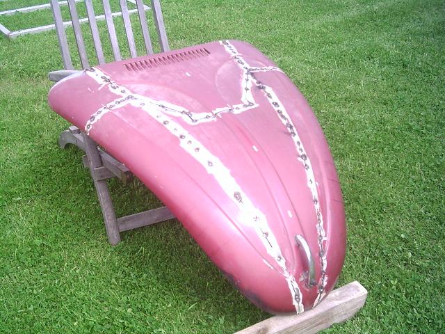

Frontcowl narrowed, still waiting for a 6.5 inch sectioning...

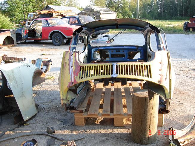

Some progess. Worked on the rearquarterwindows and rear vent.
Tomorrow I hopefully will get the rear window and the roof finished.

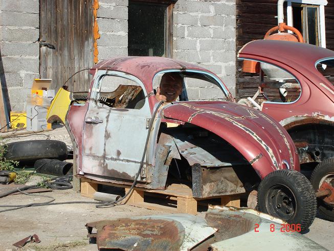

Maybe this shows the size some too? Wink
I'm just 5.64 feet tall... Smile
