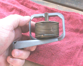

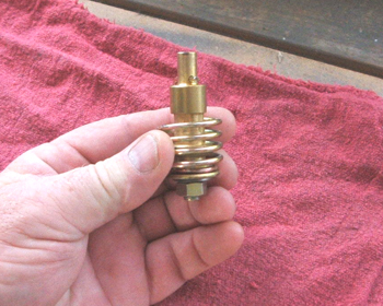

Thermostat Bracket Modification To Accept New Style Thermostat.
Coiled or bellow style thermostats are getting hard to find and pricy. VW produces a new type / style thermostat at this time. The problem with the new style thermostat is the bracket it requires to mount on the engine block. It is nearly impossible to find! Go figure!
Pictured below is how I modified the old style thermostat bracket to accept the new style thermostat. Tested and works fine.
Tools Needed:
Jigsaw with fine tooth metal cutting blade
Use of grinder
7/64 Metal bit
Total Time = 1 hour, start to painted finish.
T1 Thermostat Bracket
T1 Thermostat Bracket With Termostat Mounted
Bottom, New Style Thermostat - Notice Lock Pin On Bottom
Using 7/64 or 1/8 Bit, Drill Hole Between "Button Weld" And Mounting Hole
Cut Away Existing "Hoop" And Angle Support So New Style Thermostat Fits Flat On Bracket.
Another View Of Cut.
Finished Bracket With New Style Thermostat Mounted. Lock Pin On Thermostat Fits Into 7/64 Hole And Provides For Some Movement For Rod Alignment.

Kris - How has this new thermo worked for you?
I have heard good and bad feedback in the past.
I pressume most of the bad was lack of a way to mount the new style in the old holder. Question
Very nice work! Wink

Greg:
Asjusting the new system (on the block) is not much different than the bellow ones. I had to learn the top end of flap opening by trial and error (just like a bellow one)
Functions fine. Two 100 mile runs to test it. One "hot" day, the other, this AM, when it was cooler. After final adjustment on block, I can't really tell any difference between the old and new style (function).
Hope this helps.

VW Number on new thermostat is 111 119 159 A, which is the same part number as the original thermostat. With that in mind, the new style thermostati shares the same temperature range as the original bellow type.
I purchsed two of the new style thermostats for $ 15.00 each. I have seen them as low as $ 7.50, but in catalogs, they can go for $ 40-50. There is one on SAMBA now for $ 50.00. People just don't know much about them, and with the mounting bracket issue, people are not purchasing them (I'm only guessing on this)
I used the same rod that attached to my bellow thermostat. Worked fine!
