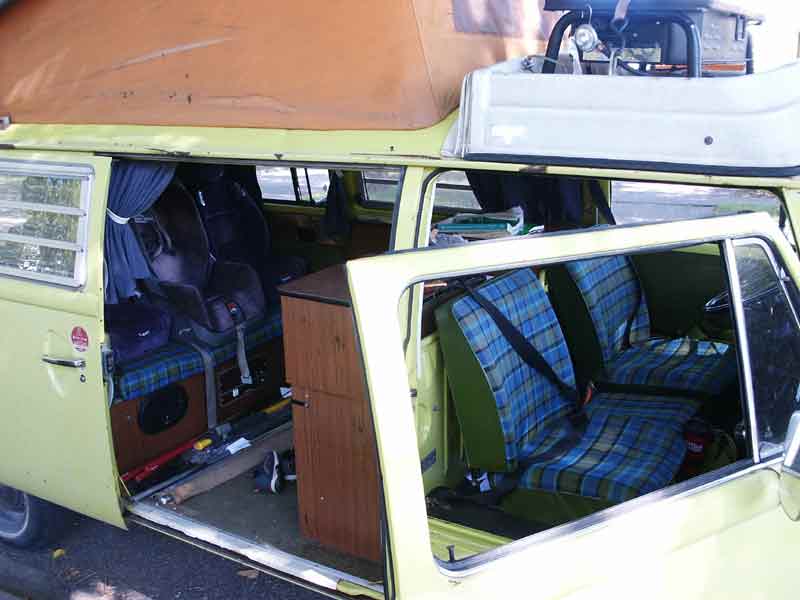

OK, got some pics for you, both of our 85 weekender, and 74 westy.
Here's what a weekender looks like inside, lots of room, and could sleep all five as is, 2 below three up top. As noted, you can get or make a child's cot for these too.
Here's the inside of the 74, with 3 kids seats

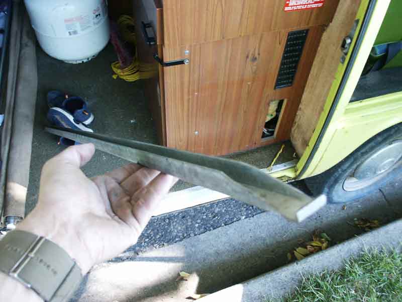

Here's the child's cot, with and with out kid, and one of the brackets, and one of the poles (the two poles are slightly different lengths.

jeremysmithatshawdotca~ cool, you took photos of the cot brackets. I have those, but not the cot. Looks good. Do you replace the headrests when the cot is not in place?

It wouldn't bee too hard to make cot poles if one had access to shears and a press brake. They could also be made from square tubing, or even eleictrical conduit. I have two front poles, and no rear pole, so I made the rear one out of 2 sizes of electrical conduit. It does the job alright, though I think square tube would be better.
