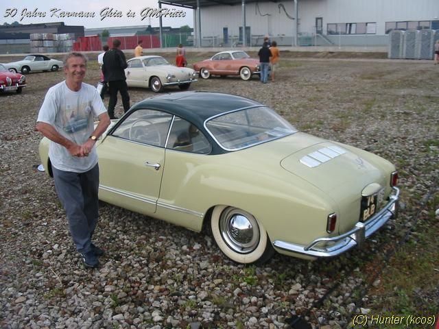

Hi 72Coupe,

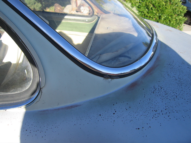

I can't give you an *authoritative* answer, but I've been looking into this myself and will share my observations. I've noticed the variations you describe as well. Recently I had a chance to photograph an original 1959 coupe painted Aerosilber and Grauweiss. Here are some of those photos:
Details of the 'A' Pillar.
Detail of the 'C' pillar. Notice here how the Grauweiss does not follow the body line but is faded up into the window trim. No "small line of color" beneath the back window here.
Of course it is possible that there was variation over time... or even that it wasn't precise at all. Retrowagen has posted a few details of how painting was done at Karmann and might have some enlightening comments.
Probably the best thing to do is look at some orignal cars produced around the time of the car you're working on. A great source of pictures of original early cars is the CD set available from Broadacus. I don't know if he has a similar set for later Karmann Ghias or not.

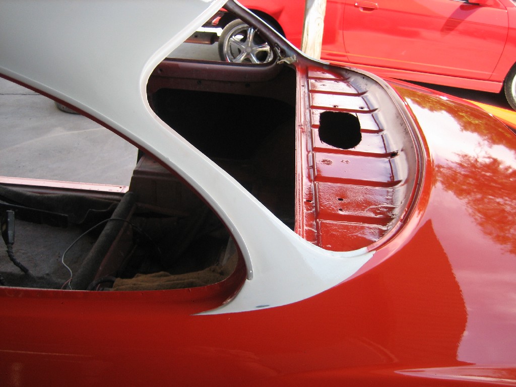

This is why I am confused... I see cars painted like the red one above, then I see mockup pics in the sales literature like

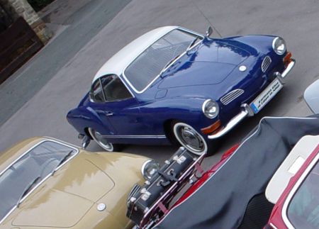

Then there is this..
After seeing this one, I think the pillars are going to be roof color.

Karmann was pretty consistent with its masking of two-tone roofs of Coupes. The excellent and telling photos of the Aerosilver Coupe that Dan posted above are spot-on, especially in regards to the rear (aka "C") pillar. Indeed, the delineation is indeed a little above the body/roof crease, and it tapers up and into the compound radii of the rear window aperture. Brilliant or Pelican Red Coupes with black roofs are a little deceiving: the black window seal appears to be a continuation of the black painting, but Karmann painters masked the roof so that the areas beneath front and rear windows would not need tape and paint - those were always body color. It's one of those details that, when studied closely, makes you wonder why they didn't just mask it precisely on the crease, but it probably gives a slightly more favorable result to mask it on the "flat" just above the crease (thus taking the pressure off the body stamp die-makers for total perfection).
The only inconsistency I've ever noted in the masking of these pillars has to do with the front (aka "A") pillars. Making a survey of original paint cars, one will spot that some of these have a more horizontal delineation than do others. Do your best on this, and try to approximate a smooth sweep, bringing it around the gutter and into the interior.
Painting the body (lower) color up the A- and/or B-pillars really detracts from the elegant looks of the factory two-tone paint schemes. That Blue/White Coupe pictured above was definitely a repaint. This kind of paint scheme looks fine on an early Squareback or an earlier Deluxe Baywindow, but is just wrong on a KG.
Oh, and just for clarity's sake: Karmann always painted the main body color first, via immersion in vats of paint, and then later masked and sprayed the roof color, if it was a two-tone color scheme.

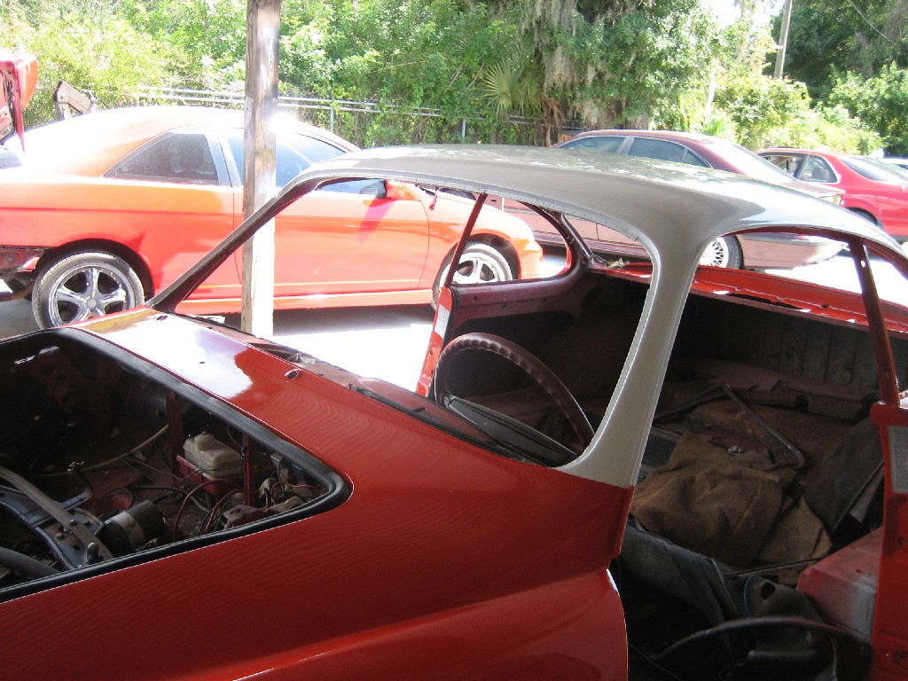

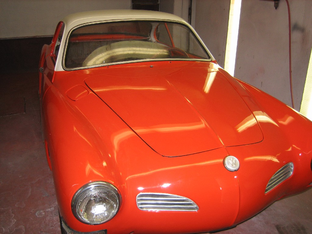

Thanks to everyone for their input, here are 2 shots of the final decision.
Front comes perfectly even with the top of the door with a slight curve:
and Back prior to buffing, tried to follow the arc you guys gave me

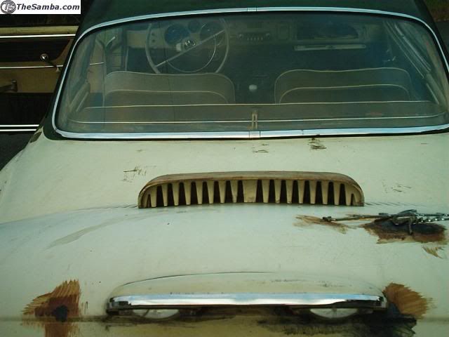

OK here's a couple of pictures showing the rear:
This is the og paint on The Edmonson Ghia.
...and this on the well documented Ghia formally owned by John Figg:
