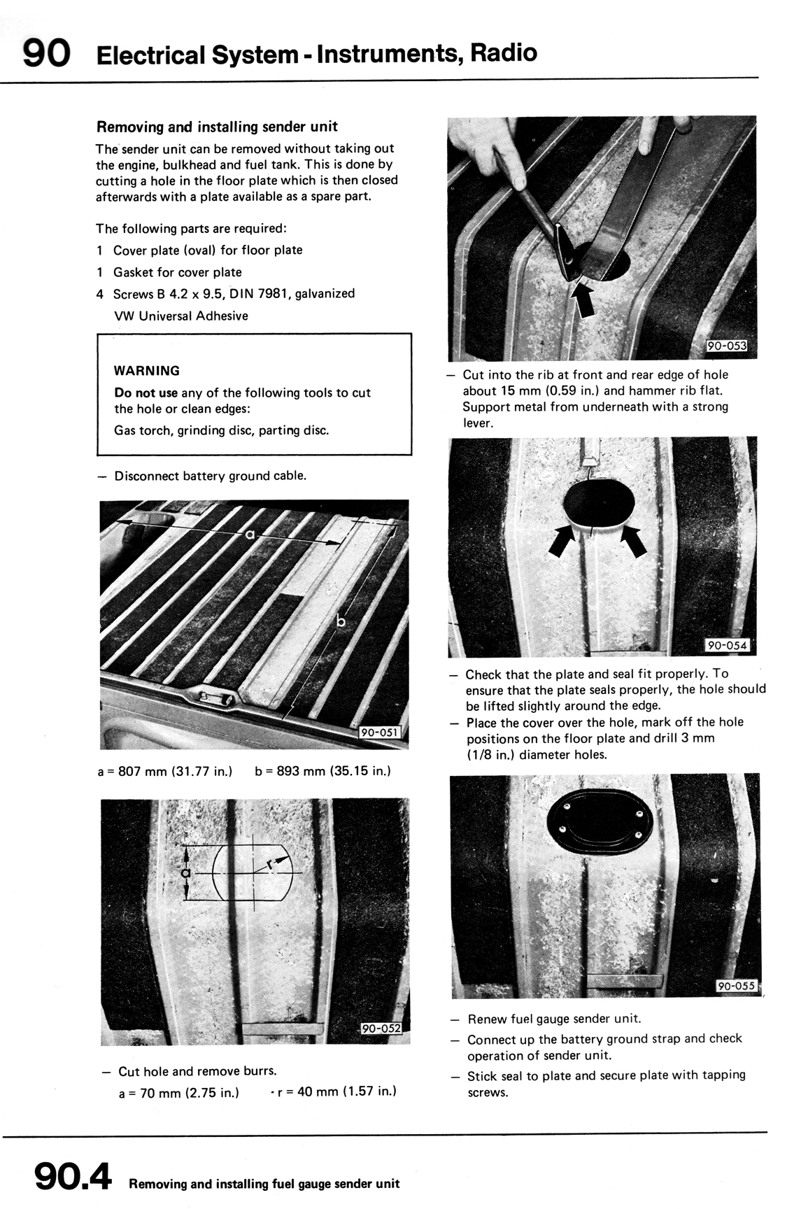

PostPosted: Wed Nov 08, 2006 5:28 pm    Post subject: Re: Gas gauge is barely working... Reply with quote
blitzkrieg59 wrote:
The gas gauge on my 77 works very half assedly. It registers a full tank when it's full, but within 30 miles or so it reads 1/2 tank, and within 150 miles or so, it registers empty. Any ideas on what may cause this and how to fix it?
99% of the time this is the sender in the tank. it is easily fixed with a new sender.
here is a scan of the VW manual with instructions on how to access the sender without removing the tank. i made the scan big so you can print it clearly.

PostPosted: Wed Nov 08, 2006 5:29 pm    Post subject: Tank Sending Unit Reply with quote
We used to give the customer the option of pulling the tank when i was at the dealer.$$$$$$ or cut the hole. approx.21 inches from the right side.and 4 inches from the access cover.with a 6 inch hole saw. then use a round cover that came from a 411 gas heater spark plug opening. it was a clean job. the cover is similar to the cover where the ecm is located. if you use a jig saw to do this put some duct tape down and you will not scratch the paint.

PostPosted: Wed Nov 08, 2006 7:37 pm    Post subject: Reply with quote
Thanks a lot!!
Can the sender be fixed; cleaned, adjusted?? Is there any danger of drilling into the tank? How much space is between the floor and the tank? Can I use my cutting torch to cut the hole? Laughing Gus

PostPosted: Thu Nov 09, 2006 8:01 am    Post subject: Reply with quote
GusC2it wrote:
Thanks a lot!!
sender cannot be fixed unless you could find the exact same type of wire used for the windings and re-wind it. if the sender was NLA that might make sense, but the sender is available. make sure to get a VDO sender, there are some mexican ones in the market and they don't fit.
http://germansupply.com/xcart/customer/product.php?productid=16918
oh, and read the instructions on the scan. it says clearly not to use a cutting torch.

PostPosted: Wed Nov 15, 2006 10:51 pm    Post subject: Reply with quote
Lol....that a nice clean small hole......my PO chopped out like a 6X6 square and then to close it back up he/she just went at it with some ghetto-ass sealing putty....
I need to open it back up and reinstall it with some hinges....make access real easy though (can damn near fit my head in it)
