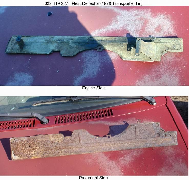

I picked this one up a few weeks ago, out of the three located, one was on not rusted beyond repair.
It's now headed to the powdercoater for long life preservation.

Those look pretty rough (at least from the the pictures). I would consider fabricating a "new" one, unless you are a purist. Smile
1972 Westy ("Bubbles") - Pastel White - 1700(1974 MT) - Dual Solex

I know this is an old thread, but I just pulled this exhaust heat deflector off of my 74. I wanted to add some more pics of the heat deflector since there doesn't usually seem to be a lot of talk about this part. I thought mine was in bad condition until I saw some of these in this post. Maybe mine's not so bad after all. Guess, I just need to get to work stripping it down and then get it powdercoated like Karl did.
Ground side:
Engine side:
Too bad no one makes these since I would think that they would do wonders for preventing the searing heat from the exhaust from rising up to the fan just above it. I know the engine seal is supposed to prevent most of that, but this thing is pretty stout!
