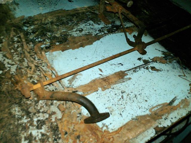

Did they (Autotechnik KG) make a kit for the 40HP motors? I did a search and found some nice threads on the Autotechnik kits but looking through the pictures on the 36HP motors, mine looks little different. The center section on mine holds the fuel filter and it seams to have used nylon braid rubber hose instead of the metal lines. The metal line that usually runs from the top of the pump into the filter, is not there on mine, it seems to be a hose that goes into it from the side rather then the bottom. Also the manifolds look slightly different. Mine is without heat risers and the linkage mount directly to the manifolds. I don't have the carbs but the bolt distance seems to fit a 28PICT or 30PICT. Anybody know what belongs on there? I'll post some pictures later. Any info would be appreciated...

Ok I got some pictures of the parts.
Obviously it is Autotechnik...
The manifold detail, looks like some-one strarted to smooth out the rough casting or maybe it came like that.
Notice the location of the filter...
another view of the bracket and filter.
This is how the bracket sits on a motor
