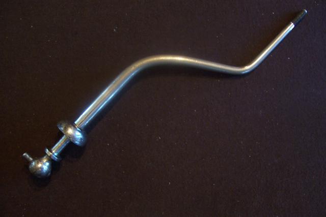

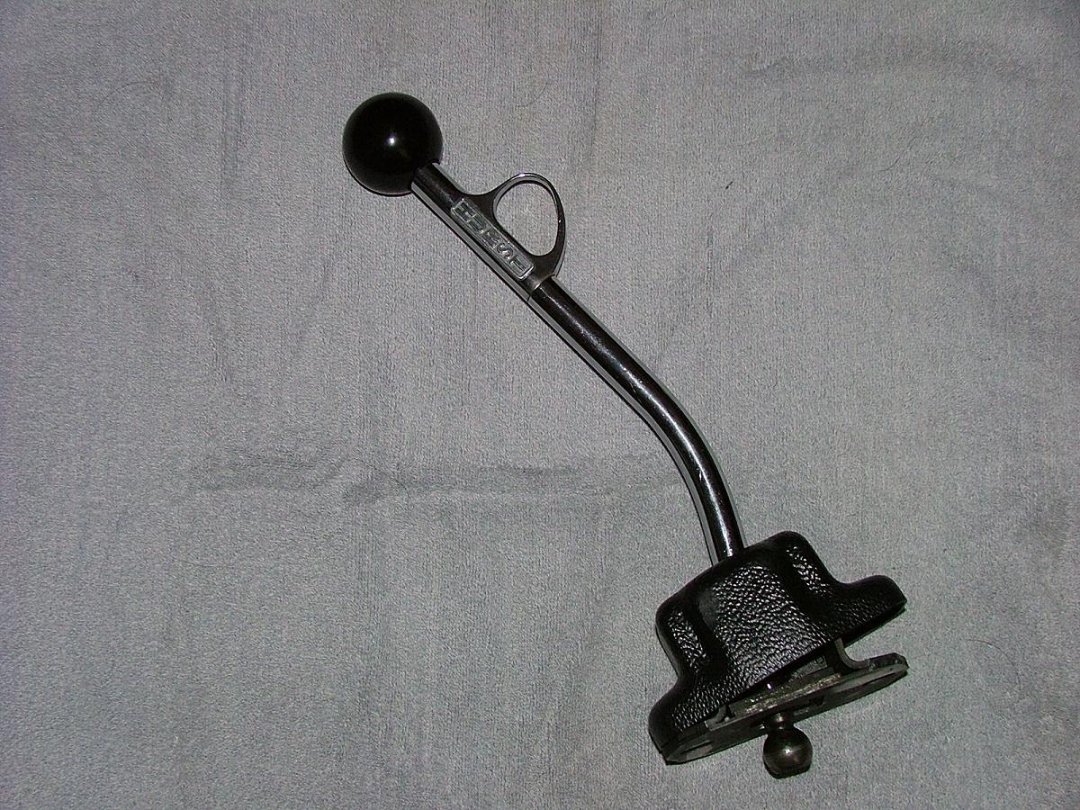

No balls? What do you call the little thing on the bottom end of these shifters?
Here's a stock shifter; harder to see the ba..., er, whatchacallit, inside the spring, but it's there:

PostPosted: Thu Feb 15, 2007 4:21 pm    Post subject: Reply with quote
The spherical things on the bottoms of those shifters NEVER wear out, they don't need to be checked.
KTPhil Premium Member
Joined: April 06, 2006
Posts: 36223
Location: Conejo Valley, CA
KTPhil is offline
PostPosted: Thu Feb 15, 2007 4:35 pm    Post subject: Reply with quote
I have seen some slop in them, probably due to wear on the socket rather than the ball, and even more funky shifting then the pin has fallen out. It's worth checking.
So they aren't "balls," they are "spherical things?" I see.
