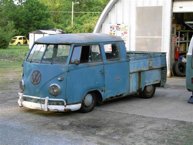

Ok, I have spent hours going over lowering threads and now armed
with the concepts and lingo I can't find pictures of the finished look
and information all in one thread.
I am in the planning stages of lowering my bus and would like to see
what your bus looks like and specifications on your mods.
Please post a side or angled picture of your lowered bus and specs:
-Tire make and size.
-Wheel make, size or offset.
-Spindle drop, beam narrowed dimensions. Who's?
-Strait axle, spring plate mods. Who's?
-Tubbed, cut tortion, IRS, etc..
-Raised box, tie rod flip.
-Brakes, shocks.
-If I ever do this again I would have...........
1965 21-Deluxe-SWR/BG "Sonora"
1973 Type-181 Thing "Velma"
www.aircooledmissouri.com
