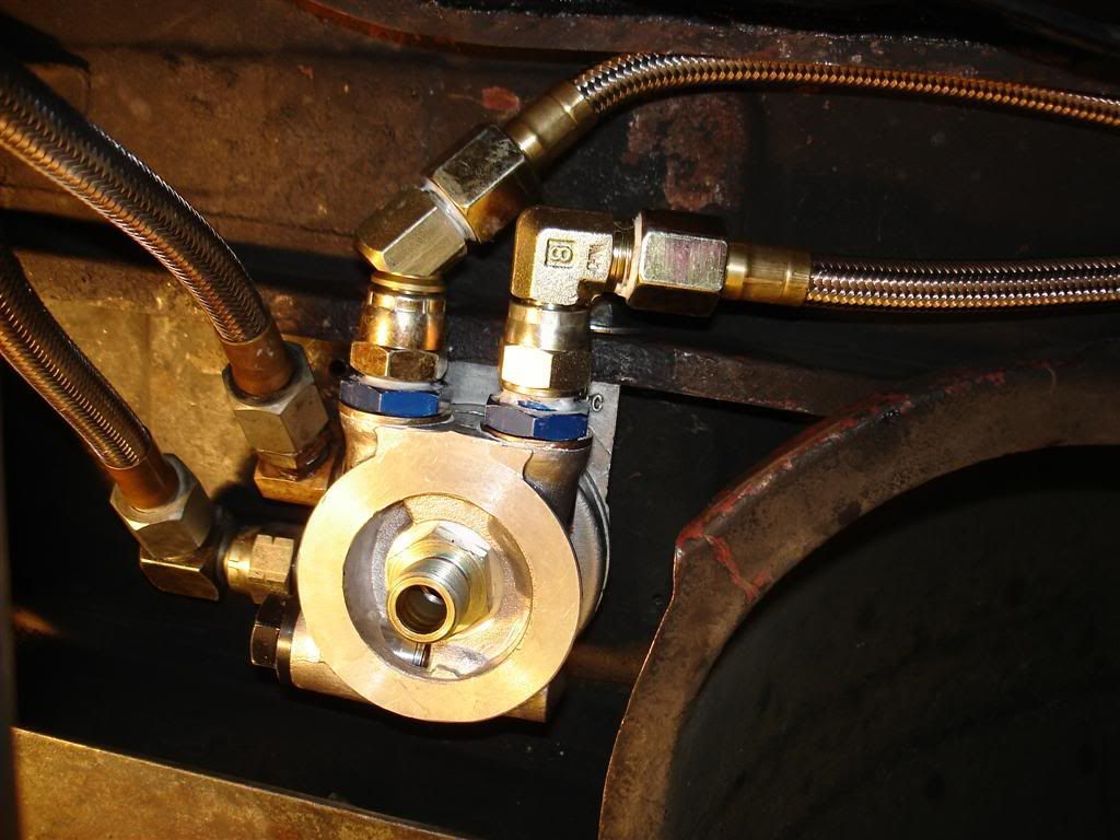

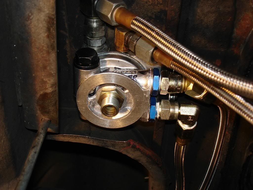

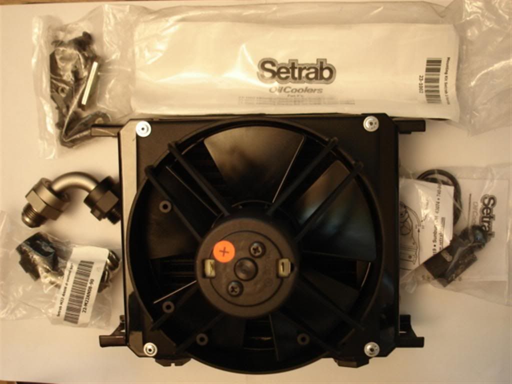

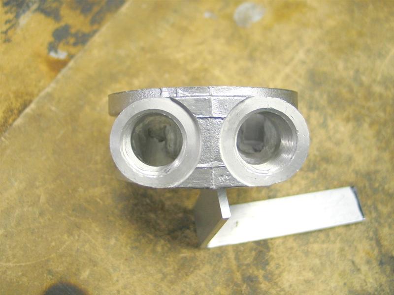

I use one of the sandwich thermostat adaptors along with a Setbab
single fan cooler. I mounted the cooler in the area in front of the axle
and to the left of the tranny. I put the thermostat fan switch (180 deg)
on the outlet of the cooler, I figured if the oil is still over 180 when it
come out of the cooler I should have the fan running. Beware that
even the made in the USA sandwich adaptor needs to be cleaned up
because it was very restrictive. My 2332 runs nice and cool and the
fan only comes on once in a while. Here are a couple of pictures of
the sandwich adaptor before and after.

PostPosted: Thu Apr 19, 2007 8:23 pm    Post subject: Reply with quote
Yeah those and even the filter adapters need "fine tuning".

Hey Glenn, the single is all you need. They are VERY efficient oil coolers. A single setrab cools as much as a large mesa.

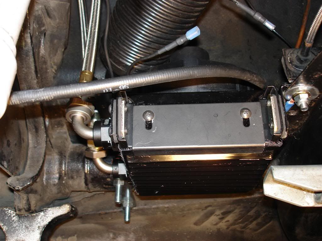

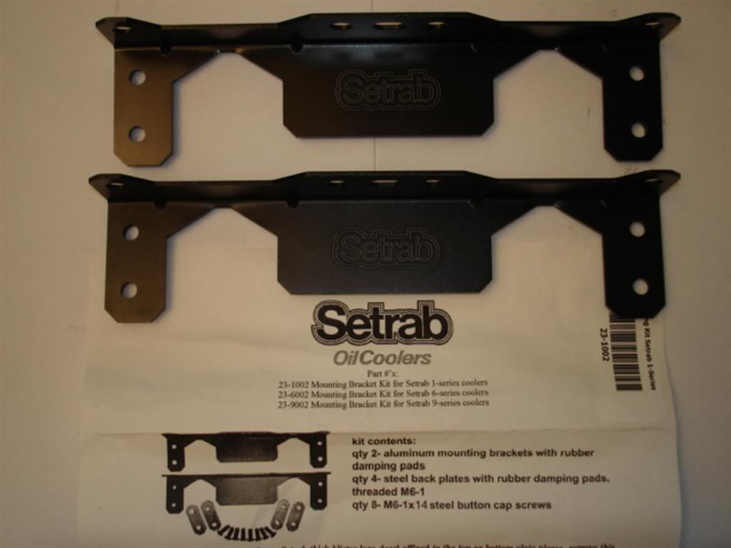

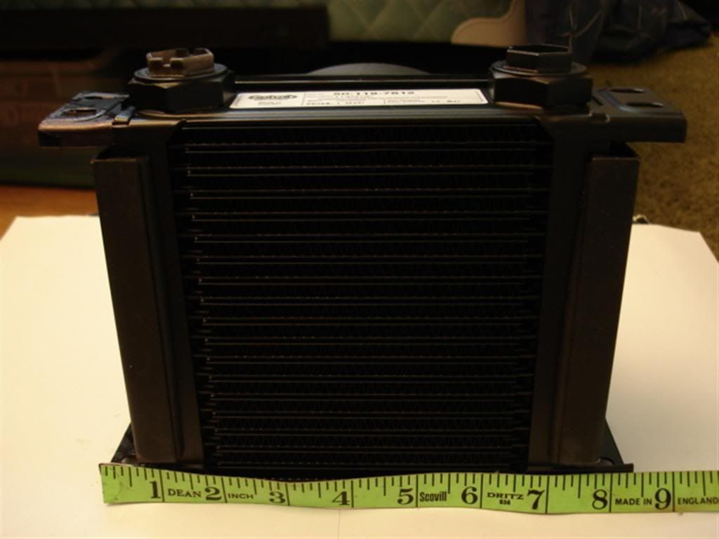

Banzai KG
Joined: April 10, 2004
Posts: 2992
Location: Sunnyvale, CA
Banzai KG is offline
PostPosted: Fri Apr 20, 2007 8:13 am    Post subject: Reply with quote

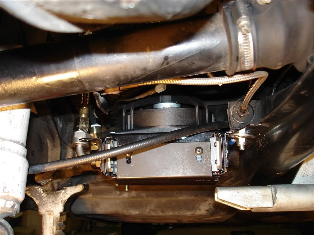

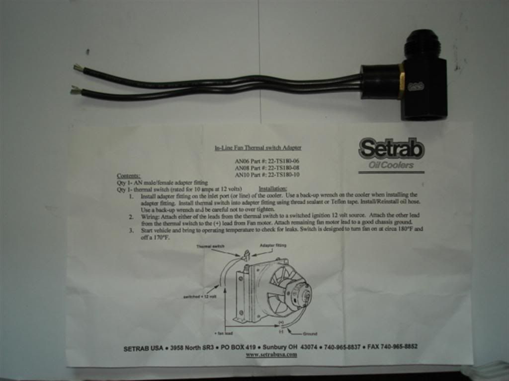

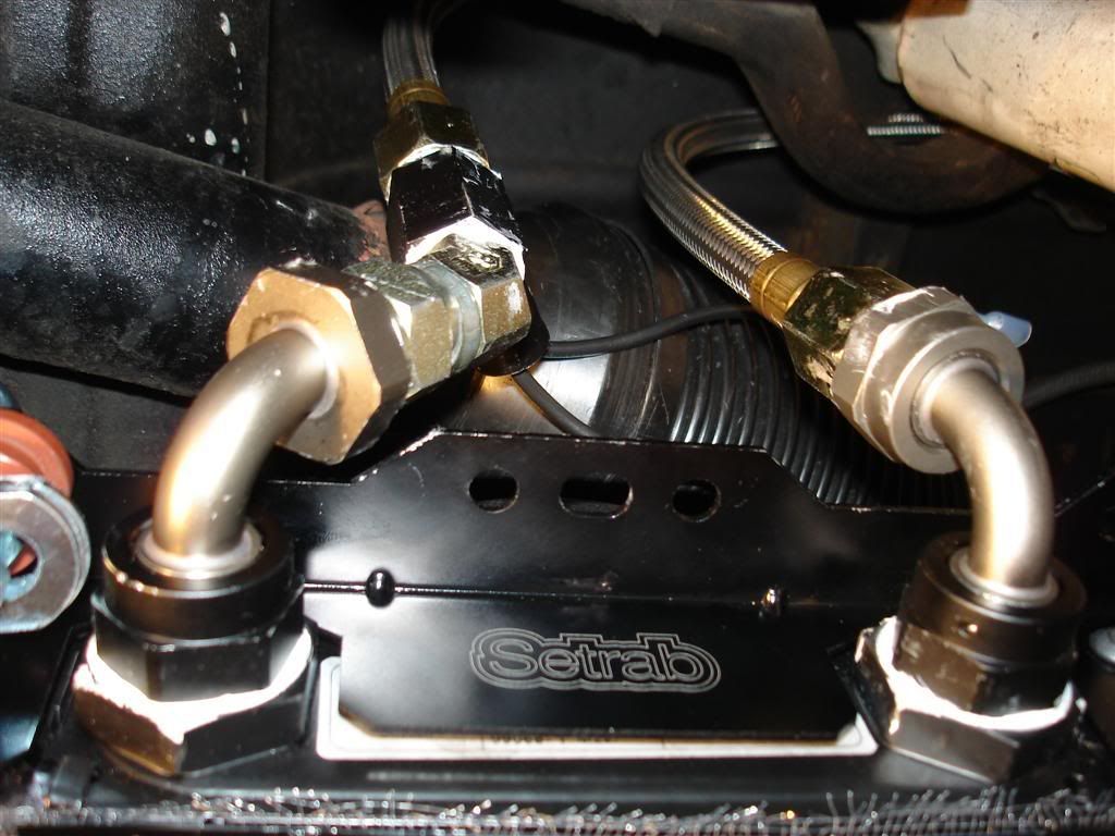

Mad Manx wrote:

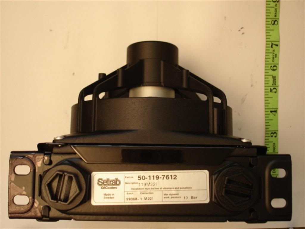

I use a Setbab single fan cooler. I mounted the cooler in the area in front of the axle and to the left of the tranny.
Are you running a swingaxle? Because Glenn has IRS and the limited space of the IRS swing arms may not have the Setrab to fit and will have to have it up higher.
Here is shots of Max Welton's '67 Ghia with the Setrab installed:
I setup my Setrab, mounts, and fanswitch (from Aircooled.net) the same way as Max did on my '64;
One thing I noticed where I mounted mine, I may need to switch to the Joel Mohr mid-mount as the Berg mid-mount rubber pieces won't clear.
The little fins on the bottom are house siding vents and used a screen door mesh to prevent any debris from getting caught between the fins.
