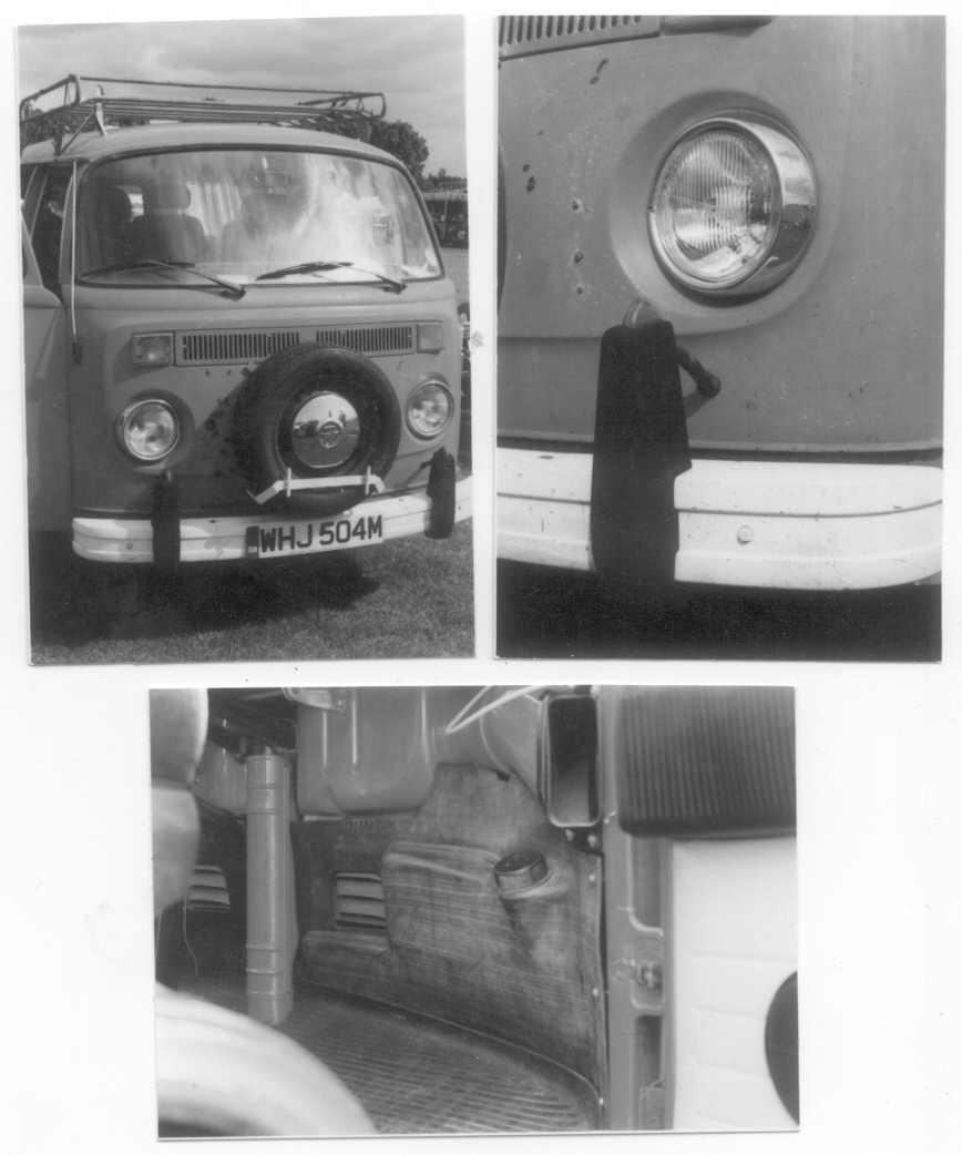

Noting that your 1978 VW 2000 Type 2 Rivierra campervan, is of USA or Canadian specification, you might wish to check whether it is still equipped with USA or Canadian specification headlamp dimmer relay, which does not incorporate the headlamp flasher facility, which British & European owners, take for granted.
http://www.thesamba.com/vw/forum/album_page.php?pic_id=327513
http://www.thesamba.com/vw/forum/album_page.php?pic_id=328148
The five-terminal configuration of the British & European specification, headlamp dip & flasher relay for the VW-Audi (VW part No. 411 941 883B), labelled 30, 56, 56a, 56b and S; terminal 30 being in the same position as the locating lug (not an electrical blade-terminal) of the North American specification headlamp dimmer relay.
The Swedish specification, 1974~79 VW Type 2s, had electrically pumped windscreen & headlamp washers as standard. Note the extra large, black plastic, windscreen-washer reservoir, whic replaces the right-hand kick board.
http://www.thesamba.com/vw/forum/album_page.php?pic_id=328679

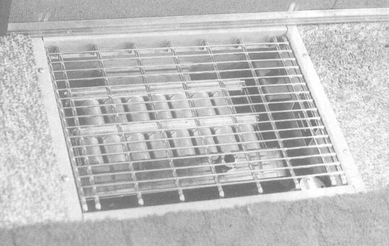

For those camping in their 1968~79 VW Type 2 campervan, in colder regions of the World, such as the deserts and high mountain ranges, which one will encounter, on the overland route from Amsterdam to Beijing, there is a very tidy heater installation as follows, about which I first learned several years ago, in some literature sent to me by QB Autocamp, a British mail-order company, specialising in VW Type 2 parts.
http://www.thesamba.com/vw/forum/album_page.php?pic_id=343618
This Riviera BVW-2 brand, floor-recessed, LPG-fired, warm-air heating system, was specifically designed for modest-sized campervan, such as the 1968~79 VW Type 2, as illustrated above.
The main advantage to this type of heater, is that it does not take up any space in the main passenger cabin or any of the storage lockers, which is the case, with the various types of blown-air heating system.
http://www.thesamba.com/vw/forum/album_page.php?pic_id=343620
This Riviera De Luxe brand, floor-recessed, LPG-fired, warm-air heating system, was specifically designed for trailer-caravans and trailer-tents, as illustrated above, but can also be used in larger campervans.
http://www.thesamba.com/vw/forum/album_page.php?pic_id=368611
This is an in-situ picture, of a Riviera, floor-recessed, LPG-fired, space heater, which can be installed in either trailer caravans or campervans, such as the 1968~79 VW type 2, for which there is/was a special version, designated version BVW-2, as illustrated earlier.
