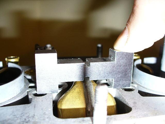

PostPosted: Wed Jul 18, 2007 6:05 pm    Post subject: Reply with quote
Here are the tools I made:
The tool on the left is used to set the distance from the carb top to the tip of the inlet valve like this:
The distance is set by changing the thickness of the gasket between the valve and the carb top. Spec is 25.0mm.
The tool at the far right of the top pic is used to set the distance from the float's tab to the carb top. Although my tool looks adjustable, it is only adjustable to get the setting according to Weber's spec, 24.2mm. Here it is installed:
Then when the carb is turned upside down, the float "rises" to touch the tool like this:
Finally, the last tool is used to measure how much above the carb top the float rises to:
Note the slot machined in it. This is to clear the seam of the float. The tool has this machining on both sides, one is machined so the step is 5.5mm, the other is 6.0mm. The spec is to have the 5.5 touch the float, and have a gap for the 6.0 side.

Thanks,Bruce .That is exactly what I needed.Those tools are nice and the pics and instuctions were AWESOME! The float depth tool that they dont show in the manuel is what was stumping me.

Yes thats it Exclamation
Very good to see the specs clearly.
excellent now i can go and set mine.
Thanks for posting that up. Cool
