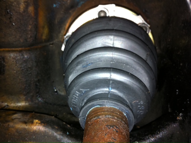

PostPosted: Mon Feb 21, 2011 7:51 pm    Post subject: Reply with quote
Didn't TOTALLY squander the presidents' day holiday... Took the 8 hours necessary to swap out all the CV's. Nice new lobros and some stout looking Rockford boots. I found their customer service to be perfectly acceptable. Talked to a really nice lady on the phone. #339-22 (the 22 is the code for the entire kit, with grease, no bolts), the boots themselves say 339-4 on 'em.
I wasn't able to find any pics of this set up, so here y'all go. These pics appear to all be upside down, but whatever...
I'll keep you posted on how they wear.

Hi Ryan, how have your Rockford CV boots been holding up from your post above? I need some boots ASAP and am still debating the best current product....
Thanks in advance for any input you have!
