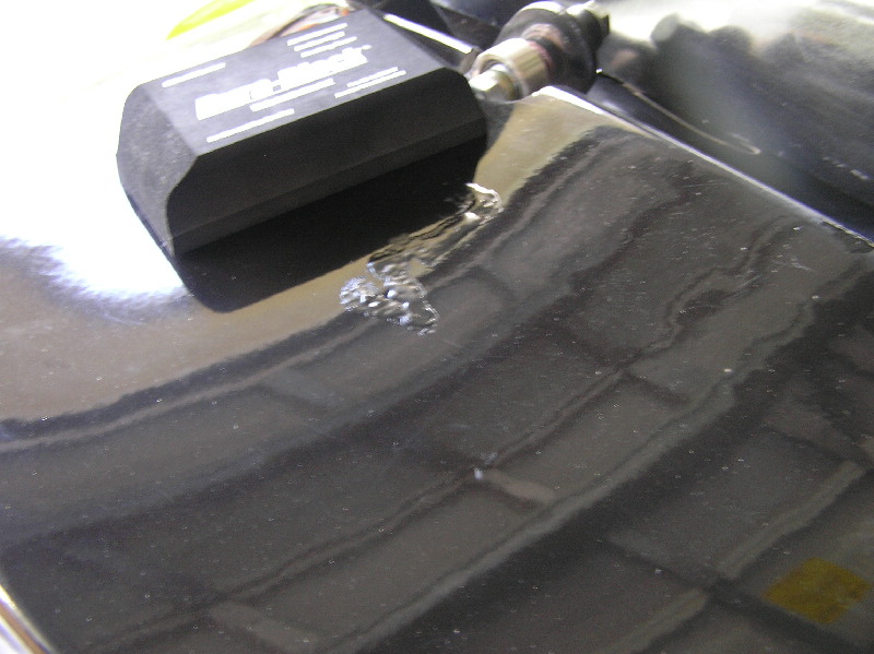

I am building this buggy over on the Off Road Forum, thought I would post my recent gel coat repair here since you all might get the most out of it.
This is a new Vegas Buggy body, it was damaged during shipping, two deep scratches through the gel coat. A brand new body, with scratches, entirely the shipper's fault and they refused to do anything about it.
The repair came out great and only took about 2 hours total time.
Started with Neutral Gel Coat-Un-waxed, one quart was the smallest I could find, MEK Hardener, Lamp Black Pigment, Surfacing Agent, Xylene, and of course gloves.
Mixed 1 oz. of gel coat with the pigment, hardener, and surfacing agent, you have got to wear gloves when messing with this stuff.
Here are a couple of shots of the before...
Applied the mixed gel coat with the torn end of paper match, a paint brush would leave too much material that you'd end up sanding off later.
Let it set for about 45 minutes.

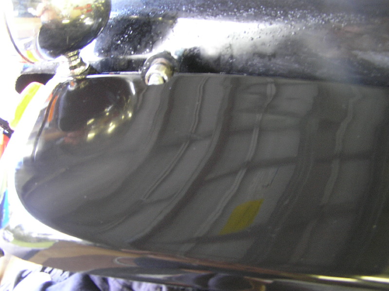

Then I block sanded the area just near and over the repair starting with 600 grit wet dry paper, then 800, 1000, 1200, and finally 1500. Sanding just enough to level the repair then with successive grits to reduce the scratches.
Then I used a variable speed buffer on medium speed along with Meguire's 85 buffing compound to finish the job.
And here is the after shot,
I'll just use more of the Meguire's for some small build scratches that I have caused in the shop, they will come out very easily.

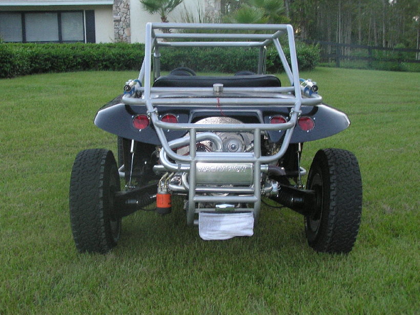

PostPosted: Wed Aug 22, 2007 5:30 pm    Post subject: Reply with quote
Here is one from a couple of weeks ago, I am doing most of the final punch list stuff now, I have about 5 pages on the other forum, just search my screen name to see the entire build.

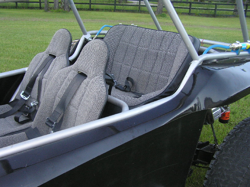

PostPosted: Wed Sep 19, 2007 4:45 pm    Post subject: Reply with quote
Finally got the buggy completed, I took these shots today for the insurance company. Look for her here in the classifieds on The Samba and then, depending on how that goes, on to Ebay over the next couple of weeks.
