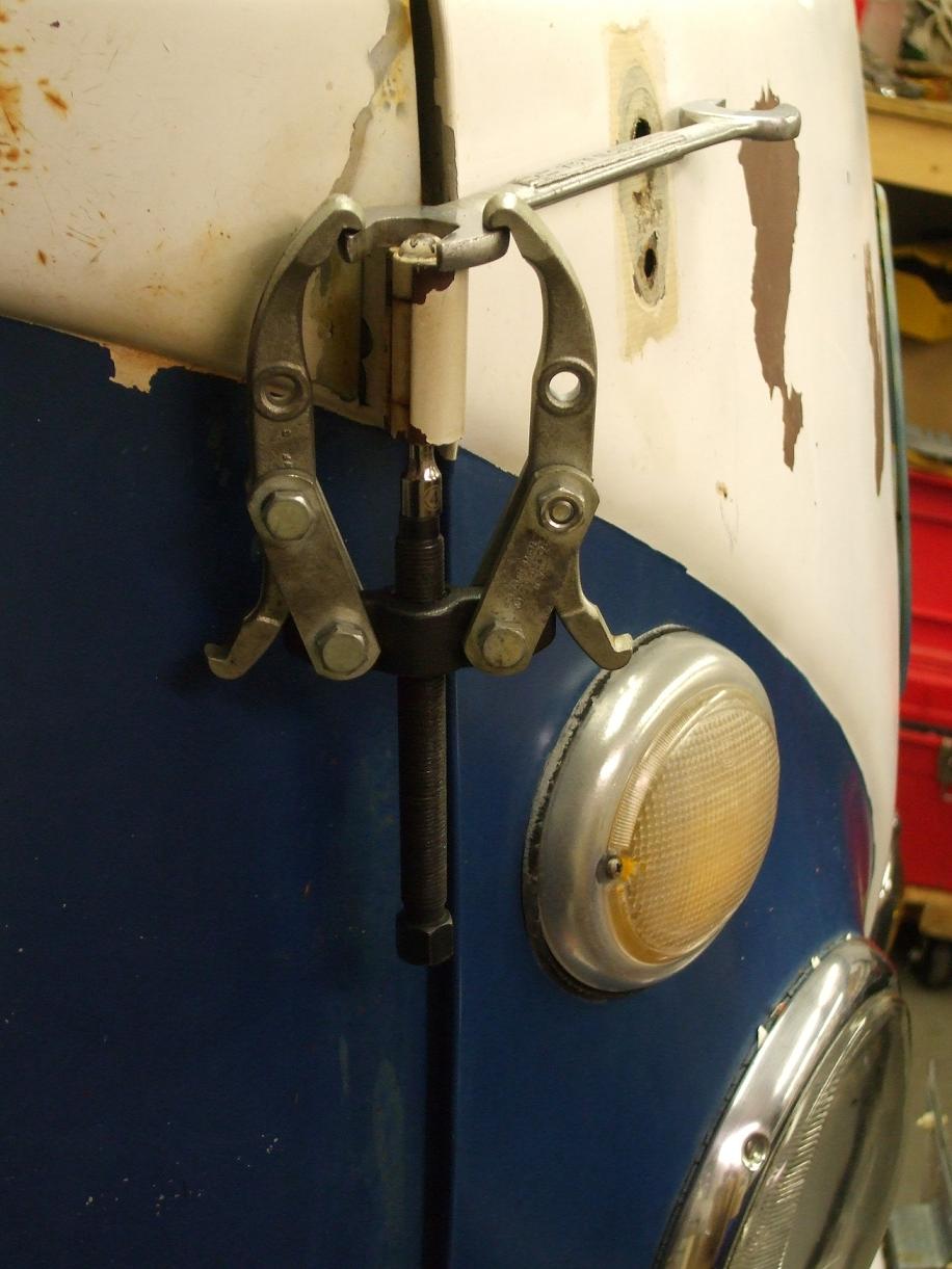

didn't werk for me... puller kept sliding off the wrench
... had to open the door
and she came right out Cool
