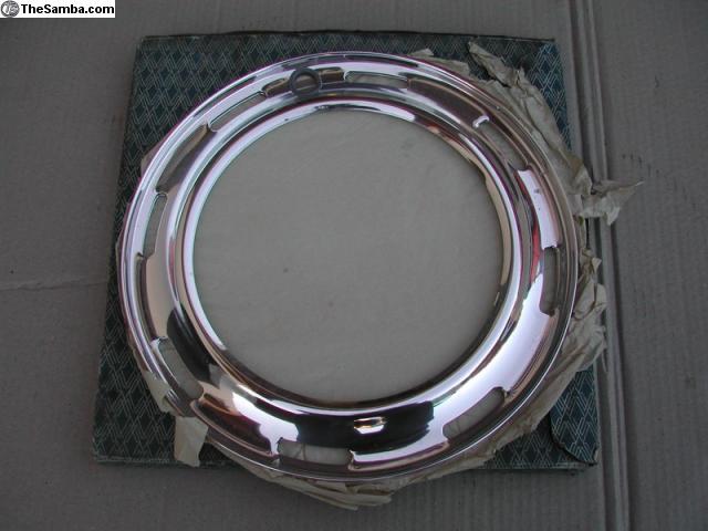

There is TWO kinds
of the Beauty Rings (EARLY TYPE)
Original EARLY Type 3 is Thin
NOT that DEEP around the edge
show ALL your Beauty Rings
you will SEE what I'm talking about

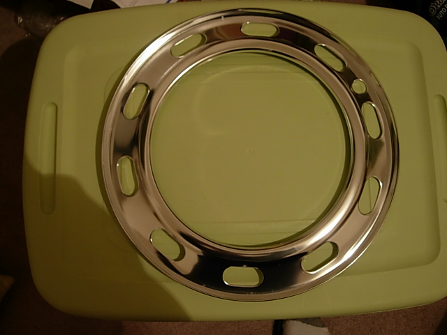

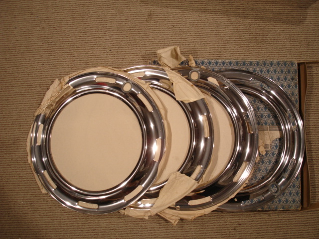

trim ring 1-set purchased from pedro

trim ring 2-another NOS set,different slots.forgot where I got these,oz maybe.

side by side comparison.see the difference,even in the valve stem hole.

so if I am looking at these two pictures.. and making an educated guess...
Picture 1: this looks to be a correct T3/Ghia trim ring ... you can see that it fits snug and the valve stem seems to come close to the center most point of the slot
Now in this color picture.. I am guessing these are likely bug or aftermarket trim rings... they dont appear to be too tight, and you can see the valve stem is nearly resting on the outermost portion of the hole.
