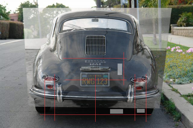

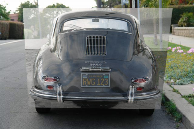

FWIW, I did a little futzing with Photoshop to see if I could get an idea of relative tail light placement between my car and the original photos of a '53 on Der White's website:
The perspective is a little different, but I was able to line up the major body lines, etc.

Perfect! That will really help. I feel pretty confidant that the innermost lights outer diameter begins at the point of my existing teardrop. The perspective of the reference photo begins to distort towards the edge, shifting the outer lights upward. You can tell this by how the bumper tips don't align. So, I think the outer lights are probably on the same horizontal centerline as the inners (unlike as the photo suggests). The key number for me is going to be the measurement from centerline to centerline of each pair of lights.
I put some reference lines over the drawing, showing the critical points that need a number. I think the best point of reference might be from the center, bottom edge of the engine lid opening (that point should be the same on all cars, whereas the bottom under the bumper is sometimes tweaked or changed as well).
I also put a copy of the Photoshop document on my server if it helps:
http://www.jigglingwhisker.com/downloads/composite.psd

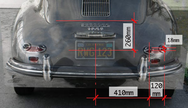

I received a message from someone with a disassembled '53 who took measurements (THANK YOU). Based on their car, the outer lights are slightly higher than the inners (~.75"). All dimensions are from centerline to centerline. Here they are:
