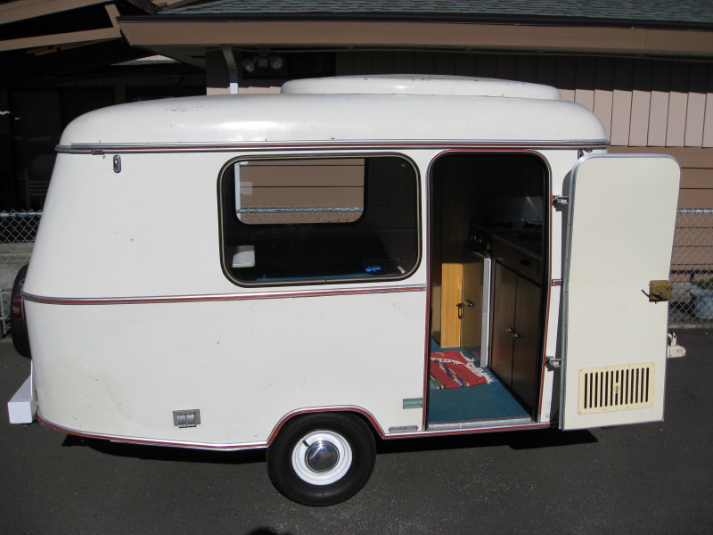

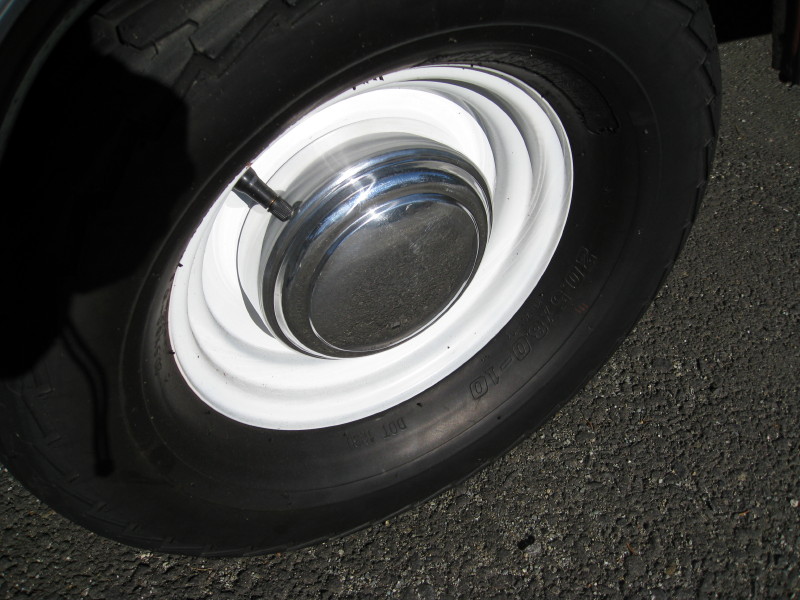

PostPosted: Mon Mar 17, 2008 8:20 am    Post subject: Reply with quote
Here's a few pics

Take a look at the difference between the pictures posted by me and by the last guy from the Eriba Touring guy and make up your own minds. The size of the tire in his picture is clearly significantly larger than the wheel well on a Puck. That someone put a tire like that on a Puck was absolutely stupid, and deserved that result.
The pictures of the tires on my Puck are perfectly suited for the trailer, are not going to blow out the wheel well, and are commerically available through just about any tire store here in the US, at significantly less expense. I did not want to have tire that I must get from Europe on my trailer as I drag it across a different continent. OEM tires available from limited suppliers and greater expense on another continent make sense only if your trailer is show pony, and not intended for actual use on the highways here.
My .02. Like I said, look at the pictures, make up your own minds. I have 5,000 trouble free miles now on the tires in the pictures I posted. When I am done with them, and have bought another three, I still will not have spend as much as I would have on even one OEM size tire set.
