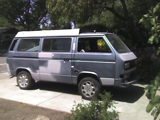

Here is a poor quality (cell phone) photo of my Westy - after body work and primer, but before Line-X and paint. Note that pop-top is 100% primer gray in this photo (luggage rack inside vehicle). Also, just as much body work done on other side of bus. Due to all of the rock damage and pitting, the body shop sanded down the entire nose of the Westy and then primer.
