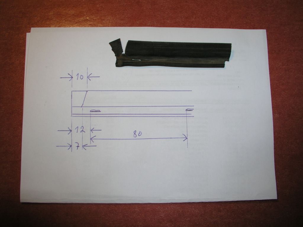

Here a picture and drawing with dimensions in mm. This is original cutting of the split door window lower rubber.
And here you can see the cutting angle in other direction, it is not straight.
