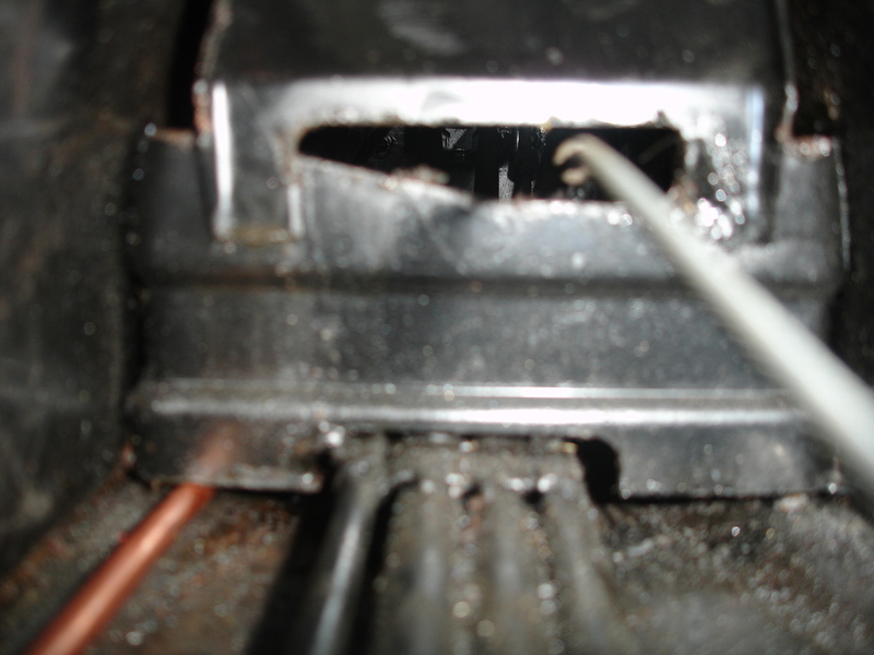

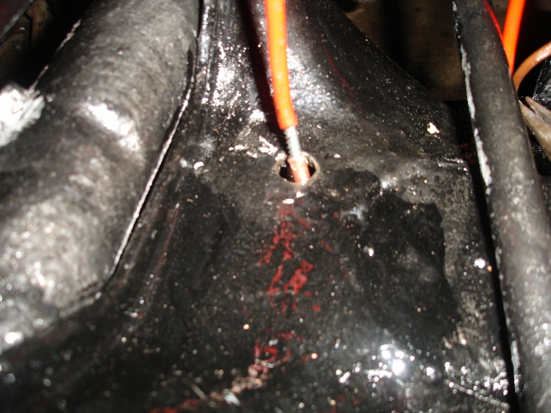

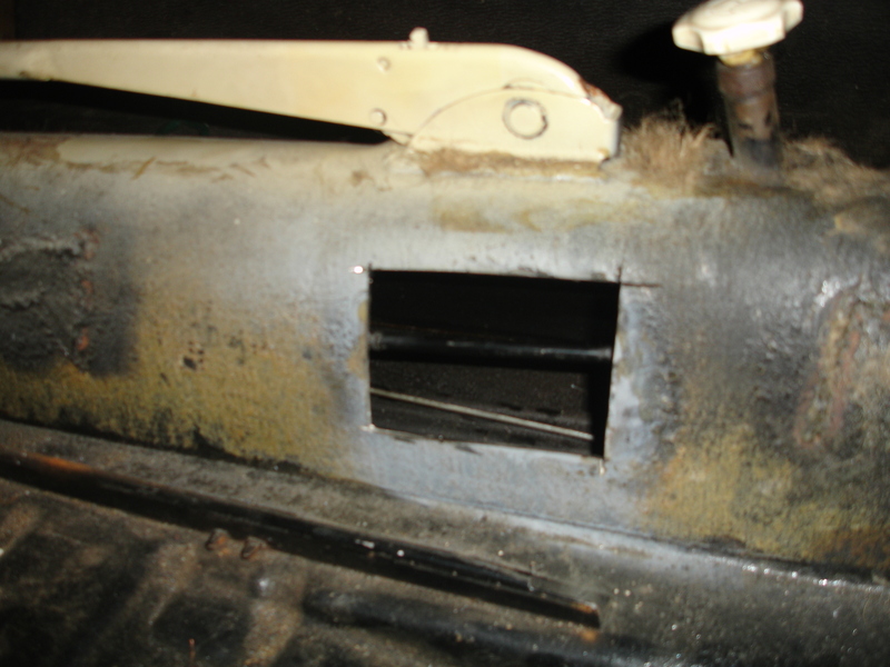

Had to replace the fuel pipe on my 53 and despite my sane rational side saying run the tube along side the tunnel ,i decided to run it inside .
I found a few previous access holes which had been badly covered up so this was an opertunaty to tidy it all up.
Looking towards the front .Note clutch cable to the top right.
Here shows plastic pipe used to pull copper alloy pipe (doesnt go brittle like pure copper)through the frame head as i didnt want to cut a hole there.
New pipe was tie wrapped to the existing stuff to make it rigid .

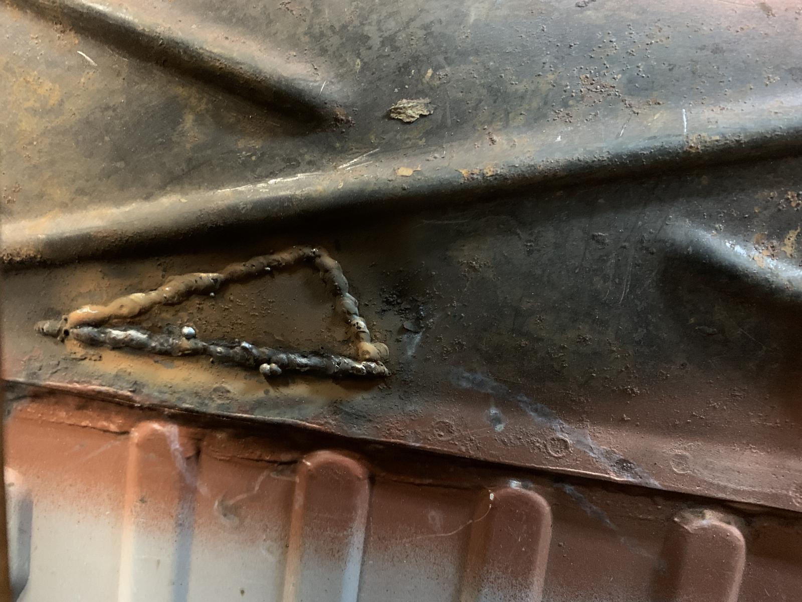

I finished up this repair a few years ago, but just ran across this thread. So, I thought that I would post up another method. Always more than one way to skin a cat!
The fuel line is held in place. It is not welded at the retainers. No where along the run is this conduit welded. Funny stuff I never knew!
So, to get the old fuel tubing out, I had to get creative, as the retainers were super tight. The tubing will push through the retainer, but not the rust. So, I cut the tubing as close to the retainer as I could and hammered out the remnant piece.
Like this! The retainer has an unwelded seam!
Pulled out the roll of tubing and cut a segment off.
I then threaded it into the retainer. Perfect fit!
Had to cut a small triangular piece out of the tunnel bottom to access this retainer.
See the tubing going through.
Then the retainer in the middle.
Then, utilizing the previously cut fork, I push, bent, pulled and pried the new fuel tubing through the fork.
And then I pulled it out of the opening on the top of the fork.
With the tubing sticking out the back, I turned my attention to where it needs to exit the tunnel at the front.
Utilizing that front access hole, directly in back of the Nap Hat, gives me access to the area by the pedals and the area in back of the frame horn. And there it is, the fuel line!
I then pushed the line all the way forwards, till it came out the inspection cover hole. Cut off this piece from the roll I had and returned to the rear of the car To pull out the line, back to the Access hole I made, so I can bend the tubing, to help get it through the exit hole.
I then returned to the front, bent the end of the conduit at a 45 angle and weaseled it past the e-brake conduits. It has to curve under these and then stick out the tunnel. Spent a lot of time, pulling a small amount, bending it, pulling, bending, on and on. Until finally, the tubing cleared the adjacent conduits, cleared the tunnel and exited the front hole!
I then worked my way back to the rear, tightening up the clamps and bending the conduit to enter the fork nicely, without rubbing on anything!
Excess at the rear. Better too long than too short!
Cut, recent and pushed back into the tunnel!
Looking down into the fork.
With the new line installed, I wanted to add a rear tubing support, within the fork, to keep the tubing from bouncing around inside there loose. So, I added a support in each fork and secured the tubing within each one.

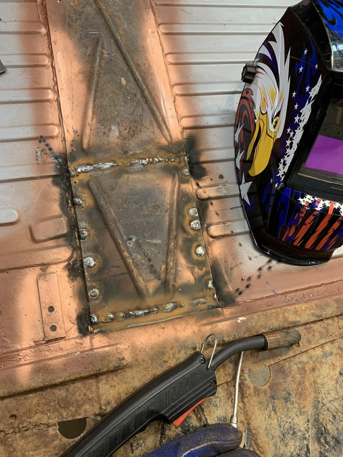

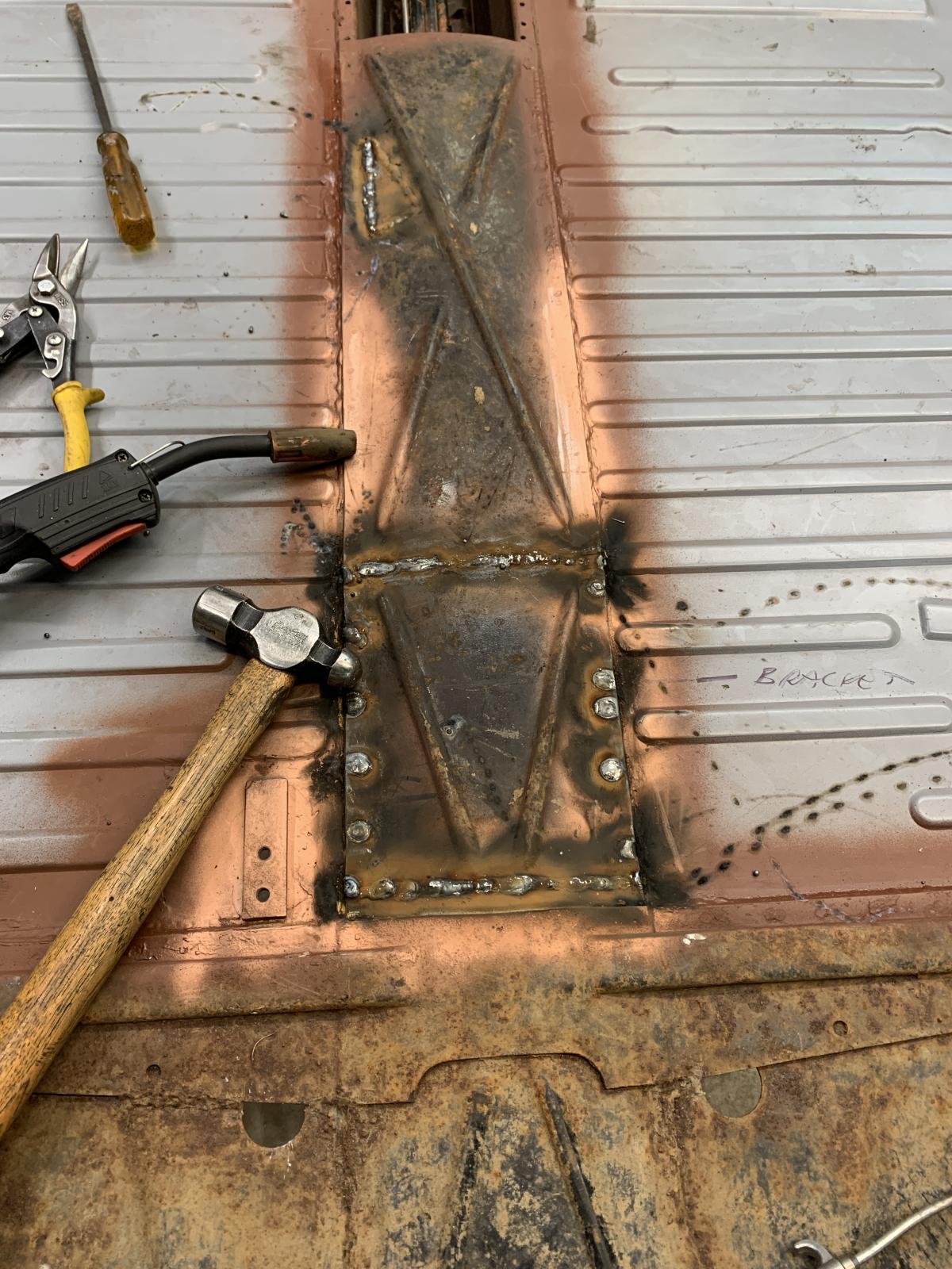

I then checked the fit of the previously removed pan and made some cuts to ease in alignment. There, perfect!
Tacked that side in and went to the other side.
Then welded the two of them up.
Also, welded up a rust hole in the fork.

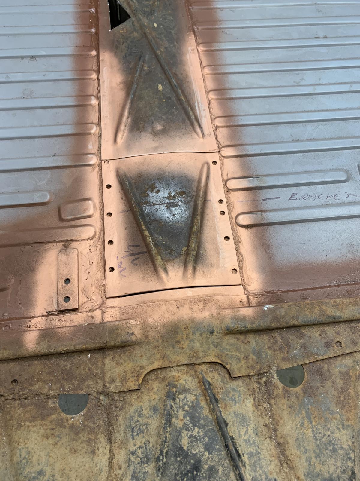

With all of that installed, I moved onto buttoning it back up. First, prepared the front access hole. Ground it down to clean steel and shot some weldable primer onto the surfaces.
Same with the cover. Also, had to hammer this one flat again.
Laid into place and welded! Keep catching the seam sealer from the pan install on fire.
Then over to the triangular piece.
It was then time to stop, clean up and return to the family! Until next weekend![/quote]

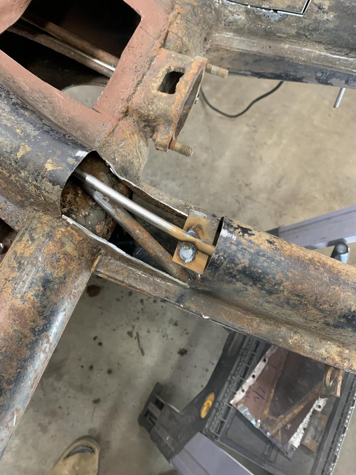

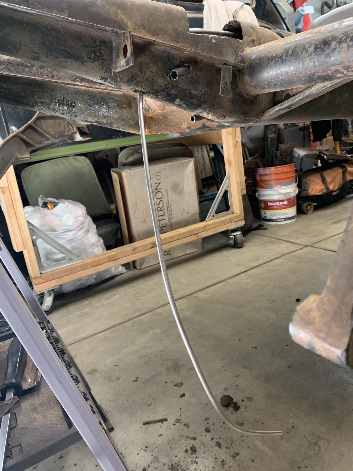

PostPosted: Thu Jun 19, 2025 9:57 am    Post subject: Re: Photos of fuel pipe replacement. Reply with quote

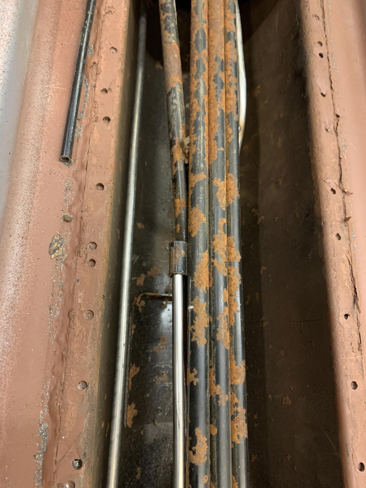

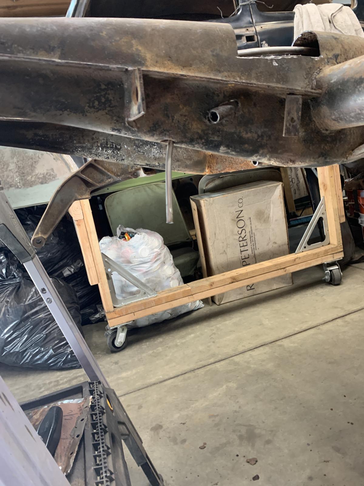

I recently did this on my 67. First I located the three tabs the the fuel line travels through. One is just barely visible as it is located at the back of the fork behind the shift coupler. I had the shift rod out at this time and it made it a little easier to see this one. the second one just ahead of the ebrake opening and the third is just before the pedal cluster opening. This one is clearly visible through the inspection opening in the front of the framehead.
With a long flat head screwdriver, I was able to open them just enough to allow the old line to slide through.
Penetrating oil was spray on all three tabs. I then took a 5mm tap and threaded the inside of both the old and new SS line. I then coupled the two lines together with a 5mm bolt with the head cut off.
I then was able to get the end of the old line out of the inspection opening by useing a pair of vice grips clamped on the line coming out of the fork and tapping it with a dead blow hammer. When I got enough of the old line sticking out the inspection opening, I used an old grip I had from my days as a lineman, working for an electrical contractor. I then, used a belt hoist connected on one end to my pickup and the other end to the grip. This, along with a few shots of penetrant about every 3-4 inches made short work of this project.
New line is in place and I hope I never have to do this again.
