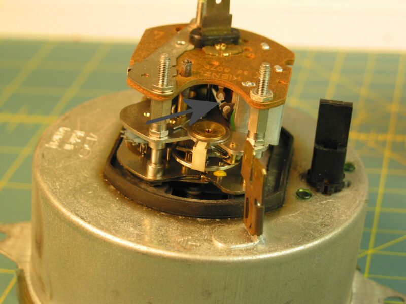

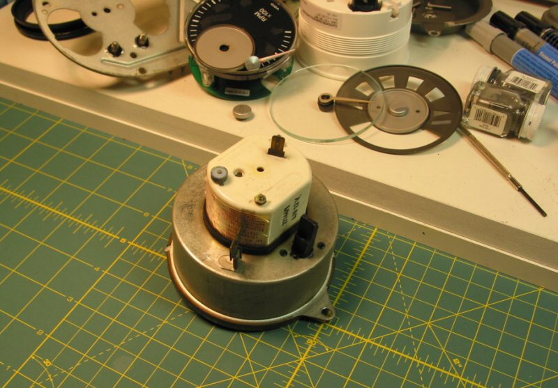

Rather than starting a new thread I thought I would add some photos and information here on clock repair. I just got my clock going. This works for the earlier electro-mechanical clocks, not the quartz motorized versions:
1. Remove the white plastic case from the back of the clock by removing the 3 small nuts. One is hidden inside the round plastic tamper device. You will need to break the tabs on this little guy to unscrew the nut.
2. Flip the clock face up and spray the gears liberally with contact cleaner. I held mine above a white paper towel and loads of crap came off the mechanism although the mechanism looked pretty clean. At this point you should be able to test the function of the clock by manually advancing the winding mechanism (the gizmo with the points attached to it and the tall silver spring). The winder only rotates about 90 degrees. The clock should run for about a minute or two when wound.
3. Re-solder the fuse-link with low temp solder as described on the label on the clock. (Or do as KenManiac suggests above and squeeze a chunk of solder in the copper contacts. The contacts have a hole in each of them filled with solder in the photo.) The arrow in this photo shows the two copper contacts sprung apart. If the clock is overloaded the solder will melt and the contacts spring apart breaking the circuit. The top tab should overlap the bottom tab. The top tab is sprung up in this photo. You may have enough left over solder that you can simply heat the joint and re-fuse it.
4. Inspect your points. Mine were pitted and corroded a bit. I filed them clean and flat. I had to remove the arm to get to the one contact on the arm. When you reassemble the arm, make sure that it aligns nicely so the contacts touch cleanly and centered. You have some adjustment in the slop of the mounting screw. The arrow indicates the point on the winding mechanism.
5. Lube the mechanisms. I used a light sewing machine oil. I tried to stay away from the one plastic gear that I saw.
6. Test with power. I hooked up some power leads to run off my silver socket in the dash. The clock sprung into action and winds itself every 2 minutes or so.
Note: Be careful that that knob to set the hands is not engaged when the clock is running. Mine has a sticky spring so it can stay engaged after setting. This would bind up the works.
