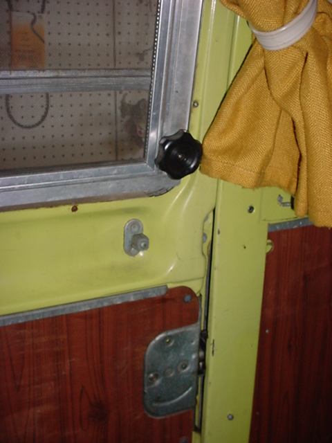

New 78 Westy owner, learning about all the obscure buttons and knick-knacks in our bus...
What's this doo-dad on the sliding door? (orange arrow pointing at mystery knob)

PostPosted: Thu May 08, 2008 6:33 pm    Post subject: Reply with quote
I believe someone asked this yesterday. There should be a second handle at the back of the door to help close it from the inside without slamming the door.

PostPosted: Thu May 08, 2008 6:41 pm    Post subject: Reply with quote
Same as the front handle but it does not move. It is a helper handle.
Remove the screw from what you have left and sh!tcan the piece on the square shaft. It was part of the old handle.

So I tried removing that metal knobby part of the old sliding door upper right handle bracket, and I busted the entire bracket. The rectangular piece (that the handle fits into) broke off the rest of the bracket. Anyone know where I can buy this small metal bracket that is bolted on to the door and holds the handle in this location? (see my original pic with arrow). Thanks.

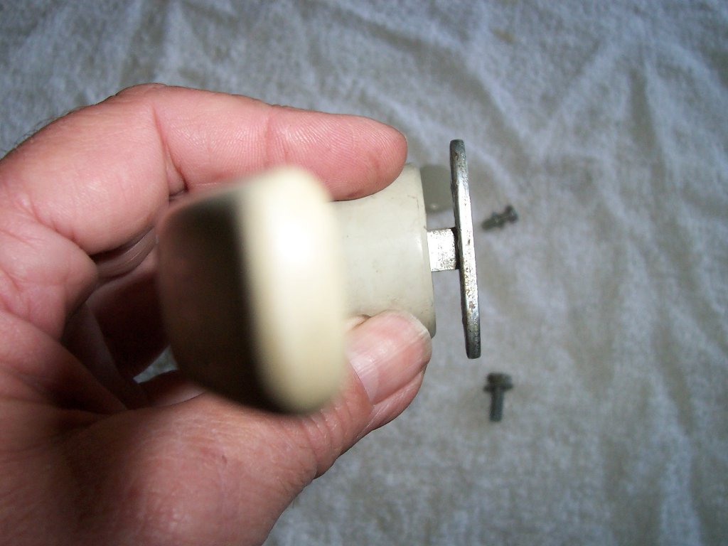

hazetguy wrote:
my 74 Westfalia has one that i want to put a handle on.
From what I know of those helper-handle brackets, the square post with the M5 pre-threaded hole, is angled slightly towards either the front or the rear of the sliding door. Which direction of tilt is the correct one?
To which 1968~79 VW Type 2 models and model years, were these helper handles fitted and in which countries? From what I have read, they seem to be associated with Westfalia campervans, but noting that they imcluded in the official 1968~79 VW Type 2 Replacement Parts Catalogue & Microfiche, I wonder whether they might have featured on other models as well!?!

PostPosted: Sat May 24, 2008 9:24 am    Post subject: Reply with quote
If it is tilted, it is bent. New, it was straight. I will dig out an extra and take a pic of it..... Ok, found one:

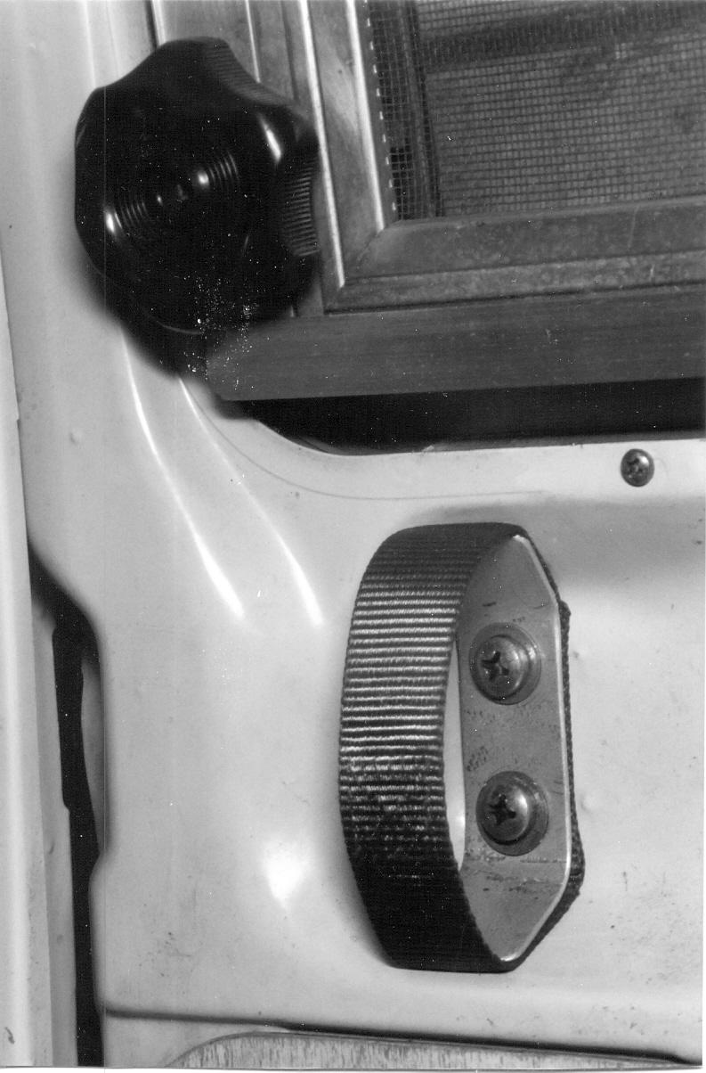

BruceJ
Joined: June 16, 2009
Posts: 260
Location: Portland, ME
BruceJ is offline
PostPosted: Sat Jun 18, 2022 6:00 am    Post subject: Re: 78 Westy, knob on sliding door Reply with quote
I just ordered one of these kits from www.buttysbits.com for my '72:
https://www.buttysbits.com/?product=bb-155-westfalia-sliding-door-helper
Q: If I close the door to install this, will the door stay in place when I remove the two bolts?

PostPosted: Sat Jun 18, 2022 7:24 am    Post subject: Re: 78 Westy, knob on sliding door Reply with quote
Nigel has the set-up. If you place a plastic handle for the helper position it’ll never crack unless you use it.

busdaddy
Joined: February 12, 2004
Posts: 52934
busdaddy is offline
PostPosted: Sat Jun 18, 2022 8:14 am    Post subject: Re: 78 Westy, knob on sliding door Reply with quote
Yes, but I would make sure the rear 2 are properly tight before removing the fronts, they should hold adequately to prevent it moving out of adjustment.

NASkeet
Joined: April 29, 2006
Posts: 3222
NASkeet is offline
PostPosted: Sat Jun 18, 2022 11:59 am    Post subject: Re: 78 Westy, knob on sliding door Reply with quote
busdaddy wrote:
Pic from Colin's refresh thread:
Once one has checked the tightness of the rear-most pair of M6 bolts, fully close & lock the sliding door, before removing the front-most pair of M6 bolts to retro-fit the pull-close handle or strap. By doing this, the sliding door is also supported by the locks rather than solely by the sliding hinge mechanism.

BruceJ
Posts: 260
BruceJ is offline
PostPosted: Sat Jun 18, 2022 12:46 pm    Post subject: Re: 78 Westy, knob on sliding door Reply with quote
Thanks for the tips! And yes, it would not surprise me if the plastic handle breaks--that's what plastic seems to do best--but I have an extra handle laying around anyway. If (when) it does break, I might try a more creative solution--spigot handle, leather strap, who knows?
