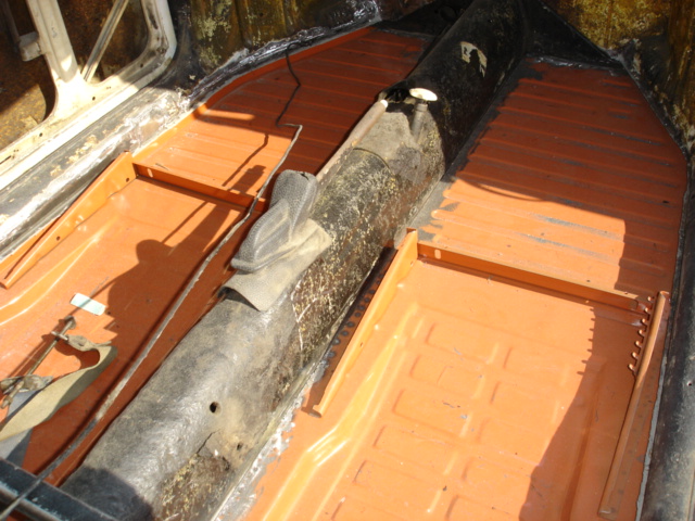

They are listing them for '55 and earlier now. The pic looks the same as the pressing for the later '56-'71 kind, but they might have just used the same pic.
Does anyone kno0w if they have the correct pressing, esp. the rear inner corner contour??

those are all new pictures. The shape in the battery tray area is not correct (it is still later style with the battery back farther on the pan) but the width of the entire depression does not appear to widen out like the ones they sold before. If the width is correct it would now be easier to graft that rear section and move the battery depression forward on a set of these. The only other differences I see is that they come with the correct seat tracks and they are not mounted.
If they are really the same thickness as original that is a good thing too.
Not quite there yet but appears to be an improvement.
their older ones:
The new ones:

Tony Moore replied and confirmed that the floor pressing is the same between the '55 and earlier and later ones, just the seat tracks supplied with them are different. As Chris pointed out, you could graft in that inside rear corner of an original as it seldom rots out, and have something pretty close....

These look really nice. They indeed have the strait sides of the rear trough so it should be possible to modify these to the earlier style as long as you have the back portion intact and you move the battery depression forward.

You can see that the major differneces are that the depression for the battery is very close to the end of the reinforcement stampings on the old style pan. Also note the contour of the inner portion at the back.
The two ribs at the front of the rear well depression extend up the sides and to the flat part on the old ones.
There are also some differneces at the front of the pans where the pedals are and with the pressings for the ribs that the front.
I think that it is the best place to start if you have the rear corners still intact and possibly the front pedal area that we have had for a long time.
I can't say that I blame Tony for going this route. How much market is there really for the old style pan's? This is much better than the orange pans that they sold before which were nice. There is really much more market for the 55 and later cars so this is a good compromise.
Based on some of the stamping details at the front of the pan I suspect they bought the old tooling from VW Mexico rather than having new tooling made.
All in all these pans look great. Yes it would be nice to have 100 point correct early pans but these can be made to look correct with some work.
I will be buying a set and modifiying them.
Now if they can just make some good heater channels....
