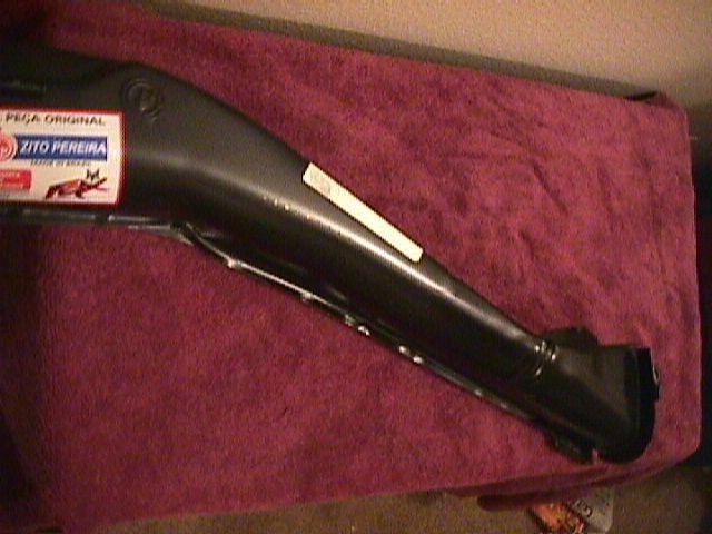

PostPosted: Sat Oct 18, 2008 9:45 pm    Post subject: Reply with quote
heres a few more pics from my gallery of the el cheapo Zito Pereira ones from CIP :

PostPosted: Mon Oct 20, 2008 11:54 pm    Post subject: Reply with quote
if you cant source out a set from a parts car and you have to but aftermarket...i would suggest the econo heater channels from cip. no heater outlets/inlets and no heat tube inside (so if you want heat, dont use these), but i found the shape/curvature to be "most" like original channels.
(disclaimer...we are dealing with a repro item so you do have to be wary about fit & finish, bolt holes lining up perfectly, etc.... Wink )
link to part...
http://www2.cip1.com/ProductDetails.asp?ProductCode=VWC%2D111%2D801%2D045%2DD
not the greatest pics, but in my car....

PostPosted: Tue Oct 21, 2008 7:28 am    Post subject: Reply with quote
I'll agree that the best opt is original channels from dry parts car. They are out there, but you have to lie in wait for while usually.
I bought the CIP to use a donor material for my '51. I have a couple oval channels as well, and hope to have enough to fab something correct.
I was disappointed in the CIP ones though, at the forward bend, there is some ripple/kinking of the steel that I don't see in the pics above. Anyone else seen this??

PostPosted: Tue Oct 21, 2008 7:43 pm    Post subject: Reply with quote
they do look like Zitos, the ripple is up front just behind the "firewall" I can just see a slight ripple in the greenish ones above, probably a gamble whether they will have a bad ripple or not ,but unless you dont plan on running carpet the ripples wont be noticable, I've never pulled back a carpet and found pristine smooth metal anyway, always a bunch of carpet nails, seam sealer and plenty of unsightly messy glue
