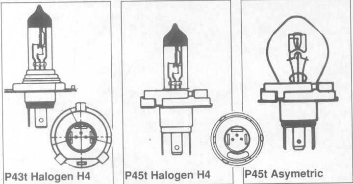

If one's existing headlamp units, are of the type with 45/40W R2 glass-envelope bulbs, then provided the reflectors still have a good mirror finish, one can simply substitute at very modest cost, a pair of P45t flanged, 60/55W H4 quartz-halogen bulbs, which give a vast improvement in headlamp performance, without making any modifications. This is what I did in summer 1976, about 32 years ago, with my family's then recently acquired, second-hand, British specification, 1973 VW 1600 Type 2 Westfalia Continental campervan. H4 bulbs have an integral, black filament-shield, so if practical, it might be worth removing the redundant bulb shield, from the headlamp reflector, which would otherwise cut off a small portion of the light output.
Picture of P45t & P43t flanged H4 bulbs
http://www.thesamba.com/vw/forum/album_page.php?pic_id=338649

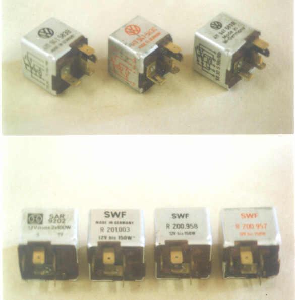

Normally, accessory relays can be plugged into the vacant positions of the 1971~79 VW Type 2, combined fuse & relay box, but if this is not an option, there are several other ways of mounting & connecting them, including plug-in, accessory relay boxes, or even moulded plastic, six-position, relay connector blocks, salvaged from Austin Montego or Metro cars, of which I have two mounted inconspicuously, beneath my 1973 VW Type 2, steering-column support bracket. I still have a few spare, for sale or barter.
Picture of the direction-indicator relay, headlamp dip & flasher relay and three accessory relays, mounted in the 1971~79 VW Type 2, combined fuse & relay box
http://www.thesamba.com/vw/forum/album_page.php?pic_id=327515

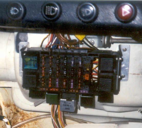

This is the Vauxhall Cavalier Mk. 2 fuse cum relay box, which I adapted for use on my British specification, 1973 VW Type 2 Westfalia Continental campervan.
http://www.thesamba.com/vw/forum/album_page.php?pic_id=328147
There are as standard, eighteen positions for plastic blade-fuses and four of either turn-signal relay, accessory relays or buzzers. In addition, there are five bays beneath, into which one can slide clip-in modules of two types. One module type accommodates two plastic blade-fuses, whilst the other module type accommodates single relays, of various 1/4 & 1/8 inch blade-terminal configurations, as shown separately in the top two rows of images below.
http://www.thesamba.com/vw/forum/album_page.php?pic_id=327972
I adapted one of the two-fuse holder modules, to accommodate my VW headlamp dip & flasher relay, by cutting and heat welding into the module, the appropriate section of the VW Type 2 fuse & relay box, relay-connector strip.

Apart from the part numbers, the British & European headlamp dip & flasher relay (VW part No. 411 941 583B) is virtually identical in appearance to that of the North American headlamp dimmer relay (VW part No. 411 941 583C), for the 1971~79 VW Type 2s, except that instead of a brass locating lug, there is an additional 6•3 mm (i.e. ¼-inch) blade terminal, labelled 30, which is connected via a red 2•5 mm² cable, to a constant battery supply, at terminal-30 of the fuse box. Similar differences exist between headlamp relays, for the 1968~70 VW Type 2s.
Pictures of the British & European headlamp dip & flasher relay and the North American headlamp dimmer relay, for the 1971~79 VW Type 2, showing the similarities and differences
http://www.thesamba.com/vw/forum/album_page.php?pic_id=327513

If one's existing 12V headlamp units, are of the type with P45t flanged, 45/40W R2 glass-envelope bulbs, then provided the reflectors still have a good mirror finish, one can simply substitute at very modest cost (typically £2•00 - £4•50 each, dependent upon source), a pair of P45t flanged, 60/55W H4 quartz-halogen bulbs, which give an exceptional improvement in headlamp performance (associated with both increased power and bulb-filament temperature), without making any modifications. This is what I did in mid-1976, for just over £9•00 in total, about 33½ years ago, with my family's then recently acquired, second-hand, British specification, 1973 VW 1600 Type 2 Westfalia Continental campervan.
Similar 6V, P45t flanged, 60/55W H4 bulbs, are also available, albeit more expensive, from sources such as P. R. Goff, in Buckinghamshire, which might be suitable for pre-1967, "split-screen" VW Type 2s, with 6V electrical systems; assuming their headlamp units have P45t mounting-flange recepticles, as I suspect they do!
There also seems to be an adapter (Part No. BP4543AD), available from P. R. Goff, in Buckinghamshire, which enables one to retro-fit P43t flanged bulbs, to headlamps with P45t mounting-flange recepticles, but I do not know, whether the bulb-filaments, would be in the optimum focal position, relative to the headlamp reflector!
http://www.norbsa02.freeuk.com/goffybulbs.htm
In mid-1976, I bought for my family's 1974 Triumph Toledo, some new, general-purpose, after-market, Lucas "Brighteyes", quartz-halogen headlamps (with what I discovered many years later, had P45t mounting-flange recepticles) which were factory-fitted with a very different style of bulb-installation adapter. This facilitated the use of Lucas 60/55W twin-filament, quartz-halogen headlamp bulbs, having the crescent-notched, flat, circular, P36t mounting flange, of the British pre-focused-bulb pattern, which is very different from either the P45t or P43t patterns.
To be legal in the USA, owners there will either need to substitute SAE/DOT-standard tungsten-halogen sealed-beam units (said to be a far from ideal, low-power option) or preferably, more modern SAE/DOT standard H4 headlamp units, marked VOL, VO or VOR, with P43t flanged, 60/55W H4 quartz-halogen bulbs. In Mexico and Canada, one has the legal option of substituting European, ECE-standard headlamp units.
Owners of British or European registered vehicles, who need to replace their headlamps, would be well advised to opt for dedicated H4 headlamp units, with P43t flanged, H4 quartz-halogen bulbs (greater choice re bulb manufacturers, power ratings & light intensity), as made by Bosch, Hella, Lucas, Magnetti-Marelli, Neolite, Stanley, Valeo (i.e. Cibie or SEV Marechal), Wipac and other companies. Bosch and Hella make direct replacement Lamp units, but with products from some other manufacturers, one might need additional mounting hardware.
When purchasing replacement H4 quartz-halogen bulbs, it is important to obtain those with the correct flange type, whether P45t or P43t, as illustrated.
Two-dimensional projections of P45t & P43t flanged bulbs
P45t flanged, conventional glass-enveloped bulb
[Img]http://www.vehicle-wiring-products.euIVWPonlinestore/
lighting/photo/bulbphoto/P45tasym.jpg[/Img]
P45t flanged, substitute-H4 quartz-halogen bulb
P43t flanged, dedicated-H4 quartz-halogen bulb
1968~73 VW Type 1, 2 & 3 headlamp, with P45t flanged, glass-enveloped bulb
1968~73 VW Type 1, 2 & 3 H4 headlamp, with P43t flanged, quartz-halogen bulb
1968~73 VW Type 1, 2 & 3 headlamp, sealed-beam unit
Illustrations from the official 1968~79 VW Type 2 Replacement Parts Catalogue & Microfiche, Page & Frame No. 97-00
Top: British & European specification, 1968~73 VW Type 2 headlamp unit (curved-lensed) with separate reflector & lens, plus replaceable bulb.
Middle: North American specification, 1968~73 VW Type 2 headlamp with
sealed-beam unit (curved-lensed).
Illustrations from the official 1968~79 VW Type 2 Replacement Parts Catalogue & Microfiche, Page & Frame No. 97-10
Top: British & European specification, 1974~79 VW Type 2 headlamp unit (flat-lensed) with composite reflector & lens, plus replaceable bulb.
Bottom: North American specification, 1974~79 VW Type 2 headlamp with
sealed-beam unit (flat-lensed).

Factory-standard, 1968~79 VW Type 2 headlamp circuit
Modified, 1968~79 VW Type 2 headlamp circuit, incorporating accessory relays and dipped-beam warning light
By reducing their associated current load, to almost nil, the incorporation of accessory relays, also has the secondary benefit, of extending the lifespan of the ignition switch, main light switch and headlamp dip & flasher relay, for which it is becoming increasingly difficult, to find good-quality replacements, when and if these fail. In contrast, good-quality, 30A and 40A accessory relays, are readily available at modest cost. Hence, it might also be beneficial to implement this upgrade, with the relatively low-power 60/55W headlamps, to both minimise voltage losses and extend component lifespans.
Direction-indicator relay, headlamp dip & flasher relay and three accessory relays, mounted in the 1971~79 VW Type 2, combined fuse & relay box
Note that the combined fuse & relay boxes, of North American specification vehicles, have a two-terminal buzzer fitted, leaving only two vacant positions for accessory relays.
Normally, accessory relays can be plugged into the vacant positions of the 1971~79 VW Type 2, combined fuse & relay box, but if this is not an option, there are several other ways of mounting & connecting them, including plug-in, accessory relay boxes, or even moulded plastic, six-position, relay connector blocks, salvaged from Austin Montego or Metro cars, of which I have two, mounted inconspicuously, beneath my 1973 VW Type 2, steering-column support bracket. I still have a few spare, for sale or barter.
A single, six-position, relay connector block, salvaged from an Austin Montego
Two, six-position, relay connector blocks, mounted beneath my 1973 VW Type 2, steering-column support bracket.

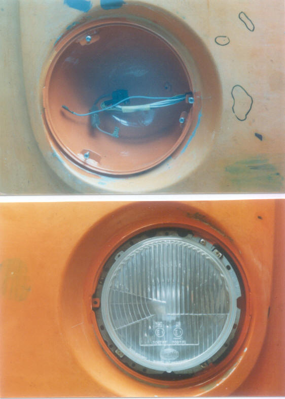

The design of the factory-fitted headlamp units, with single mounting screw, used on non-North American specification, 1968~73 VW Type 2s, severely limits the scope of what replacement headlamp units can be substituted.
By the mid-1990s, the reflectors of my family's 1973 VW Type 2's original headlamp units had begun to lose their lustre, but having some virtually-new, 1974~79 VW Type 2, non-H4 headlamp units, which I had salvaged from a vehicle I broke for spares, I wanted to substitute these instead of buying expensive, new headlamp units, of the earlier pattern. To do this, I had three DIY-fabricated mounting lugs, with captive M4 nuts, welded into the bodywork's headlamp buckets.
Modified 1968~73 VW Type 2 headlamp-buckets, with three supplementary headlamp-mounting lugs & captive M4 nuts, to mount 1974~79 VW Type 2 headlamps or others with the same mounting requirements.
Note that the pseudo-trapezium shaped refractive zone, for the RHD, left-hand dipping headlamp unit, is on the left-hand side of the lens, as seen from the front. For a European specification vehicle, this would have been on the right-hand side of the lens, for a LHD, right-hand dipping headlamp unit.
Template with information for positioning three mounting brackets, for retro-fitment of 1974~79 VW Type 2 headlamps, into the headlamp buckets of NON North American specification, 1968~73 VW Type 2s

Apart from the part numbers, the British & European headlamp dip & flasher relay (VW part No. 411 941 583B) is almost identical in appearance, to that of the North American & South African headlamp dimmer relay (VW part No. 411 941 583C), for the 1971~79 VW Type 2s, except that instead of a shaped, brass locating lug, there is an additional 6•3 mm (i.e. ¼-inch) blade terminal, labelled 30, which is connected via a red 2•5 mm² cable, to a constant battery supply, at terminal-30 of the fuse box. Similar differences exist between headlamp relays, for the 1968~70 VW Type 2s.
It is solely this additional relay-terminal & cable connection, rather than a modified dip-switch, which provides the headlamp flashing facility. Hence, North American and South African vehicles, can also have the flashing facility, simply by substituting the appropriate relay and making the additional cable connection, as a few of my e-mail pen pals in the USA, have already done.
Number the relay images from 1 to 7, by counting from left to right, first across the top row of three images and then across the bottom row of four images.
The North American (certainly USA, if not Canada) specification, VW headlamp dimmer relay (VW part No. 411 941 883C, SWF part No. R 200.957), with red script, depicted as images 2 & 7, has one > ¼ inch brass location lug, plus four ¼ inch, brass blade terminals, labelled 56, 56a, 56b and S.
The British & European specification, headlamp dip & flasher relay for the VW-Audi (VW part No. 411 941 583B, SWF part No. R 200.958, SAR part No. 9202, Hella part No. 201.007), depicted as images 1, 3, 4 & 6 and for the Volvo 300-Series (SWF part No. R 201.003; Hella part No. 201.003), depicted as image 5, have five ¼ inch, brass blade terminals, labelled 30, 56, 56a, 56b and S; terminal 30 being in the same position (i.e. left-hand side of images 1, 2 & 3), as the locating lug, on the North American relay. Despite the different part numbers, for the VW-Audi and Volvo relays, the Volvo relay, can be used in the air-cooled VWs.

- If retrofitting relays to power your headlights, use the best quality high current units you can find. Low quality and/or low current relays are problematic, at best.
- Don't fit excessively large feeder wires. Because tungsten filament bulbs are pretty much a dead short when not illuminated, the inrush current that occurs when switched on can be massive, and easily spot weld a relay. Thus, limiting the feeder wire size such that it provides just enough operating current with acceptable voltage drops can actually increase the reliability of the lighting system by limiting inrush current damage to relays (if fitted) or to the headlight beam relay and headlight switch. [Ask me how I know...]

I have used Hella 40A relays
When initially switched on, the bulbs' cool tungsten filaments are of lower electrical resistance than they are at normal operating temperature, so initial current flow is greater than steady-state current. The electrical resistivity of metals increases with increasing temperature.
It would be interesting to measure the resistance of the bulb filaments at ambient temperature, using a low-voltage resistance meter.
