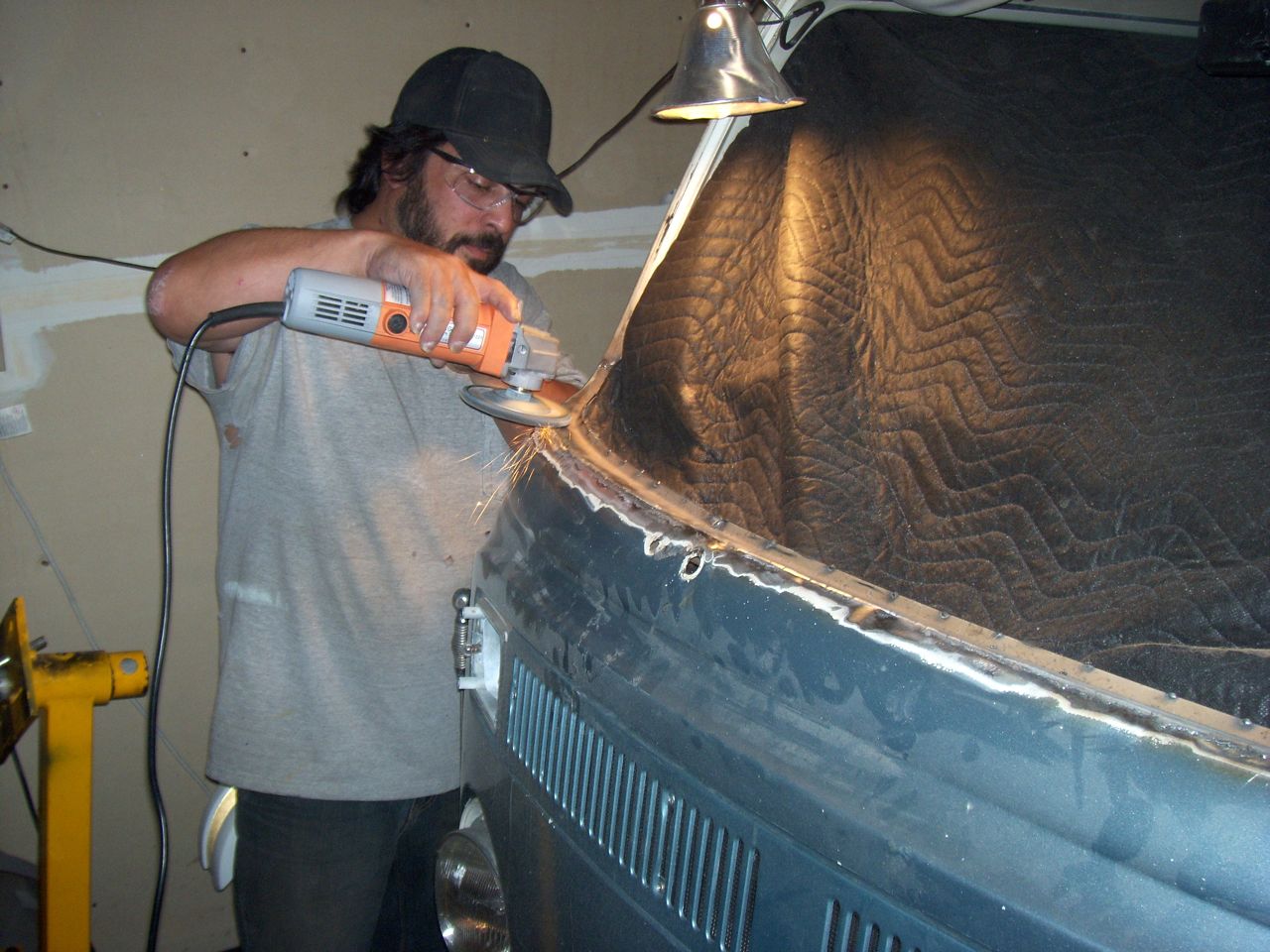

Alright, several folks asked for a follow up on this so here's where I'm at. Here's a shot of the repair just after the welds were all ground down and a nice coat of POR15 was added and then sanded.
Here she is rolled outside to check the sanding and filler work I did. Not much filler used at all. Everglass filler went on first to smooth things out and then a light skim of Metal Glaze to cover the pin holes.

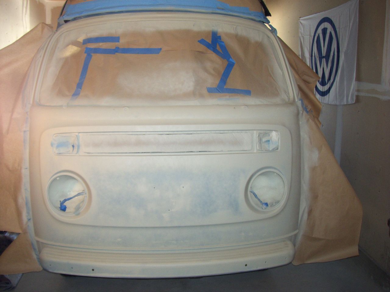

Here's how it sits now, with a nice coat of Epoxy primer. I'm waiting on a painter to come over and give me a quote on spraying the front panel. I want my bus back on the road!
