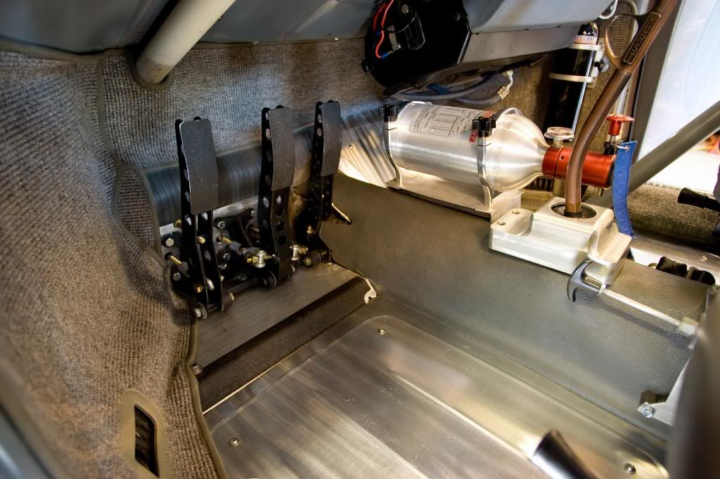

I had a SACO unit in my street car for less than a month. While the basic premise is sound-- the actuating arm for the tunnel-mounted master cylinder was a bit too "mousetrap game" for me. The hook that formerly pulled, now pushed and vice-versa. The bottom line for me is that clutch actuation was inconsistent and the set-up seemed more like a backyard rig than a nice piece of performance engineering/machining. The kit is now in my son's box of "robot parts" for future use. Installation, as stated earlier, is extremely hairy and painful.
I did, however, continue with the hydraulic clutch premise and installed a Tilton pedal assembly with push-rod actuated masters forward of the bulkhead and remote reservoirs. This was a night and day improvement, although it unfortunately made the SACO install seem like a picnic.

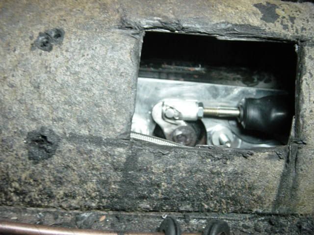

I tried the kit and although the quality of the components seem good, the whole deal just didn't work out for me:
* Unable to get the system to bleed
* Pedel to master cyl setup is funky. Needed to adjust the push rod out so far that it would eventually bind
* The instructions sucked ass! You need to be mechanically compitent to figure this thing out, just look and stair and figure it out. Far from Bolt-On
* Took a few days to install
In the end, I ripped it out and went with the clutch cable.
I still have the set available for cheap (minus the fluid line)
The good part is now I have a hole in the tunnel, so if my clutch cable break, I can install a new cable through the hole without having to unbolt the pedel assembly.
