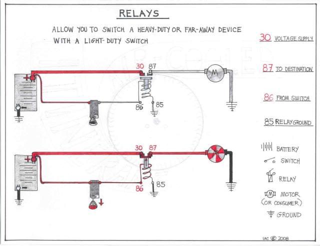

Relays allow you to switch heavy duty or far away devices with light duty switches.
In the case of the rear-engined VW, we get to instruct the starter to turn over the engine with a very light wire telling the starter relay to hook up the heavy duty battery cable with the equally heavy duty starter motor wire.
The convention with generic German car relay numbering is that the power supply wire is designated #30, the destination wire is #87, the instruction wire is #86, and the ground wire is #85.
Relays
http://i187.photobucket.com/albums/x133/73VW1800/Tech/IACRelay.jpg
In German car wiring diagrams, #30 is used not only on relays, but any time a wire is "hot". If your battery is hooked up and charged, expect full voltage at any #30 terminal you happen across. #15 is found wherever you get battery voltage when the ignition key is turned to the "on" position, that would include the #15 terminal on your ignition coil. #50 is used for any wire that receives voltage when the key is at "start."
So here is our generic, simplified double relay diagram with conventional numbering just for us. All the double relay does is two things:

Alas, it cannot be so simple. You will also see only little adherence to the German electrical system numbering conventions at the double relay itself. But if you compare the colors used in the above generic diagram to the colors below in the actual current path diagram of your Volkswagen L-Jetronic fuel injection system, you will see the simple functions of the double relay. The ignition circuit is colored in green and it instructs the *power* relay to provide voltage to the injectors, via the voltage dropping "series resistors", and the Electronic Control Unit. The starting circuit is colored in pink. It runs the *fuel pump* relay which supplies voltage to the fuel pump, and the Auxiliary Air Regulator.

Let's run you through the sequence: First, we turn on the ignition. Power relay gets energized and the ECU and series resistors have voltage. The engine is not turning though, so we certainly don't need a fuel pump just yet.

i see the 'simpified' drawing to show how a generic relay, when energized, will supply power to the various devices. his drawing shows that terminal 87 of the generic relay to be the heavy duty terminal. (as referenced by the preceeding drawing, explaining a generic relay)
it was probably unnecessary to number the terminals at all, since it is just a simplified drawing, like a block diagram. the more detailed drawings below show the correct terminal numbers, as those are not a generic relay, but the VW dual relay we know and love/hate.
makes sense to me Anxious
on the other hand lol, regarding the CSV and TTS, i was under the assumption that the TTS controls ground for the CSV; that the TTS is a temperature controlled switch that interrupts the ground circuit for the CSV. if the TTS is open, theres no ground connection and the CSV cant fire. this is not really shown in the drawing, it looks like they are sharing a ground connection. i dont know that its really necessary to fix the drawing, as the focus of the drawing was the dual relay and not the components, but if you were inclined to fix it, its just a small detail.
