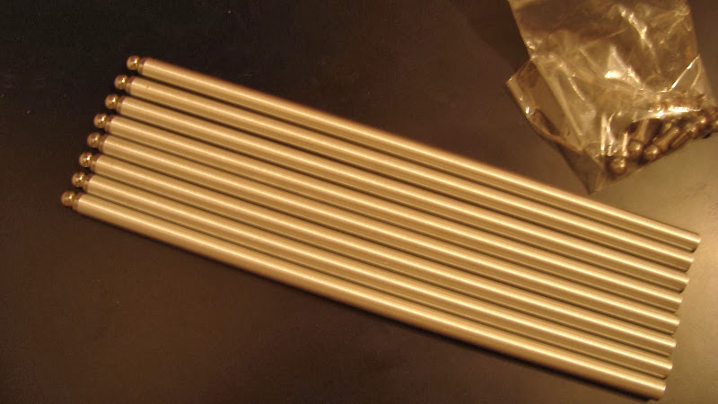

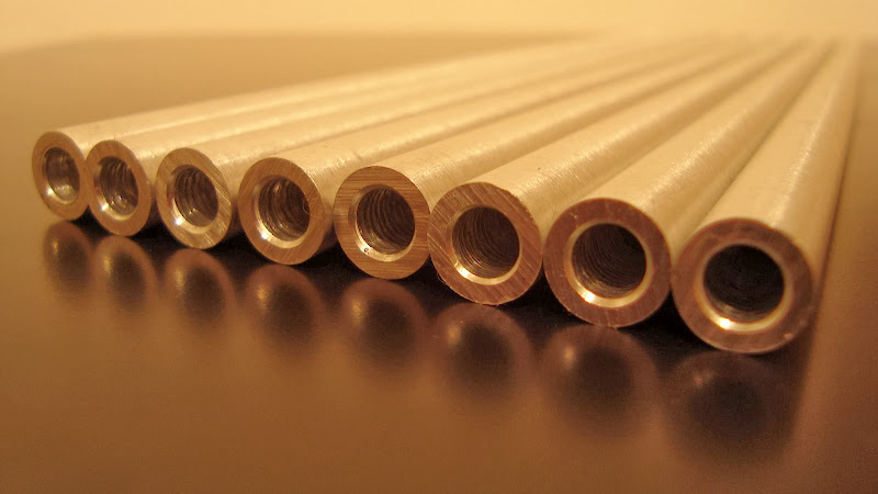

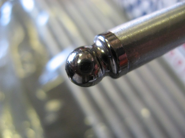

PostPosted: Mon Apr 06, 2009 2:41 pm    Post subject: Reply with quote
some pics of my freshly delivered AC.NET pushrods
enghof rambeling.
|82x94|

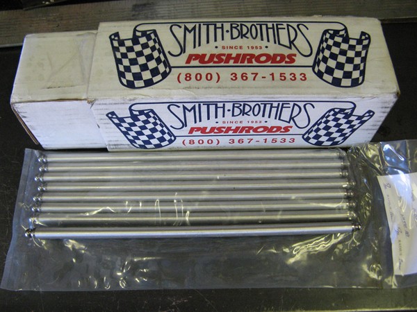

PostPosted: Mon Apr 06, 2009 3:15 pm    Post subject: Reply with quote
Joel Mohr wrote:
I believe those are the Smith Bros. pushrods, and I use them with LS1 beehives to 7200 on an 86c with Pauter 1.5s, no problems....
I'm with Joel on Smith Bros.I was asking about aluminun push rods on another forum and his experience with them sold me on trying them.Got mine around $103 set and are shipped to your requested over all length with both ends installed.I have them in two motors at this time, a 2276 with FK8, dual springs,a 2276 with W120 and duals.I was a long time chromolly guy until i tryed these. Awesome! Part numbers where
NA39B-BB 3/8th x .095 wall 2024 T3 Aluminum w/oil hole 5/32 balls.
