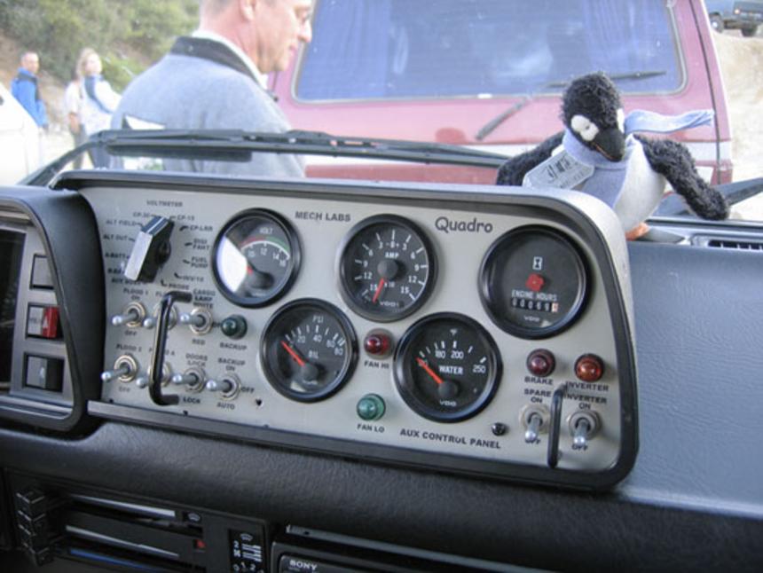

Here's a couple of 2nd dashboards by others
This one is by Blake Heinelin after he installed a Vintage Air Supercooler w/ heat/air/defrost all in one unit...result was effective according to Blake, but factory look and heater cover is lost.
Here's the link to his install blog.
http://blakeheinlein.googlepages.com/vanagon-airconditioning
This one I call " Ready for Takeoff"......I took the photo at Syncro de Mayo 2005 (can't remember the owner). It features an interesting rotary switch so that one guage can read multiple sensors.......
..... I'm hoping to make something much smaller.
Warren C
