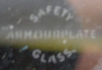

All the glass in my new zealand oval is made by a company called armourplate all matching logos so i am presuming it is original .
probably only fitted down this end of the world and prob wont turn up in the usa But will be about on some of the imported stuff in the uk i guess
Simon

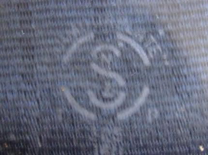

simon34
Joined: December 15, 2008
Posts: 66
Location: Rotorua new zealand
simon34 is offline
PostPosted: Fri Jan 23, 2009 7:42 pm    Post subject: Reply with quote
JorgeDavidson wrote:
Simon
Please Simon, post some Logo pics!! Very Happy
Here you go Jorge not great pics but glass aint that easy to photograph
all but one window has this logo.
The other one has this one same company different logo.
Simon
Simon
Thanks Simon! That logo is really new to me! Should it be related to Sigla Co. ? Think

Hi Simon,
Your car is certainly CKD assembled in New Zealand, as all glass is armourfloat
The S with NZ inside is the logo showing compliance with the New Zealand standard. The glass was part of the local content.
I believe these beetles were assembled with local Australian & German content.
Australian assembled beetles had very high local content & their glass has the Australian standard AS logo.
Cheers Ivan
