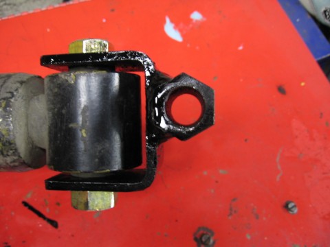

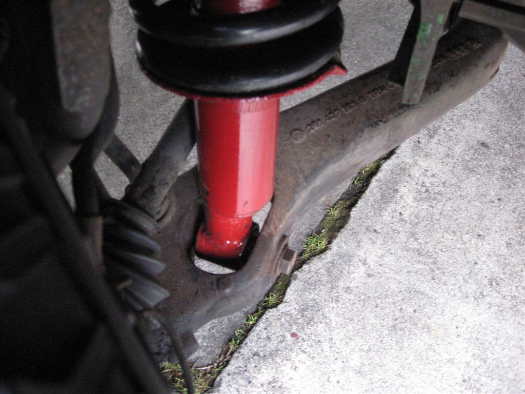

Well here it is, the revised 2" lift. Some of you may recall the "budget 2" lift". I have to give credit for the idea to Herman in BC Canada for the basic idea. I had to revise it to work.
http://vanagonsyncroproject-herman.blogspot.com/
Herman's idea was simple, create a tubular sleeve that slides over the lower portion of the front strut.
I made a pair only to find that there was no room for the driveshaft. What needed to be done was offset the lower addition to allow room for the driveshaft.
The Syncro in my opinion is limited in how high you can lift it. 2" is the absolute limit without modifying the suspension.
The rear is lifted with a 2" upper spacer and a shock extender.

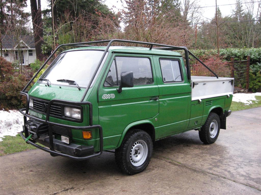

Before and after pics...
Shot of the lower front strut showing the offset.
Rear spacer and shock extender.

I like the lower shock link idea in the rear, looks easy to build sturdily. Any reason that wouldn't be a good solution for the fronts as well? It would be easy to add a slight offset to the front links to clear the driveshaft if needed.

That was version 1, only issue was that you are forced to raise the front a minimum of 2". By adding a section under the strut you can lift as little as you like. I think it looks better also.

Is there any chance that the rear shock mount might try to pivot and bend the shock's piston rod? I was thinking the rubber shock bushing might give just enough to throw the bottom out of alignment with the top. I'm probably wrong, but just a thought.

I ran that same setup on my Bundeswehr Syncro for over 4 years. The extender keeps the shock well lined up. It's the twist that does it.
