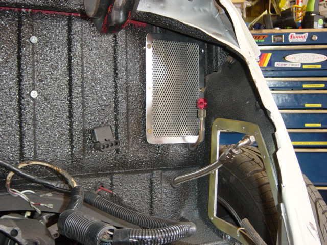

Has any one cut a window in the rear wheel well to access the spark plugs and make changeing the plugs easer when you are running dual carbs.If you have a pic it would help.Thank you

Thank you Glenn butI was thinking of something a little bigger so you could access the manafold nuts and take them off as well.

I cut an access panel maybe 6 x 10 inches in my 1970 sedan, to access #3 and #4 spark plugs, which were behind/under the AC compressor. I used a piece of sheet metal to seal that, with a hex head screw at each end to hold it. Maybe I can take and post a photo this weekend, PM me Friday.

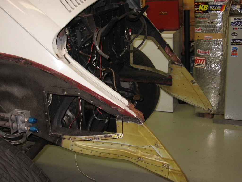

Can ya see them winder's in there????

My access window was similar to that posted just above, but he did a nicer job.

http://ebasic.easily.co.uk/01101C/024024/hipacshowto.html

I'm running the HiPacs from the previous post and they're extremely well made. All the Hooky's Panel Shop bits are great.
