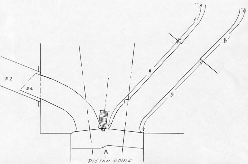

From the great Bob Hoover "The stock Volkswagen cam uses
less lift for the smaller exhaust valves. (Maximum effective lift is
PROPORTIONAL to valve diameter. Any greater lift simply increases the
engine's wear whilst decreasing efficiency.)"

Bob is referring to was what David Vizard calls 'curtain area', as illustrated by the following picture (the area in red):
The more curtain area you have, the more you can flow through the cylinder head (to a point). This explains why 4 valve heads are so much better than 2 valves, since the curtain area is doubled. More lift is only beneficial so long as flow is increasing, once you get to a certain point it makes no sense to open the valve any farther since the gains to be had are negligable.
