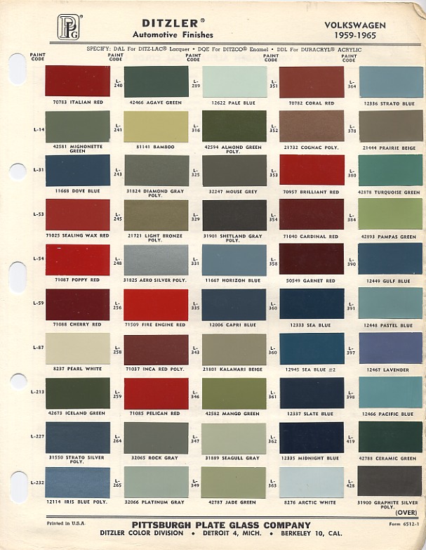

PostPosted: Tue Apr 21, 2009 6:39 pm    Post subject: Reply with quote
sorry no scanner, and pics did not come out clear. I did see a scan online somewhere of the same sheet, I will look for it.
As far as the difference, sea blue 1 looks more like the third bus, where as sea blue 2 looks more like the first bus. The nasty smurf blue is more likely a variation due to exposure.
Edit: I noticed there are two different PPG codes for the different chips:
Sea Blue L360 PPG Code: 12333
Sea Blue 2 L360 PPG Code: 12945
On the back it shows years that specific colors were available.
Sea Blue L360 1960-1966
Sea Blue 2 L360 1963-1967
From what I have seen in person, every sea blue/white bus has been sea blue #1. Every Sea blue #2 has always been on a 65 and later type I. I have never seen Sea Blue #2 on an ORIGINAL paint bus. I have seen several restored/repainted type II with the sea blue #2.
BTW did early bus use Blue white L289 for the top of early sea blue bottom and cumulus white L680 on later sea blue? If this is true could the change in the top color reflect the change in the bottom blue (between #1 and #2)?

Found the image
Here is the link to the site with the image.
http://www.tcpglobal.com/aclchip.aspx?image=1960-volkswagen-pg01.jpg
It has a magnifier so you can see it better.
I have to say, comparing the image with my chip sheet it is VERY close (on my monitor).
Hope it helps
derluftwagen, thanks for your detailed response, this is very helpful indeed Smile
I'm still confused - the quote above seems contrary to the colours on the chip...
You say Sea Blue 1 looks like the third bus pictured, which is lighter, bluer... which to me would correspond to the Sea Blue 2 colour chip better than the Sea Blue 1 chip (which looks darker, greener) Question Question Question
You will have seen more original paint sea blue busses than me here in Australia - how can you tell if they are 1 or 2 without the PPG code???
And please post more Sea Blue porn if you have any! Wink Laughing
Thanks again Cool

Another paint swatch, indicating Sea Blue 2 to be the lighter...

I have an original paint bus- a 66 deluxe with the aero papyrus interior. It is closest to the sea blue , not the sea blue 2! The top is cumulus white.
