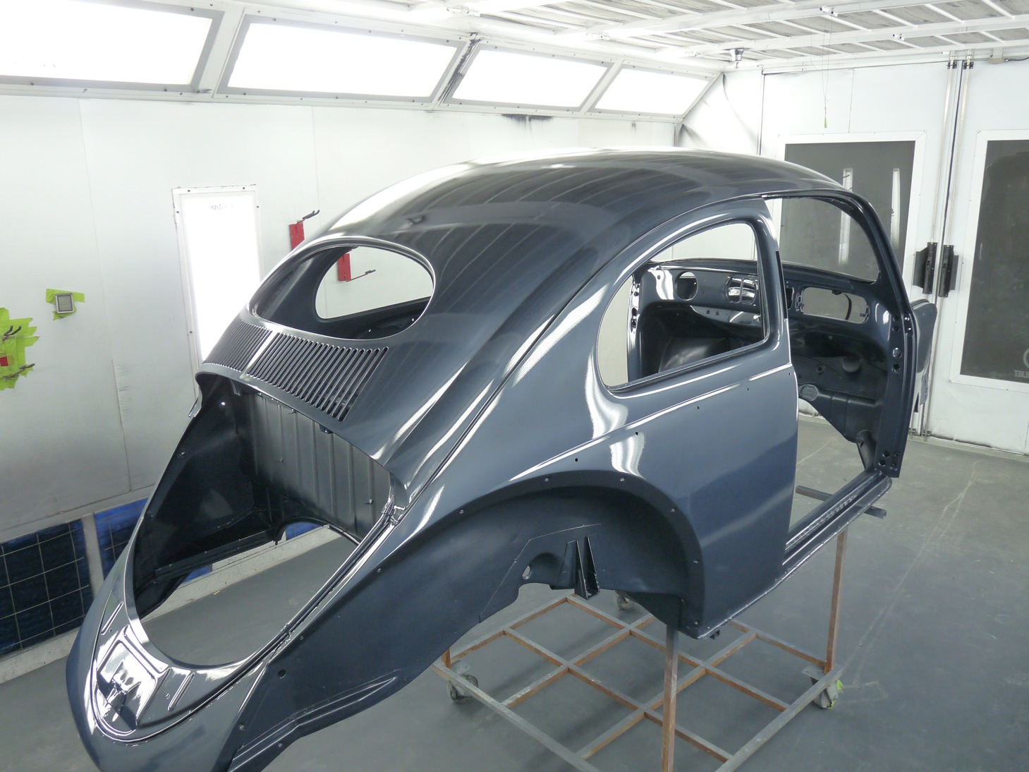

Hello, I hope an someone can help me out here. I have an early 53 oval in metallic blue that at somepoint has been painted black on the outside, the inside is original.
The black has been stripped off as there was microblistering. only a very small amount of original paint was left under it Sad
I need help with obtaining the colour recipe/ingredients etc to repaint the outside. I have searched several forums but cant find anything much except a scanned page from a vw book. This has some numbers on it but nothing relating to their meaning.
Thanks in advance! I want to get the paint right as its such a beautiful colour!

I hope this helps you Smile
VOLKSWAGEN - AUDI L35 1953-1953
METALLBLAU MET
Glasurit Line 90 Step: 1 / 1 1.00 ltr
Base Amount Cumulative UNIT
M4 678.4 678.4 g
M99/00 25.6 704.0 g
M99/02 11.3 715.3 g
A531 189.6 905.0 g
A997 39.7 944.7 g
A329 38.3 983.0 g
A640 11.9 994.9 g
A105 11.0 1005.9 g
A427 7.6 1013.5 g
A032 1.2 1014.6 g
Formula Date 2008-11-07 MSDS AJ9020
Price Code II

Very Happy Very Happy Very Happy Very Happy THANK YOU Very Happy Very Happy Very Happy Very Happy I thought I ran into a wall with this one I love the colour but it was impossible to get the mix

Now that...Is an awesome color. I like, I like....

Ha, good memory Bob. Looks better together though Smile
