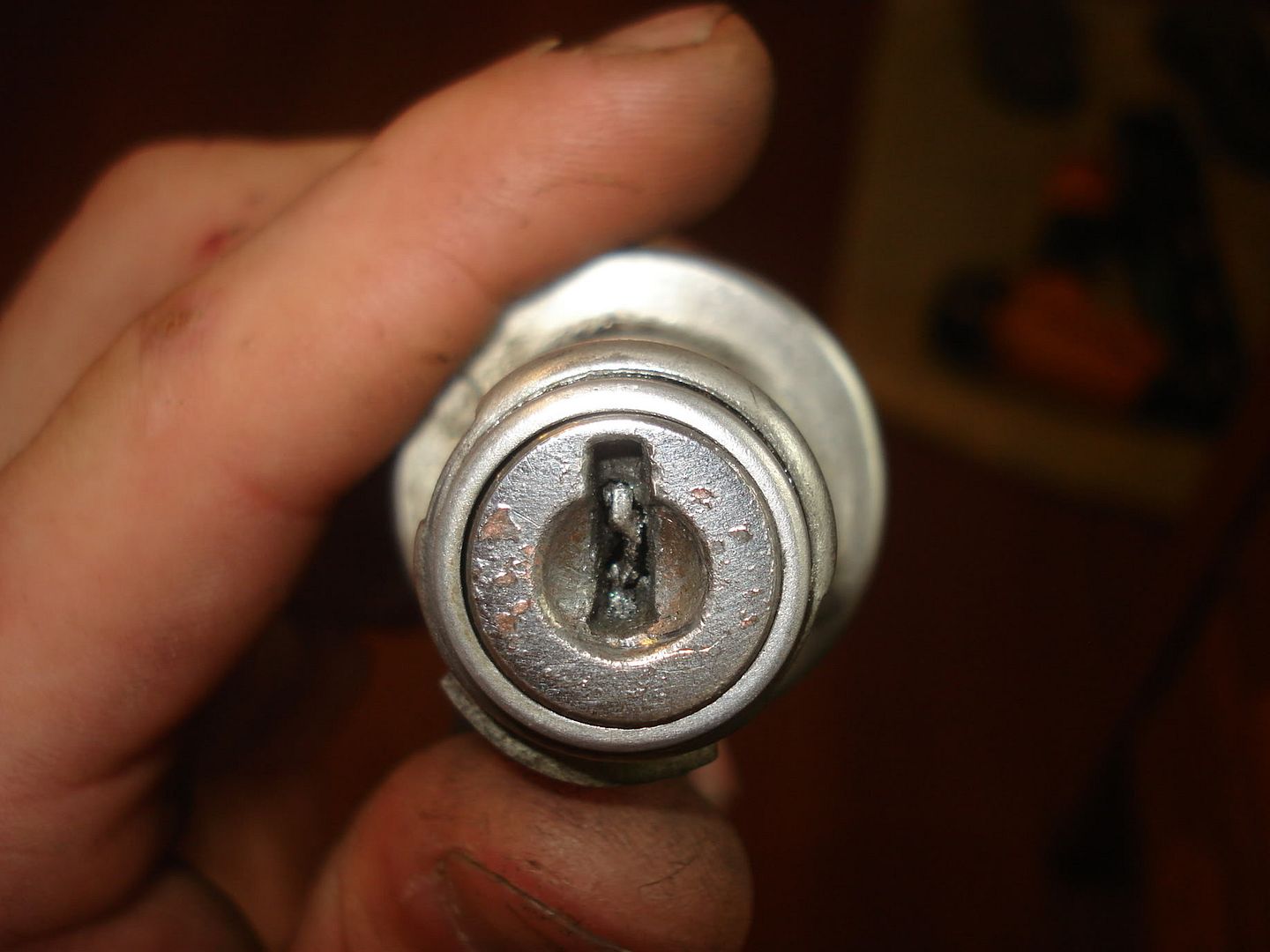

Right now my key is broken off in the ignition switch, luckily I've been able to turn it with a screw driver but I need to pull this guy out so I can weld the key back together. Do I have to open up the tabs on the back of the switch and disassemble the barrel to get it out? I'm not looking forward to taking it down to the springs and barrel pins. Confused

Post a pic of the other end of the switch. Some can be taken apart, some can't.
I wouldn't go to your local locksmith. What does he know about a VW lock? Is he familiar with how to disassemble a 50 year old VW switch?

Either send your lock to Gabriel, or post a pic of the other end and let me tell you all about it.

Here's the backside of the switch, and one of the 3 tabs that hold the back onto the case.
This is an EASY fix.
Forget about the 3 small tabs holding the black plastic part in place. If you try to bend them out, you will destroy the whole thing. Besides, it won't come apart even if you did it that way.
Instead, have a look down the center bore. In the center is a silver bit. That's the back end of the lock cylinder. Look closely at it further in. There's a small wire clip holding it in. You need to get that clip out. I use an old dental pick. Anything really pointy will do. Once you get that out, the lock cylinder will come out the other end. Then you'll have access to be able to push the busted bit of key out. You can also take the opportunity to clean up the 50+ years of dirt and gunk, then grease it up when you install it.
On the center backside of the switch Bruce?

Russ
Joined: January 12, 2003
Posts: 1560
Location: Langley B.C.
Russ is offline
PostPosted: Thu May 14, 2009 9:16 am    Post subject: Reply with quote
^^^ pretty sure yes John.
some i believe have a little clip and some are a squished rivit (i think)
don't quote me on that though.

Russ's right, John. The relatively rare Bosch ignition switch's lock cylinder is riveted in place. Taking it apart then reassembling it would be difficult.
All other switches are like the one in the pic above. Here's what it all looks like when taken apart. The wire clip locks in the groove indicated:
