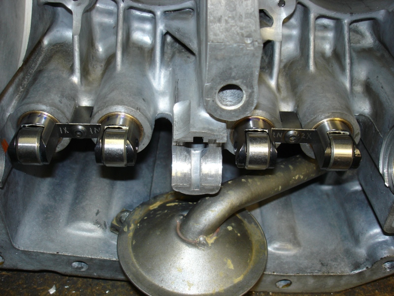

Awesome...thanks for the info Joe...do you have any pics of completed engines, saw your gallery pics on the case and crank.
Thanks!

More pics and info here:
http://rockyjennings.com/
Thanks!
And pics in my gallery as well. The wasserboxer case is an excellent base for that "stroker you want to live forever" to "as wild as your mind can dream." Yes, the premium up front is a bit daunting, especially compared to the Brazilian aluminum cases, but 1) you are paying for quality, American machine work, whether that be Rocky's work or Joe's work, and 2) the quality and strength of a die-cast alu case is beyond anything cast in sand. I don't regret the investment I've made; it's been a fun project to say the least. If you've got the budget, or the discipline to save your money, do it!

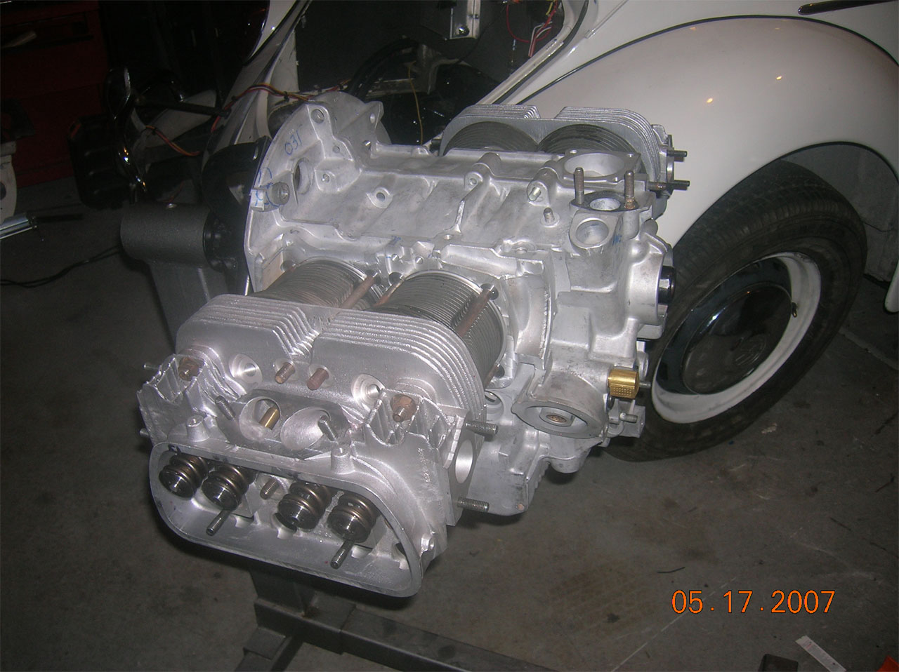

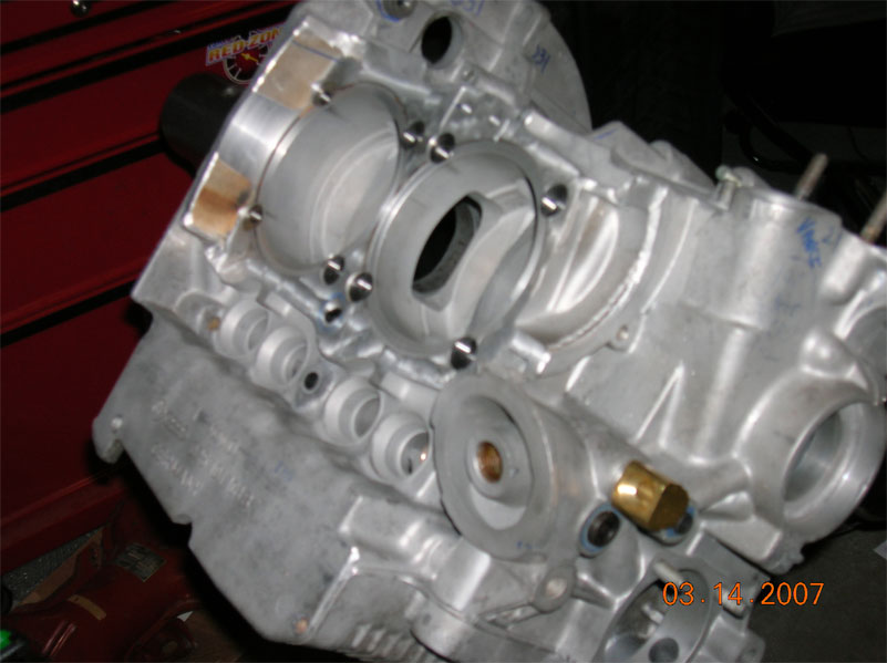

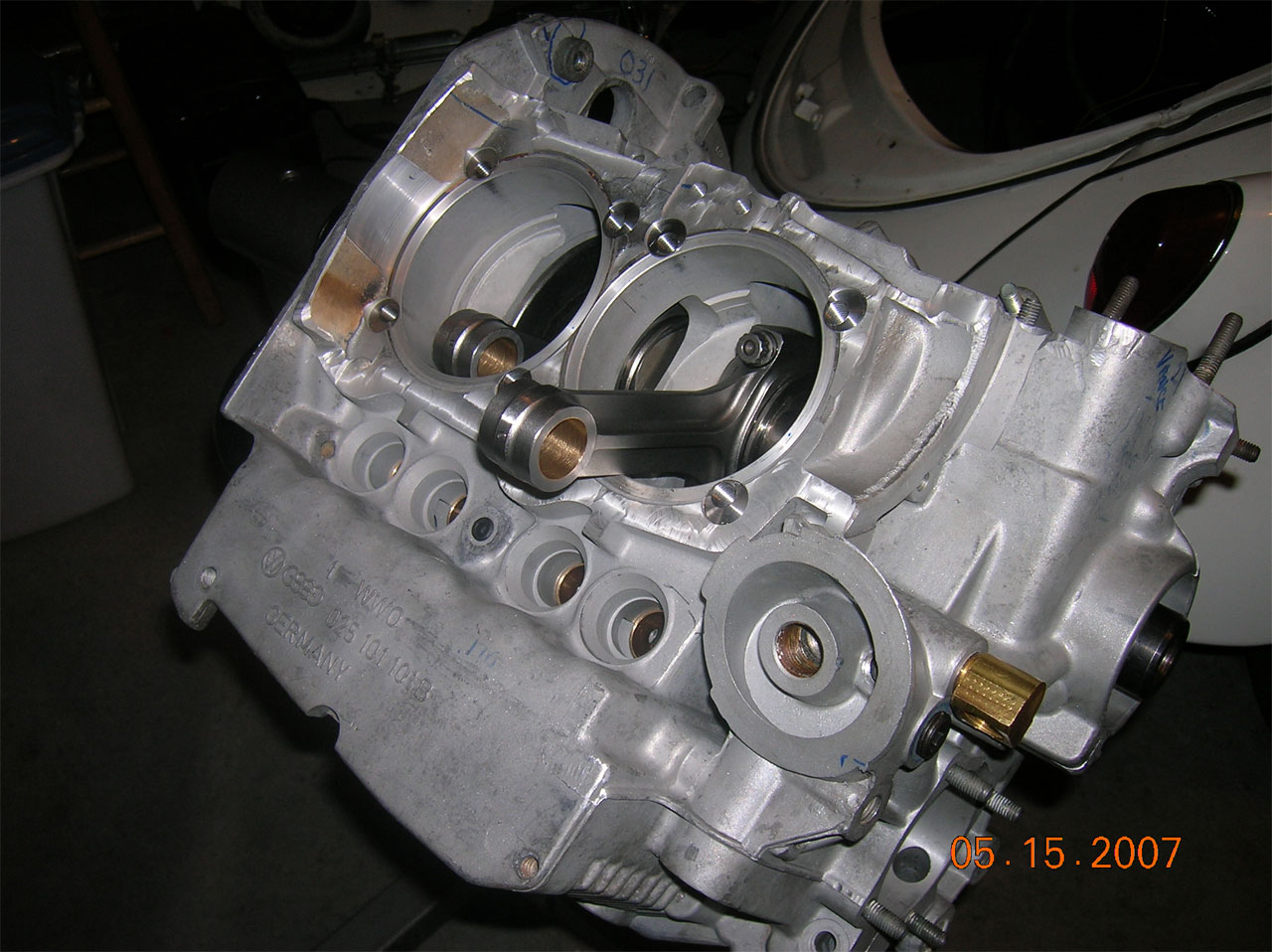

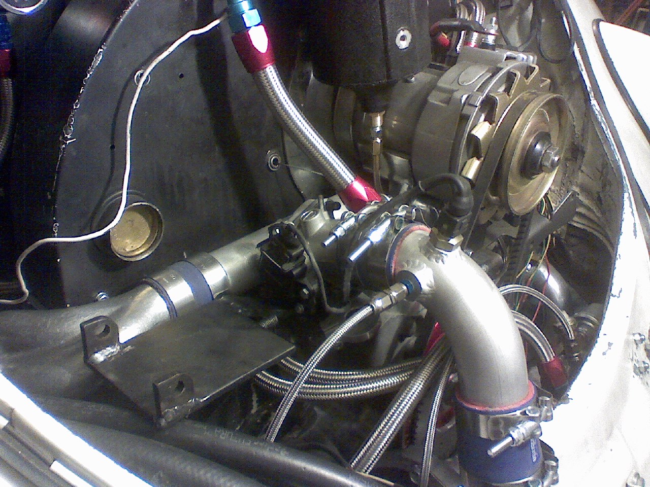

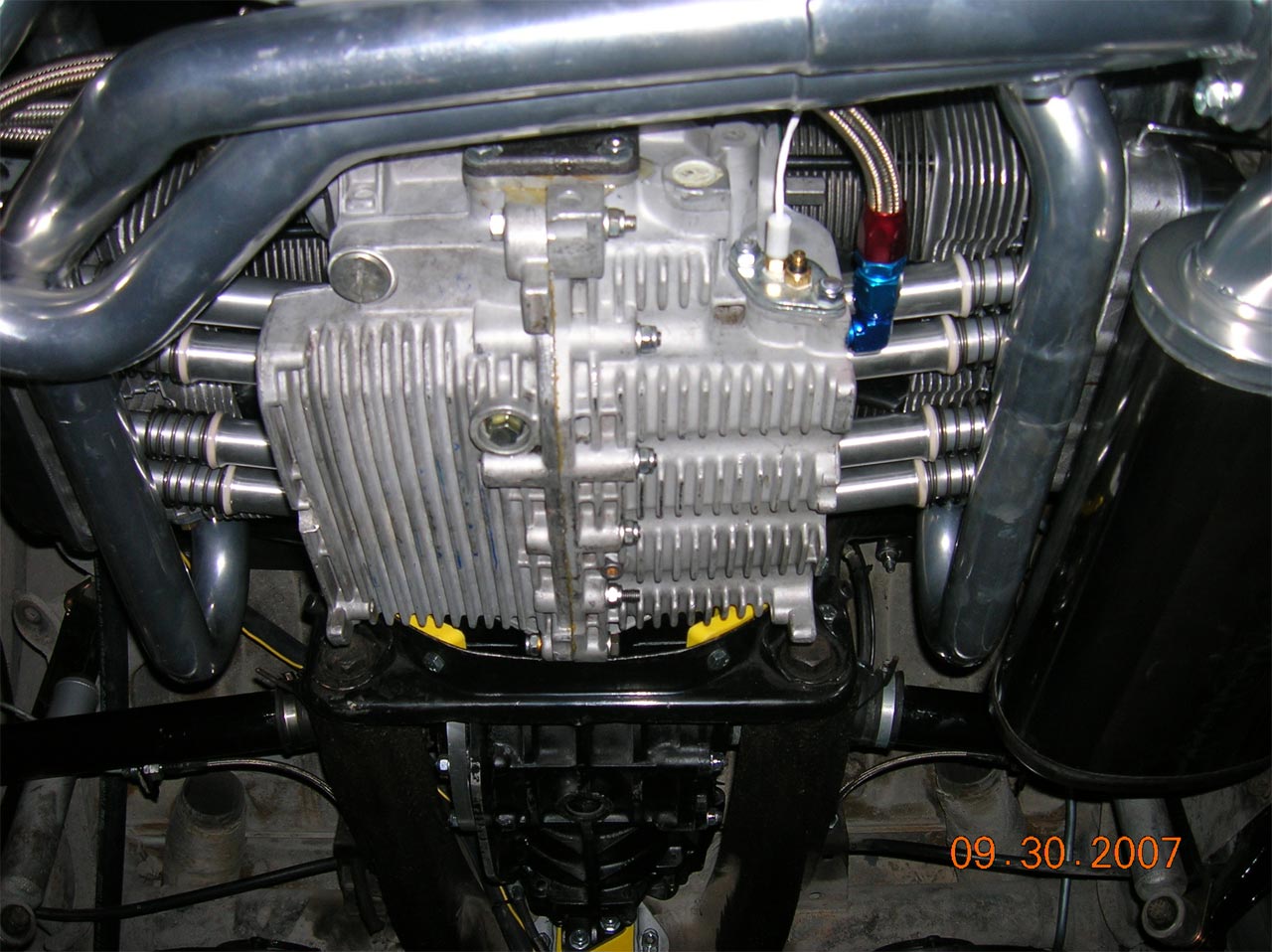

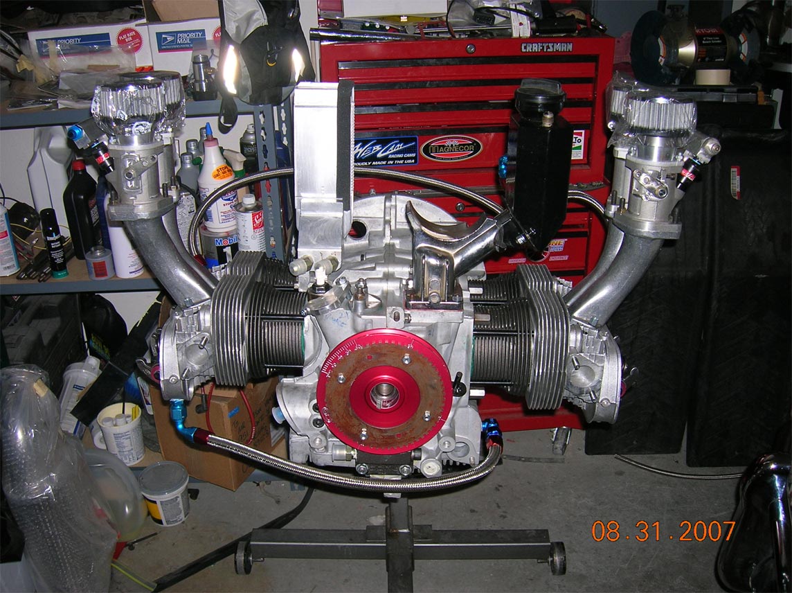

PostPosted: Thu May 07, 2009 7:39 pm    Post subject: Reply with quote

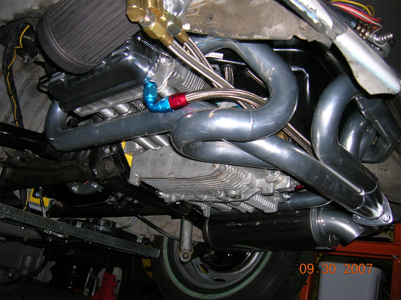

Back when it was normally aspirated...
Now it has a little help to breathe (poor images, I know Sad )...

PostPosted: Thu May 07, 2009 7:49 pm    Post subject: Reply with quote
damn I love the looks of that case!
