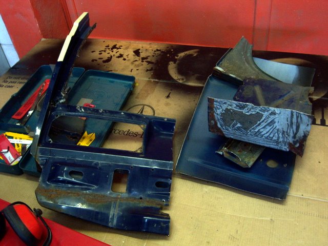

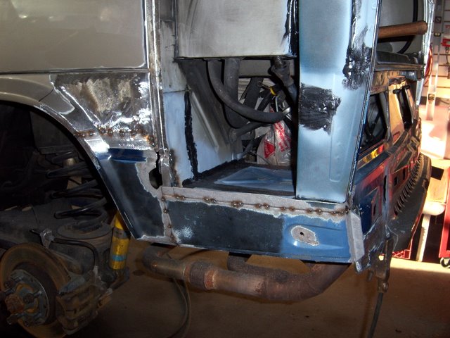

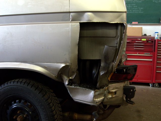

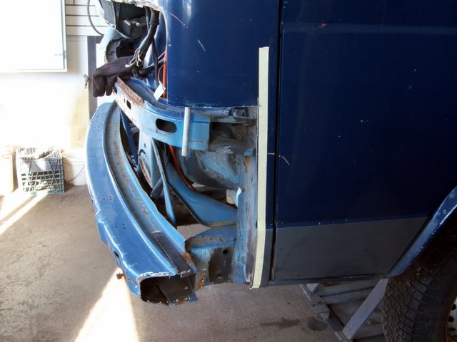

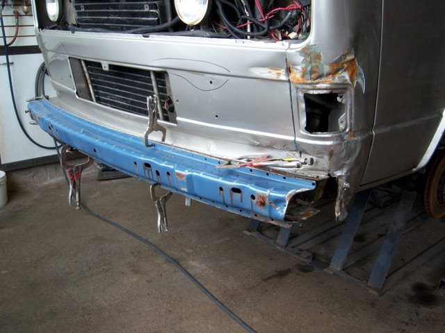

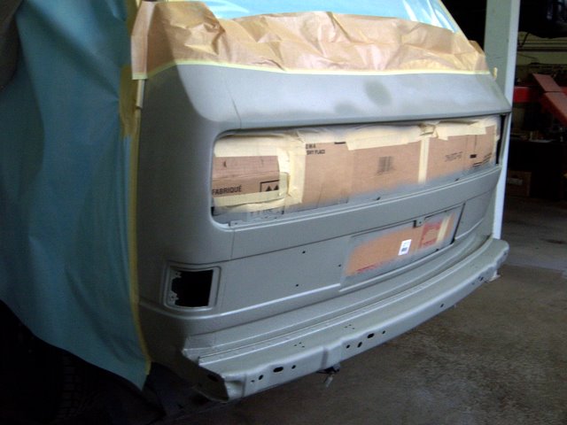

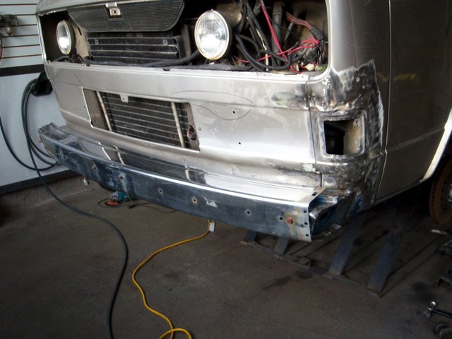

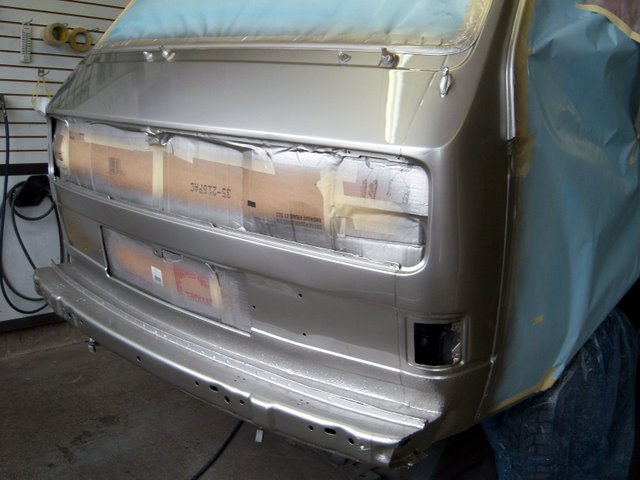

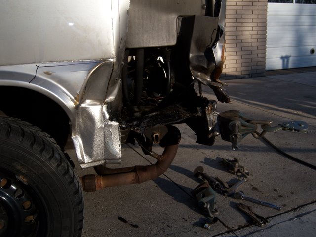

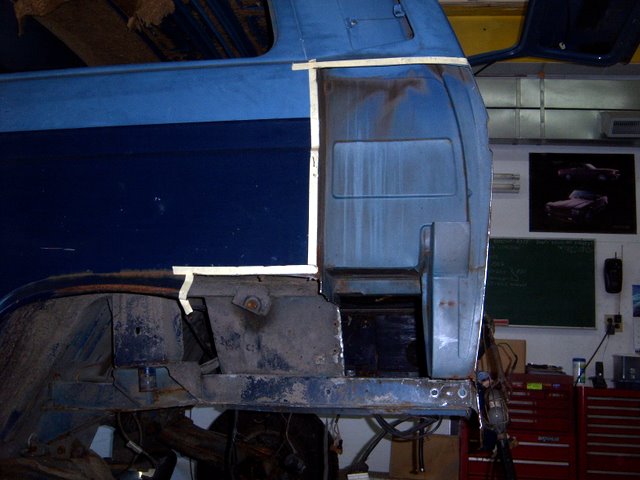

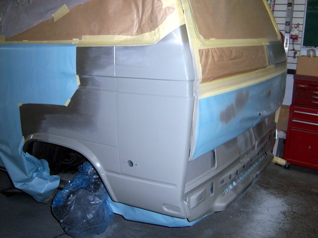

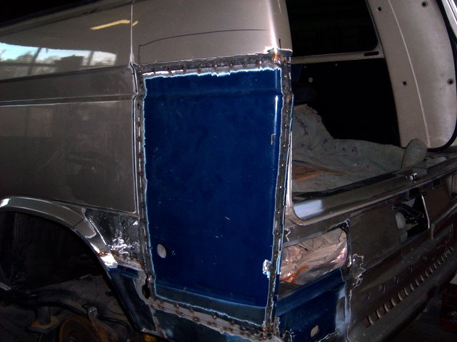

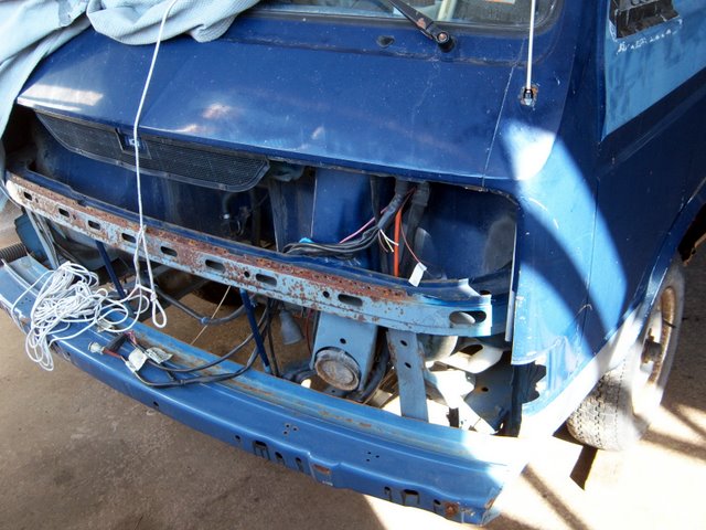

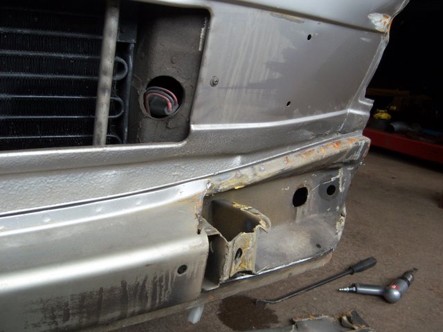

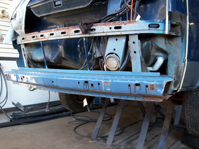

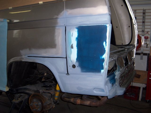

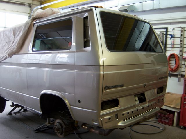

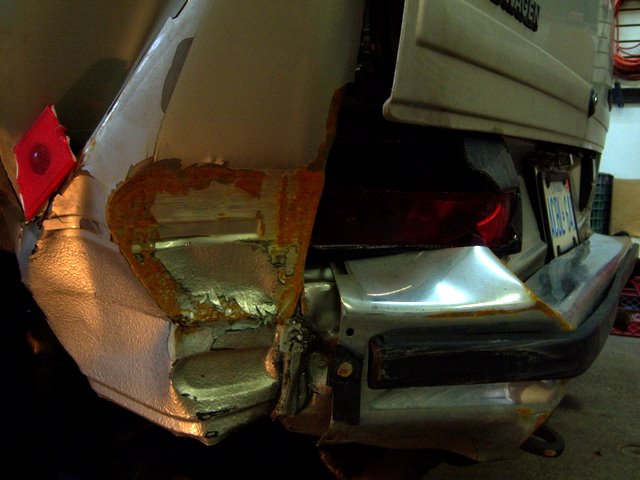

Thought I'd share a happy ending to a mishap past winter. It was a close call deciding whether or not to fix it, but the bus won. Anywho, here are some pictures of the repairs.
Enjoy!

Cut,chop___rebuild. Nice and clean. Very straight.

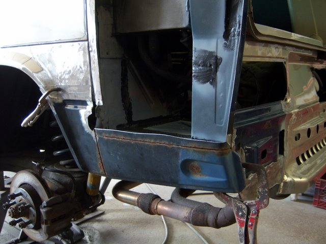

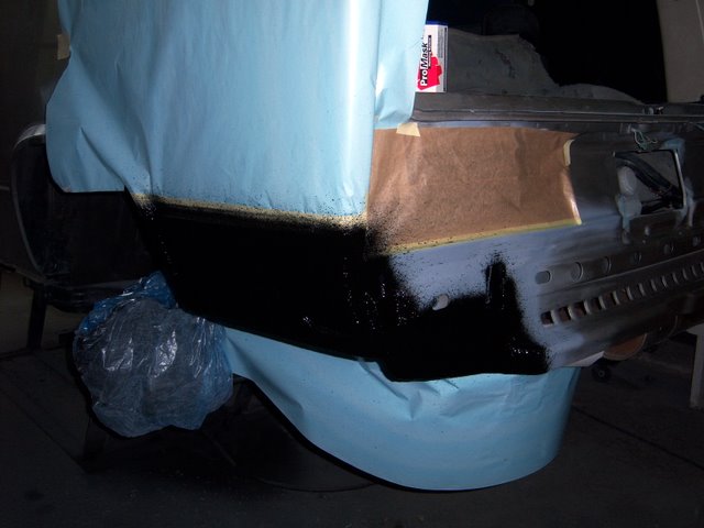

Don't forget to seal the air drop vent on the "inside". Any untreated weld there can come back and get you.It's still exposed to the outside.

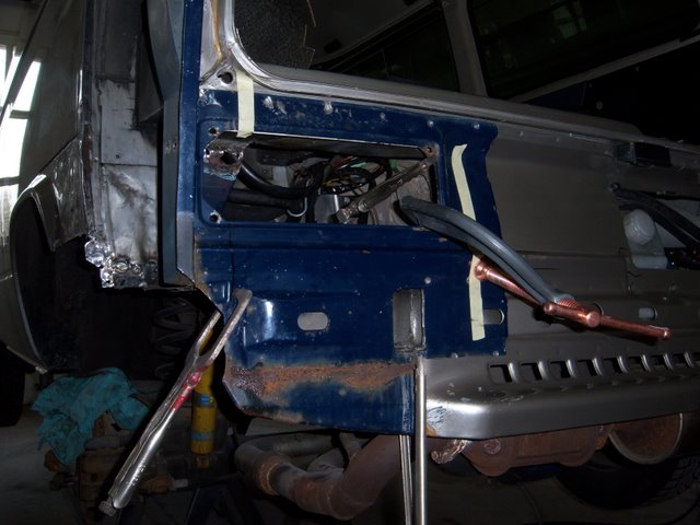

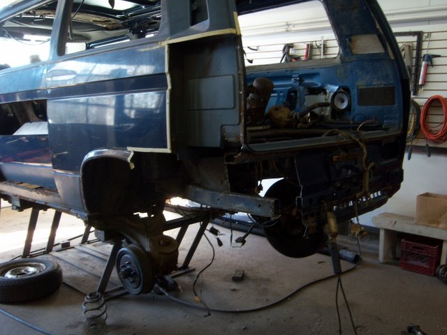

Question: In the 3rd picture from the bottom, how did you "blend" from the new paint to the old paint, not at a seam? It looks great, and it blows my mind that the whole panel wasn't repainted.

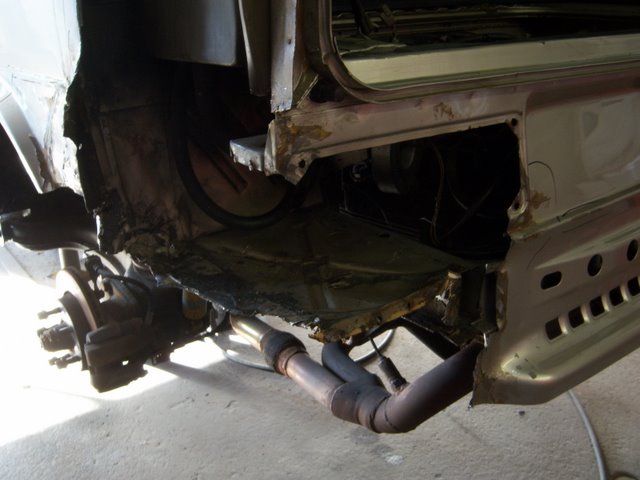

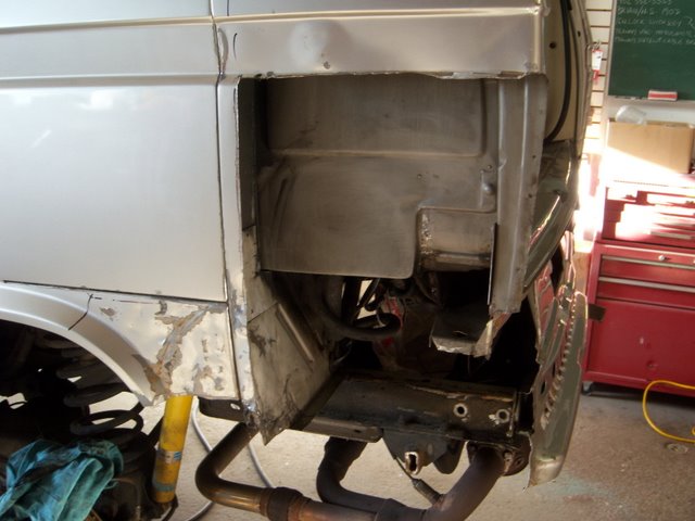

Looks nice! This gets me fired up to fix the nasty dent on the front corner of my van that's been there (and covered up by a bra) since I bought it. I have a welder...and some big hammers...how hard can it be? Shocked

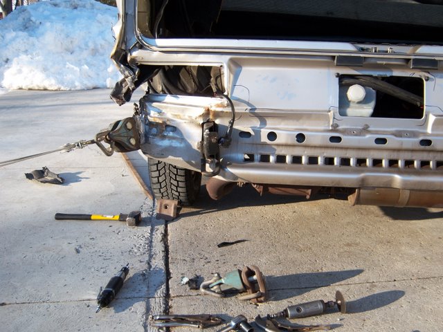

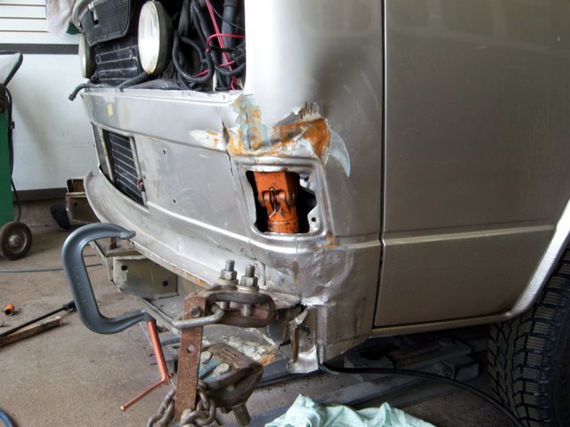

So can you give some more details on the process? Not sure if I'm interpreting the pics correctly, but it looks like you started by trying to pull out the bashed-in areas, then decided to just cut/weld in new panels?

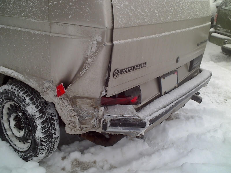

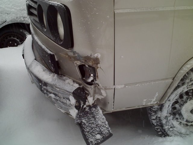

I did not report the accident to insurance in part because it was technically a single vehicle accident so it was either pay for the repairs now or through increased premiums. I was cut off by a speedy SUV in snowy conditions forcing me to brake and lose control sliding over 4 lanes into a conrete barrier. The driver of the SUV did not stop. I really think its time for me to buy a winter beater and spare the van of any more precarious situations like this.

Thanks for the advice. All the seams were treated with seam sealer and given a good soak of rust-proofing oil.

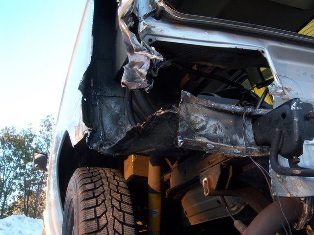

Pulling panels and metal that have been pushed in relieves stress around the area to certain point. Its amazing how the metal pops in to place as you are pulling panels back to its approximate original location. The extent of the damage did not stop at the bashed-in metal, the energy of the impact transferred along the panels, bending it. But the more you work at it, pulling, cutting, pull and cut some more, eventually the straighter areas returns to 'memory', somewhat.

I've excluded lots of other pictures that shows this but the whole rear quarter panel was prepared and sanded right to the vertical seam, then painted. Seams and abrupt bends are good places to hide overlap.
