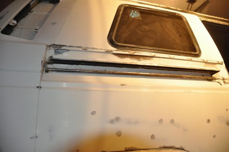

Ok, so i had been reading about the infamous $50 roller paint job on the internet and decided that since my van was a rusty beater, i had nothing to lose by trying it. The first thing i did was spend days and days reading about it to make sure i knew what i was doing, and then off to the store to buy the paint. I went with the Interlux Brightside sapphire blue, which goes for about $35 a litre. By the time i bought brushes, rollers, tape, trays, thinner, sandpaper, etc i probably spent around $300 on the whole setup.
So heres a couple before shots
Prepping the van was definately the most time consuming. If you had a van with only minor or non-existant rust, painting would be so so much easier.
Anyway, heres the cancer
And after hitting it with the wire wheel
before
after
After hours and hours of wire brush, sanding Por-15, and body filler, shes ready for paint. It took a while to figure out the rolling technique, but eventually i got it down from 7 hours to 2 hours for the last coat. The self levelling properties of this paint are amazing. With the right technique it just goes on so well.
first coat, going on thin but starting to look blue!
second coat
third coat
fourth
fifth
Put everything back together just in time to go on a 12000km road trip, heres the finished product. The only thing i wasnt really satisfied with was the bedliner i put on the bottom, i only put one layer on and its still a little see through, but thats easy to touch up later.
Overall, it was a great success! Basically i was never planning on doing a super involved restoration, or anything, since this is my daily driver, and it gets driven hard, shuttling mountain bikes on logging roads, camping etc etc and it is by no means perfect. Im sure in a few years the rust will come back, and if you look closely you can see a few places where the paint ran. I definately cut corners (just masked the windows, etc instead of pulling them) But overall considering i had zero paint/body experience before this project, i am very happy with the results. Im proud of how it turned out, much better than the rusty, dinged up beater that it looked like before.
Ive had it on the road for around 13000km now after a 12000km trip through the backroads of the US and mexico, and the paint is holding up great. There are a few chips here and there where rocks have hit the body, mostly unnoticeable but the beauty of this paint is that its super easy to touch up in the future.

yes, this was one of the sites that motivated me to paint my van. The best part about this is that hundreds of other people have gone through the exact process with the exact paint, so all of the questions i could possibly have had were already answered in the various threads on moparts and other car forums.
koolmoe wrote:
And is that a GoWesty bumper, homemade?
No it was just ordered off of van-cafe for around $125 i believe. It was painted black and now i plan on budding bedliner over it for some grip when climbing up to put stuff on the racks.
Oh yeah, and no clear coat. And i did the roll and tip method, rolling the paint on with one roller and then following with a second roller to pop the bubbles. Though to be honest after i got the paint/thinner mixture right it pretty much just rolled on in one go.
And as far as the door jambs go i just rollered or used foam brushes. I was mainly concerned with stuff that would be visible from outside, so when you open the doors you can see the old colour inside, on the a-pillars and whatnot. I though about doing it all but it just wasnt worth all the time
