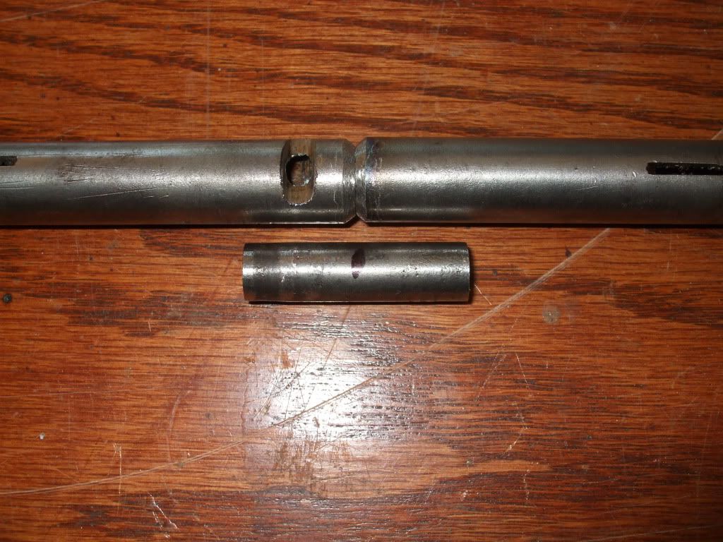

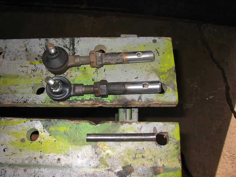

Alright guys. I shortened my tie-rods today. I welded mine. Although I could have reproduced the grooves and bolt relief on the ends, I liked the stock ends and wanted to keep them. Like Vdubtt, I have thought that there ought to be some fairly standard numbers for shortening tie-rods per narrowed front ends, i.e. 4" narrowed front end. I searched quite a bit and did not find much on the subject. Here are the numbers I came up with and how I came up with them.
For a 4" Narrowed Front End:
Remove - 1 3/16" to 1 1/4" for the short Tie Rod
Remove - 1 1/4" to 1 5/16" for the long Tie Rod
Overall Dimensions after cutting -
Short Tie Rod - 7 7/8"
Long Tie Rod - 22 5/16"

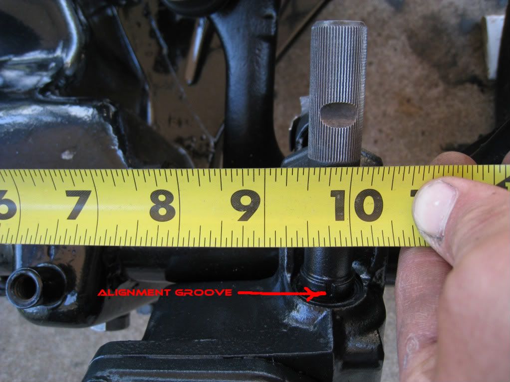

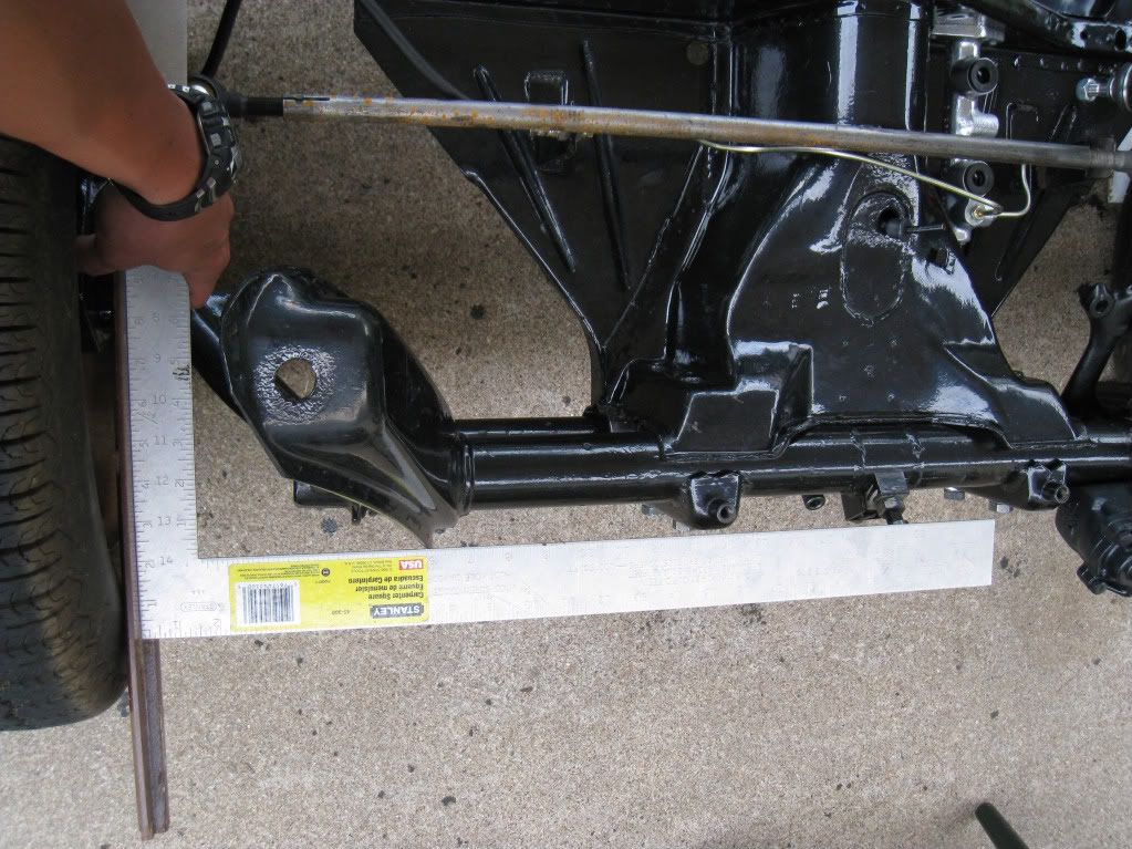

One thing I never saw anyone discuss was the set-up prior to shortening the tie rods. Three things have to be constant before you can decide on a number. 1) The alignment of the wheels has to be somewhat straight. I picked the front beam as my reference. 2) How much thread engagement you will have for your B/J's in the tie-rods. 3) The location of the steering box on the beam. IMHO, the best reference for this is the center of the tunnel.
The first step was I straightened each wheel 90 degrees to the beam. This is NOT an alignment I would drive with. This was soley a CLOSE reference picked as a constant for shortening the tie-rods.
Then, I decided where the steering box needed to be. I reqested this information from some folks with stock beams in another thread on the forum in preperation for this job. This is really more important to guys/gals with the body off like me. With this information, and taking careful measurements from the body of the car, back to the chassis, again...and again....I finally decided (at least for my car) the center of the input shaft of the steering box needed to be 9 7/8" from the center of the beam/tunnel. This results in a dimension of approximately 10 1/8" from the center of the beam/tunnel to the center of the mounting clamp of the steering box. With this dimension set, the pitman arm vertical, and the alignment groove in the input shaft facing up, I was ready to move to the next step.

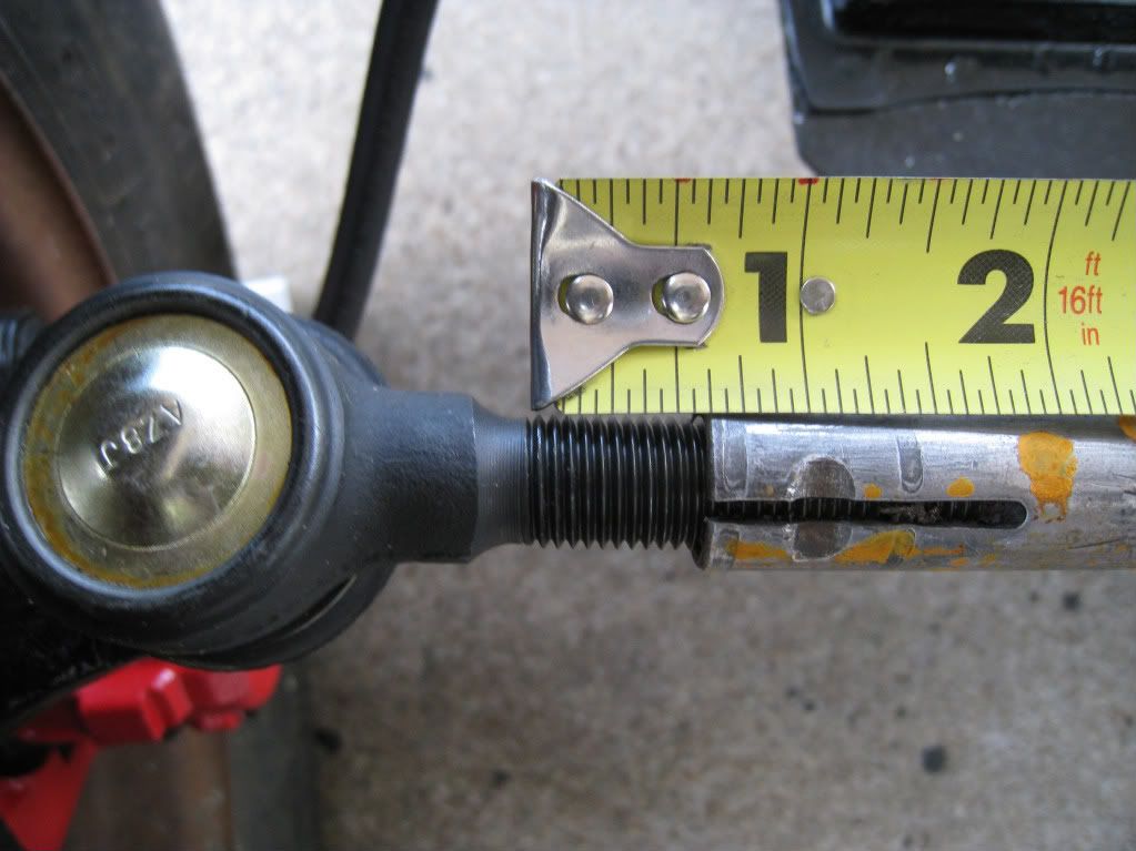

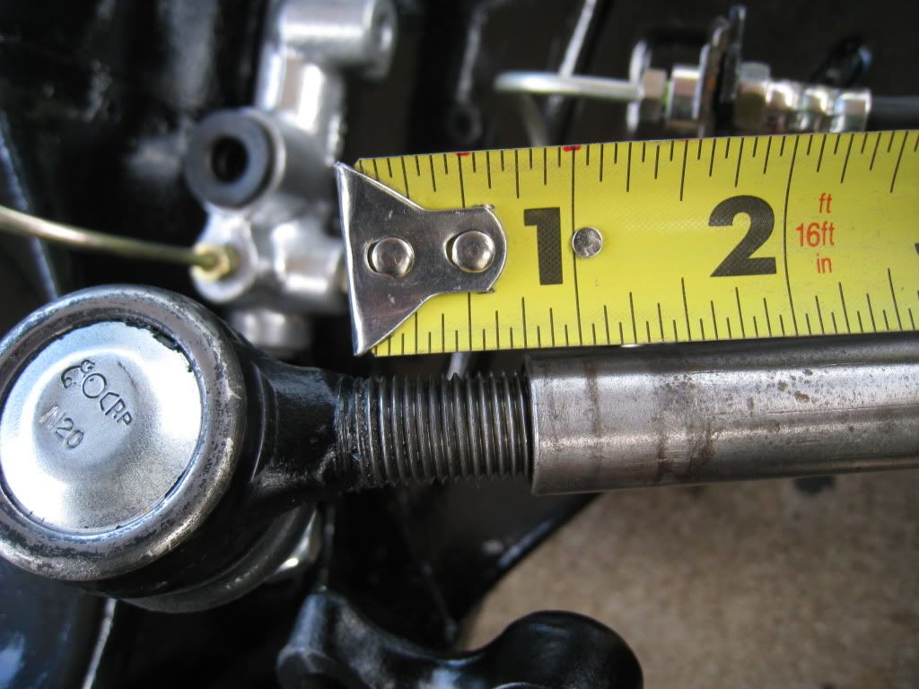

Next, I decided on a thread engagement for the B/J's. I looked at the pictures I took while tearing down the bug for this rebuild to try to determine how much thread was sticking out of each tie-rod on the aligned front end. Each one looked like 1/2" to 3/4". After much thought and screwing the B/J's in and out, I finally picked 5/8" thread exposure for each B/J. This appeared to be a great compromise if the B/J's needed to be screwed in or out for actual alignment adjustment later on.
The only exception to this was the inner tie-rod on the short end. For some reason at 5/8", it was very close to bottoming with no deeper adjustment. I gambled here a little. If I would have had a tap, I would have tapped it deeper. I didn't, so I went to 3/4" thread exposure and banked on my "alignment" as being fairly close. Call me dumb, but I'm willing to gamble that my front end will be fairly close to aligned. Worst case, on this wheel (driver's side) if there is a need to run the B/J deeper in the tie-rod, I will tap it then. I guess I'll just have a tap handy when I take her to get aligned Laughing
With these three things done, I decided it was time to try to measure what the distance from the inner B/J's to the holes in the pitman arm acutally was. This length would be how much the tie-rods would need to be shortened. Well, let's just say with all the angles...and not being able to actually get the B/J's in the arm, there is no way to get an accurate measurement. It's a little hard to explain here, but trust me. Each little movement of the tie-rods either up, down, or side-to-side caused drastic changed in the measurement (Trig). What I decided to do was to cut down the tie-rods in the center incrementally until I could finally insert the B/J's in the pitman arm. This was a little time consuming, but in the end it worked out. I found a piece of chromoly tubing to insert in the tie-rods and hold them in place during the fitment stage. Here is a picture of the tie-rods in place, cut in the middle before I disassembled everything for welding.

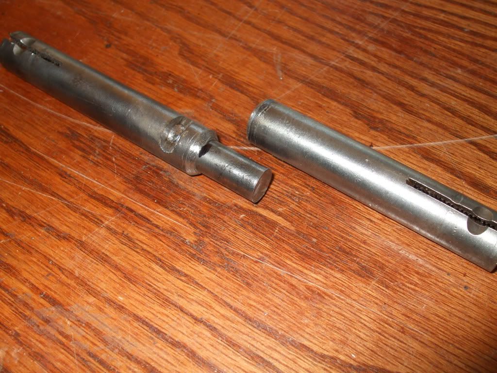

Here is how I welded my tie-rods. I found a bolt in the shop that was the exact inner diameter of the tie rods. I cut and fitted a length of bolt inside each tie-rod and then slotted the tie-rods on each side, 180 degress out from each other. Then of course I veed the ends of the tie-rods for welding.
The bolt could not have been a better fit. I had to lightly tap it to get it inside the tie-rods.
Another shot showing fitment and groove for welding.
A little grinding and filing and Boo-Ya!! Shortened tie-rods....cut to fit my car.
Another Pic.
Hope this helps somebody out there. Again, to me it was important to start with a baseline. Wheel "Alignment", thread engagement, and steering box location needed to be addressed before measuring how much to cut. Without those, sure you can cut some given length (I've heard 2" on both tie-rods, etc.) and then compensate for adjusting in and out, but IMHO, it's better to have a baseline. Now, for example, someone should be able to set up the car the same as I did and get similar results. Please remember this is for a 4" narrowed beam. You could take the same process and apply it to a beam narrowed to any length and get the numbers you need....but they won't be the same as these. Good luck and let me know if you have any comments/questions!
Moto
