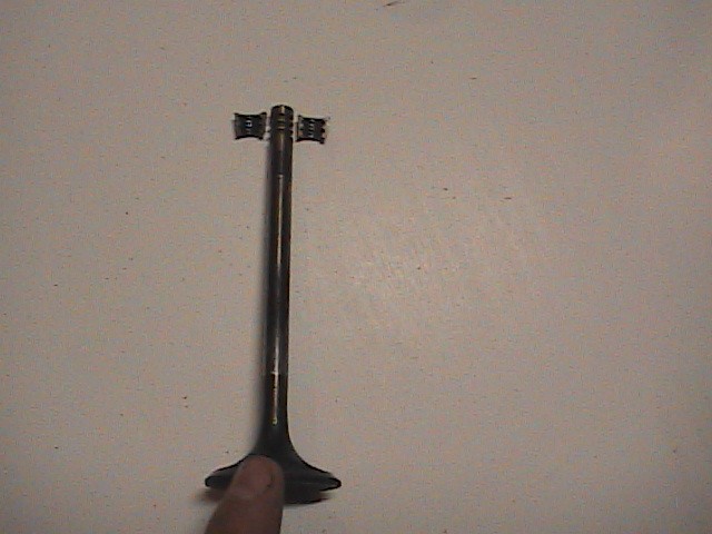

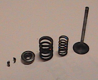

PostPosted: Thu Aug 06, 2009 10:00 pm    Post subject: Reply with quote
here are some pictures of removal of the valve and using the spring compressor on a spare head. The inner spring and short jaws on the compressor make it a three handed job. longer jaws would make this easier.

PostPosted: Fri Aug 07, 2009 9:19 am    Post subject: Reply with quote
The classic lever thing mory is describing works great on aircooleds, and maybe on a 1.9, but on a 2.1 the water pump inlet pipe left side prevents use of that tool, no room to swing the lever. By the way, Rocky Jennings is manufacturing that tool nowadays, and does a nice job on it. He sent me one to try out but I couldn't do the job with it on my 2.1 so I slammed this together. Works a treat (hands-free!):
Wanna rent it?
Curious whether the head with the busted spring is OEM or AMC?

PostPosted: Fri Aug 07, 2009 1:19 pm    Post subject: Spring removal and install Reply with quote
That tool in the photos is what you need.Heres a little something extra for you.Once your ready to install the keeper,dab a little grease on the grooves on the valve stem.It ll hold it there for you so you can get the second keeper half on.
