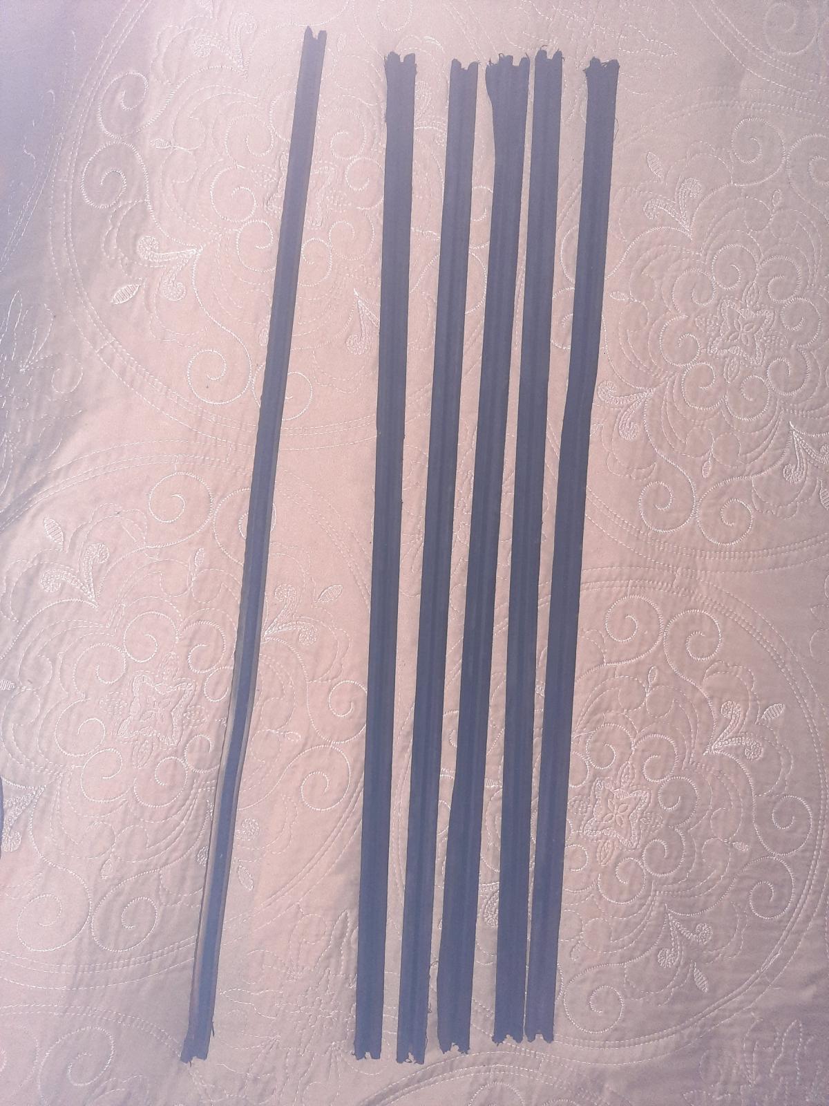

i have these original bug U channels , one of em someone has tried to cover it with black velvet , maybe not a bad idea ???? what was originaly on these and what do folks do make em usable and not scratch the glass today .... Mika has new ones , what do folks do to those ???
the upper inner sides have a channel for rubber is that rubber available today ? what do i need to do to make em usable ???
the straight pieces may be NOS , velvet glued over metal U channel , look like it was profesionaly done but ages ago .

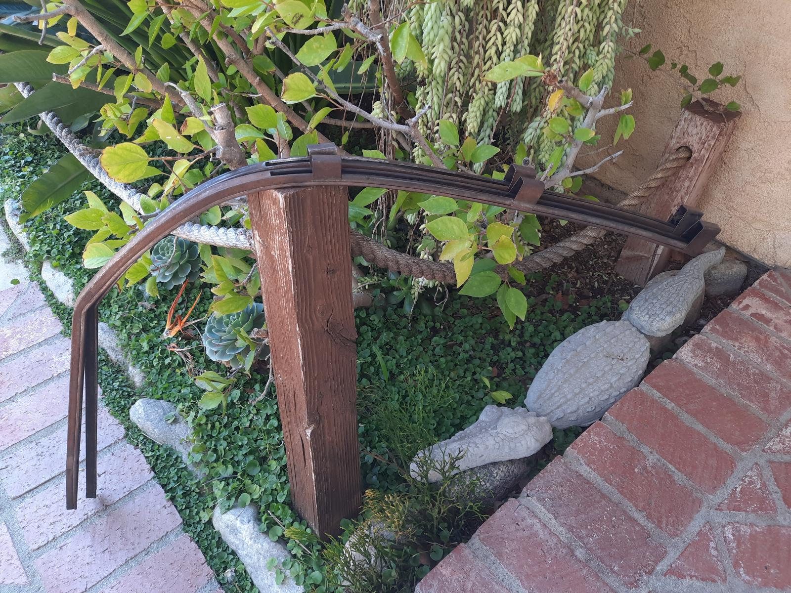

PostPosted: Mon Mar 11, 2024 2:16 pm    Post subject: Re: Split beetle window U channel Reply with quote
i stripped em down , used paint stripper first . one had numerous layers of glue and paint .. one was pretty easy to get the rubber out the other was a real BEAR !!! all the rubber was rock hard old n glued in .... had to use a torch to soften things up and pic at the rubber , came out in 6 inch chunks , then a lot of wire brushing n cleaning to get em to this point .......
all i can see is kafer nostagia that has the replacment rubber for these ? its a rubber n felt kit ????? for 100 clams !!!
https://www.thesamba.com/vw/classifieds/detail.php?id=404232
just squirted it with some black paint .
