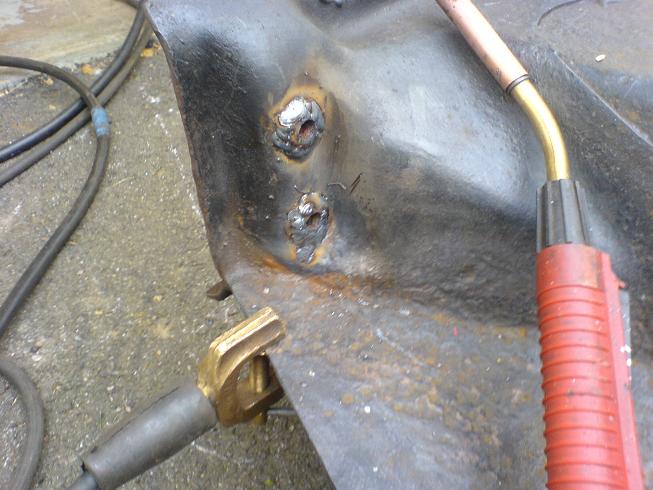

What to do with frame head bolts that has been cut (way back) and now are siezed. Welded nuts on them and tried to use a hammering wrench (?), but it does not help. If drilling out the bolts, how to keep the threads? Or possibility to weld a nut on the rear. Solution need not to be original, for this car I'm not an original freak.

Try drilling out the shank of the bolt, start with a small bit (1/8") and incrementally use a larger bit until you reach nearly the same diameter as the shank (I think it's a 12mm) Then use heat from a torch on the pan head area. Finally use an "E-Z out" tool to extract the remaining bolt shank. You can chase the pan head threads with a tap die to clean it all up

I can't imagine that they can't come out with those welded on nuts. Use plenty of penetrating oil over several days, and head the shank where it enters the heat afterwards, but let it cool before trying to get them out.
Do not use an air impact wrench, but a large breaker bar, and slow torque. See the "Tool Techniques" article at my site thebugshop.org. It takes penetrating oil, torque and heat to win with those. No one thing alone will work...

I'd try welding the nut on there, worst that happens the nut breaks off. Then you just weld 2 nuts on and go at it again. Razz

Follow John Henry's advice. If you have to drill them, you might try drilling from the rear. Who knows if you get luckey, the drill might grab and turn the piece out.
Worst case would be to cut the threaded tube out of the frame head and weld in a new one. Not much of a problem if you use the beam to make sure you get them in the right place.

Do as has been suggested, drill small and keep geting bigger. I then use a Dremel with an 1/8 inch carbide endmill and purposely cut to the one side of the hole until I see threads. Then take a punch and collapse the sides of the bolt inward to loosen it. It will come out without ruining the female threads. Wear eye protection!!

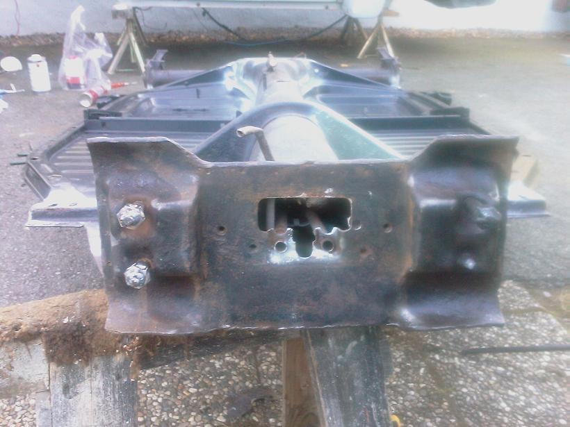

Heat didn't work (at least not before bolts snapped, and bolts were too long in to the tube to be able to weld...
so...
Cut them out and replaced by ones from another frame head...

Looks good. Did you bolt up a front beam before welding the new ones in to make sure the position was correct?

That would have helped keep the splatter out of the threads to.

thought of it, but had no bolts at hand. Was a rather tight fit and I think the bolts are not what aligns the beam so I hope it is ok. We'll see... Smile
