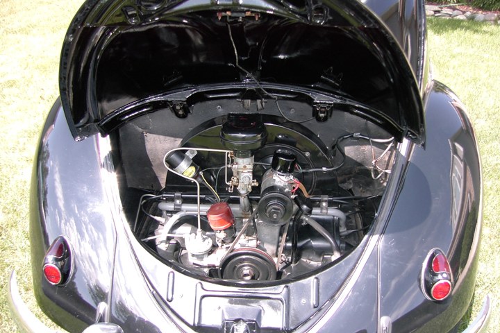

I've had 20-30 of them converted over the years and never had an issue. My only problem was when Jack retired and I couldn't get them any more. Most cars including my own have at least an AM/FM radio, H-4 headlights and maybe an occasional gas heater.
I still have a converted one on my '60 that must be 25 years old or more and I have an orignal '65 Porsche unit on my '53 split window. I use a late regulator turned sideways in the stock location held down by the ground screw if anyone was wondering.
Thanks for the contact info !
Here's my '53 split with the stealth 12v 356 unit. I have a round regulator cover mounted to the square flange at the bottom of a square regulator.
