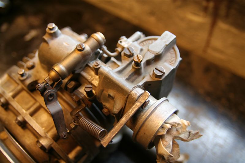

The compressor is slightly used, but in very very good condition. Nice T-intake with pressure-valve device and intake and a Zenith 30mm side draft carburetor.

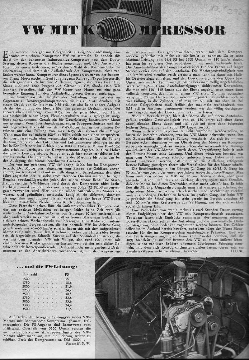

This fantastic article from 1951 describes what is possibly a prototype VW-kit...fantastic set up - awesome Split decklid:

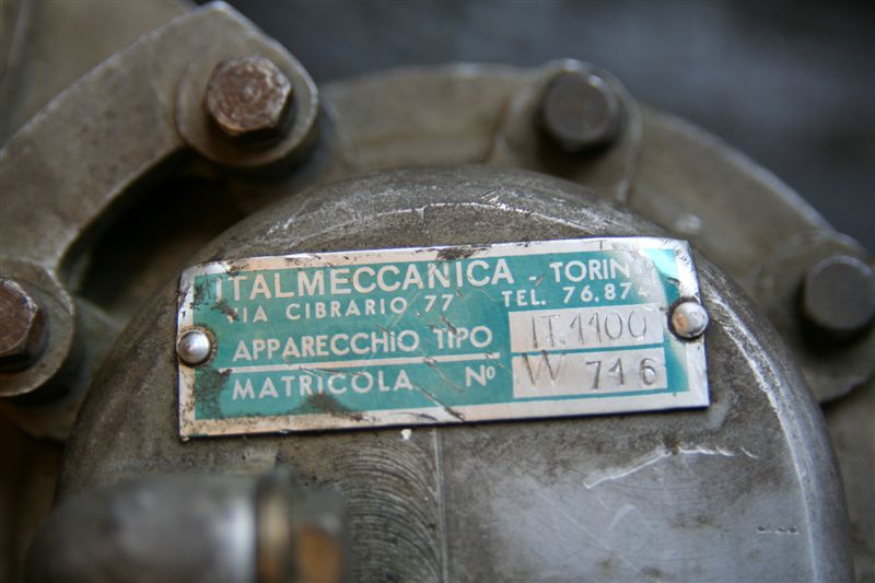

The tag on the unit - anybody know details?:
Sweet carburetor set up, but it will not fit under a Beetle engine lid without a cutout..

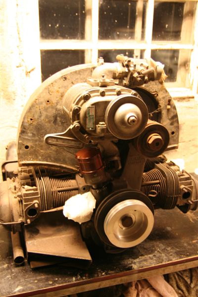

I had to mock up an engine to see how this would fit... Very delicately made, very sweet fitment.

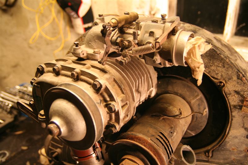

It sits right up against the fan housing, and needs a extra pulley bolted on to the back of the original - like the Judson, but just a single one. The belt tensioner wheel is missing, but the bracket is there. It also needs brackets / tubes / supports to hold the unit to the engine block - this will have to be fabricated. The magzine article above gives an indication of how it was.
The two "end-elbows" of the intake is also missing - but is most likely in steel and can be fabricated.
Very sweet fit of the over-pressure valve and how it clears the dynamo and the regulator.
Two indications it was only 25HP: The belt pulley is the wide, 13,5mm belt as original on the 25HP - and there is no way a 30HP style distributor cap will fit under there...but the flat top fits perfectly.
