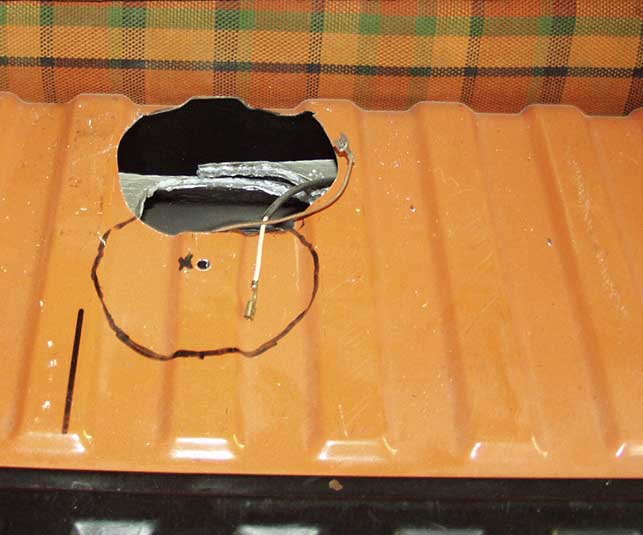

if we were to drill the hole we use a 3.5" hole saw. makes a perfect hole, no sparks. usually we replace the sender without removing anything except the cover for the tank. getting the sender in and out blind is not so easy but do-able and it's always good to do a job without taking too many things apart.

When I followed the measurements given on an earlier post from the site I found that either I didn't measure correctly or the dimensions were different for my '74 westy. I found that using the ridges of the floor was a more accurate way for me to find the spot to cut --- 11 high ridges from the passenger side and about 1" from the back of the turn-down behind the rear seat.
Drilled a hole and used a sabre saw with a fine metal blade.
Hope it helps.
